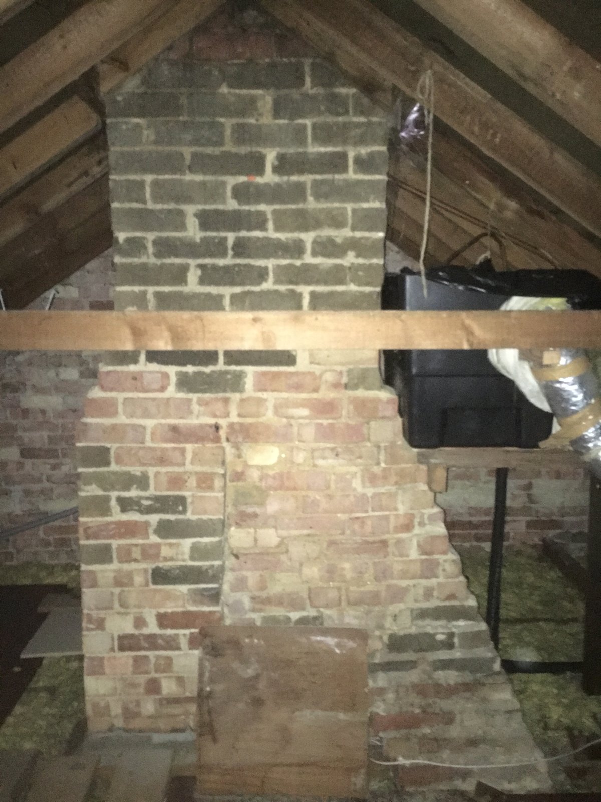

Planning on removing an entire chimney.
Can’t seem to get any clear answer online, some say yes and some say no in regards to building notification and approval.
I know if only part of the chimney stack is removed it requires building notification and approval so that they can ensure the remaining portion is correctly and adequately structurally supported.
But when removing entire chimney from roof to floor level I am finding conflicting information, and in one post I saw somebody was told initially yes by building control then they changed their mind and said no... so I’m unsure.

If you are infilling the floor or ceiling where the chimney breast was, it will be structural work and so would need approval.
As others say, structural alterations require building regulations approval, and as you are doing other work covered by bldg. regs are you going to apply for approval by submitting an application ?
You definitely need someone competent to check the structural implications- chimney breasts also serve to buttress the wall they're attached to. SE would be favourite, they have liability cover (unlike BCOs)
BCO's aren't meant to do the design on building work, a structural engineer is obviously the person to use for advice on structural alterations and prepare structural calculations as necessary. An architect or architectural technician is the person to use for advice on other building regulations related matters.

It isn’t serving as a buttress as chimney isn’t against a wall
Can’t really tell from the photo but around the back is a 1.5m gap or thereabouts.
but will be sure to consult them and ask about notifying it.
It’s a bungalow.

Ah well that's a whole different kettle of fish. Only issue you're really facing is how much of the roof load and maybe ceiling loads are being carried by that stack- won't be a lot but will be more than nothing. SE job but not a massive one, should be in the £300-£400 mark. Have fun

Thanks will contact one, looking at it this afternoon, the roof load doesn’t appear to be carried too much by it but only an SE can I guess determine that or to what extent.
It’s a cut roof, and where the chimney goes through they have cut the rafters and bridged across them like is done when installing roof windows.
So hopefully not too much to alter structurally but at least I have a better idea now, so will need to get a structural engineer then add it to the list of notices lol.
Even better- I was assuming the ridge beam was bedded into the stack (couldn't see it in the pic)

If it say width of kitchen is around 1.5 wide it wouldn’t be far off and from what I can see as above it doesn’t appear to involve much structure.
Was mentioned about ridge beam being embedded in it, it doesn’t appear to be but could be wrong, seems to be similar to how you cut out trusses to install roof windows like velux, with a section cut out and the trusses braced across between them.
But will get a structural engineer to check it out.
