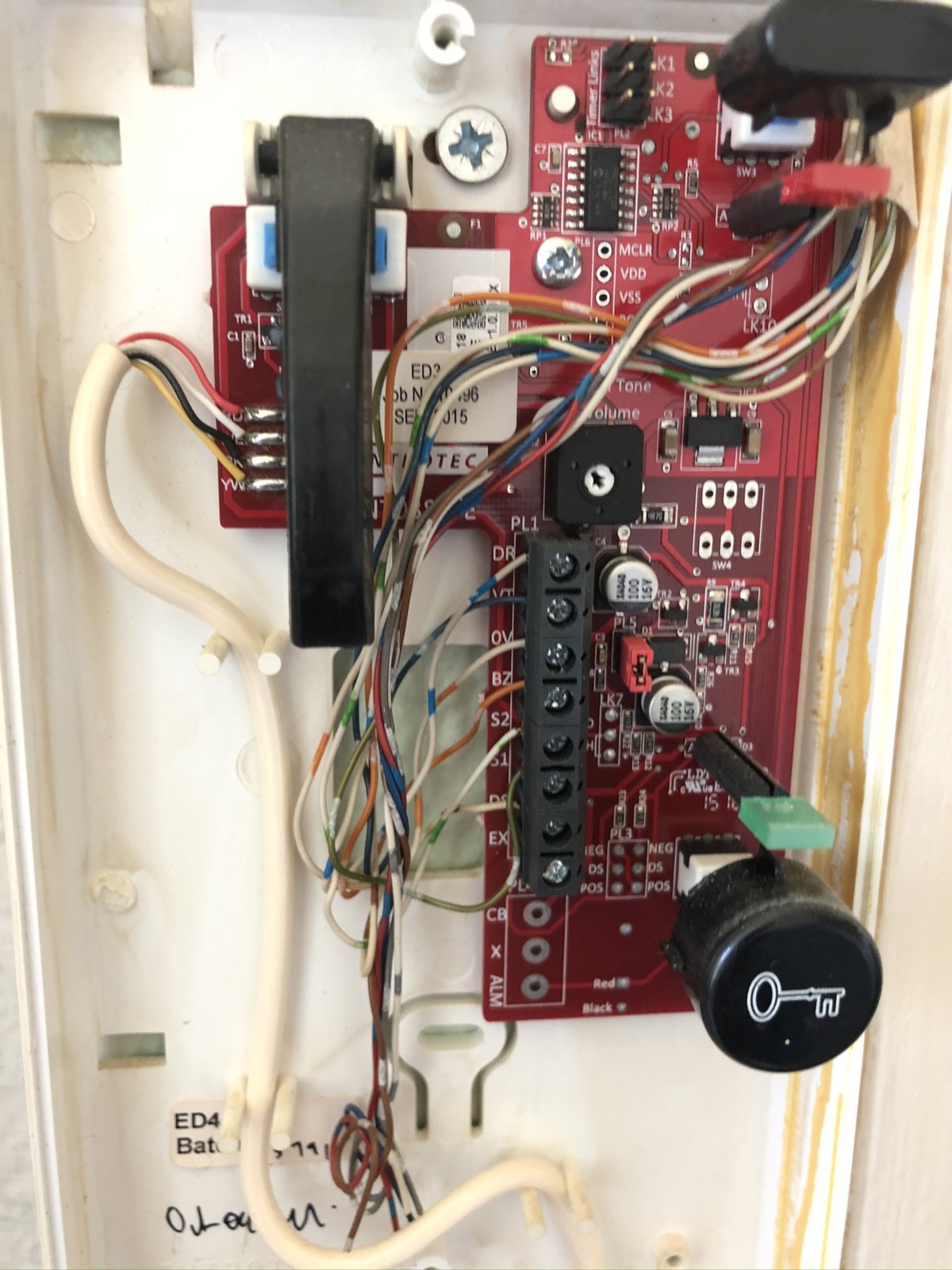

  • Took it apart carefully and re-soldered the speaker wires - when putting the old handset back and re-connecting the wires in the same order, it would not power up - we tested and could still hear each other through the intercom, but it would not ring or buzz the door open.

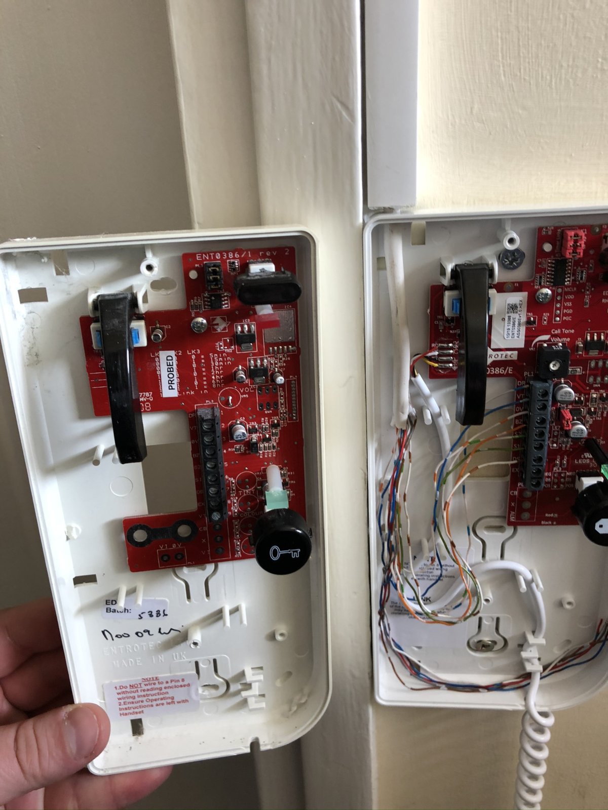

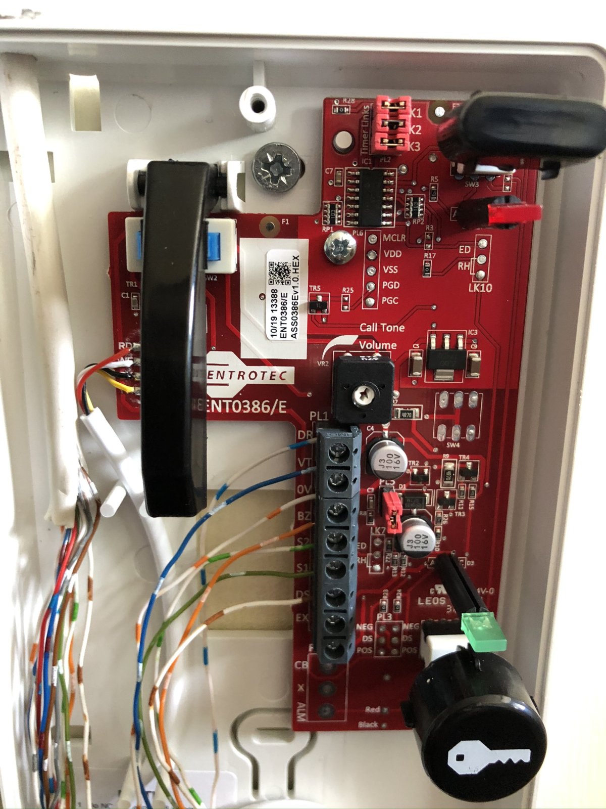

  • Ordered brand new Entrotec ED4 unit - arrived yesterday. Wired everything up as shown in the pic attached, just as it was in the old unit (New handset.jpeg). No joy. Not ringing when called. If I know my wife is calling and I lift the handset we can hear each other fine. Cannot open door with button. Privacy button LED not lighting up.
  • Visited next door neighbour who has the same system. Took a picture of the inside - attached (Neighbour.jpeg). Wiring is the same as mine. Made sure the PL5 and LK 1,2,3 pins were tested in all possible configurations - still the same issue.
  • For reference, attaching a picture of our old Entrotec and the new one side by side. New is right, old is left.

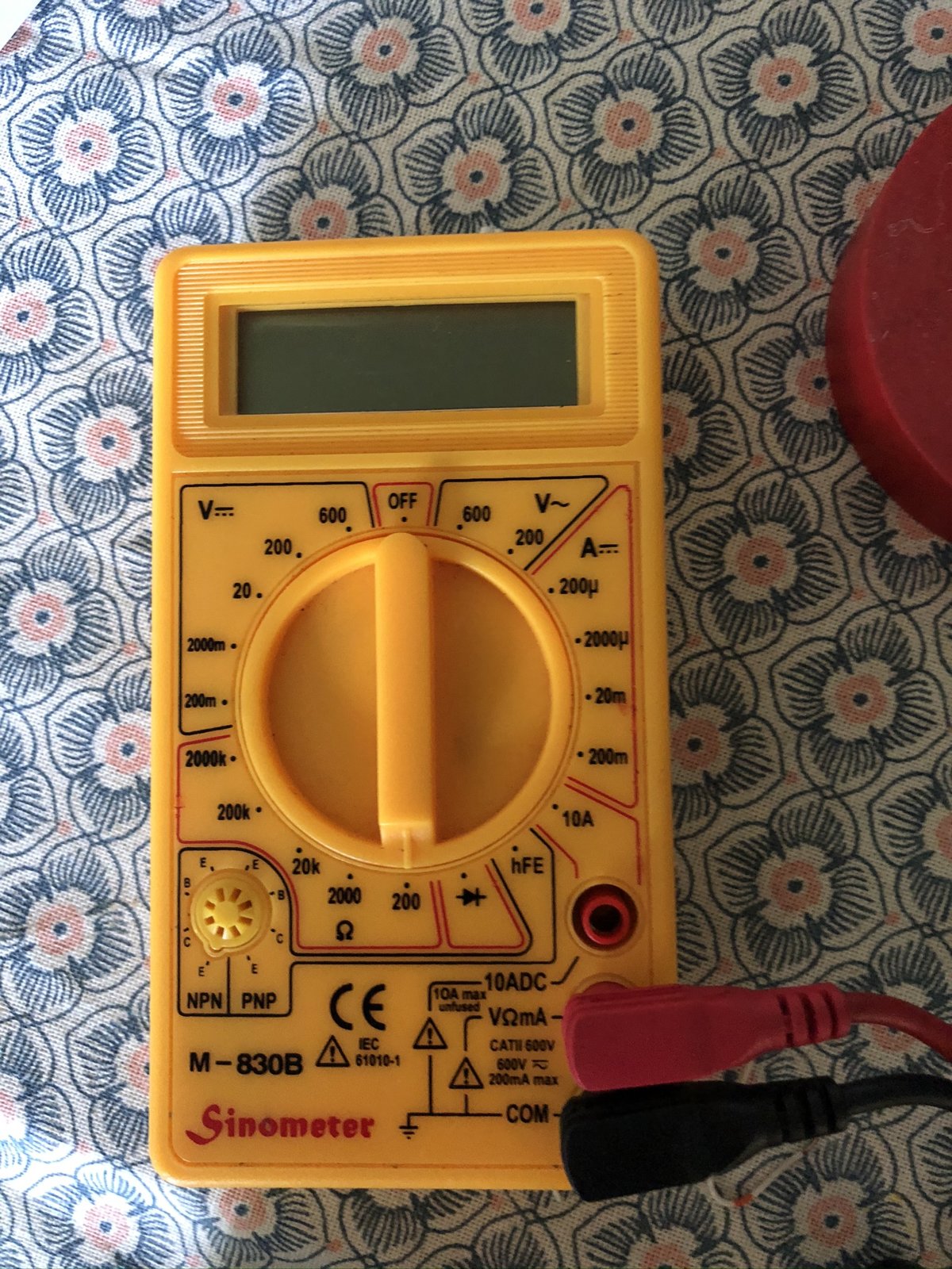

  • I have a multi-meter - picture attached below (Multimeter.jpeg), but don't have the skills to know how to check for power delivery, would appreciate some guidance on how to do it.

Hi, with the positive voltmeter lead on VT and the negative on 0V, at V-20 range the result is 0.74.

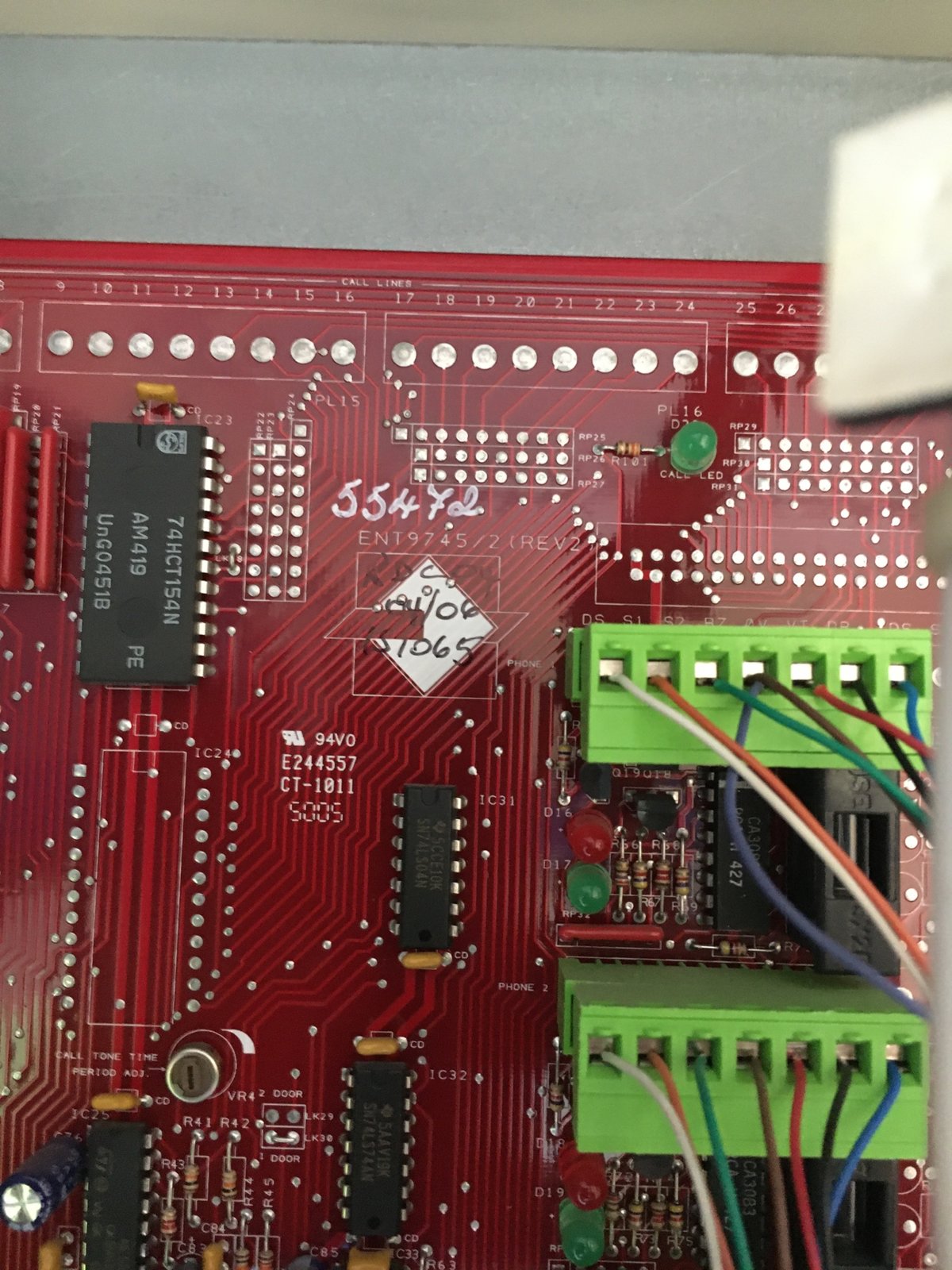

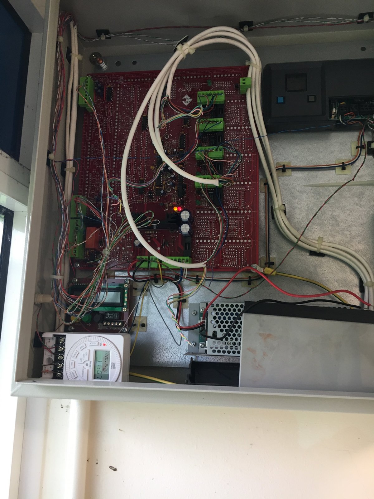

So ....more than likely the fuse is blown in the controller ( large grey box ) depending on the age of the system it may look like this inside ....A63E78DE-396E-4F68-9714-3753902E3A5B.jpegF04D0242-1206-4B38-B652-6E4B8D5150AD.jpeg
I see, thank you!! So the fuse is the black plastic one perpendicular to the right of the green connector? Could you tell me what kind of fuse it is please? I might find one on Amazon. Now to locate this controller box and hopefully my flat is marked!!
500ma fast blow
If you can get someone to call your flat while someone is stood at the controller you will see a led come on ....best way to find which one it is
