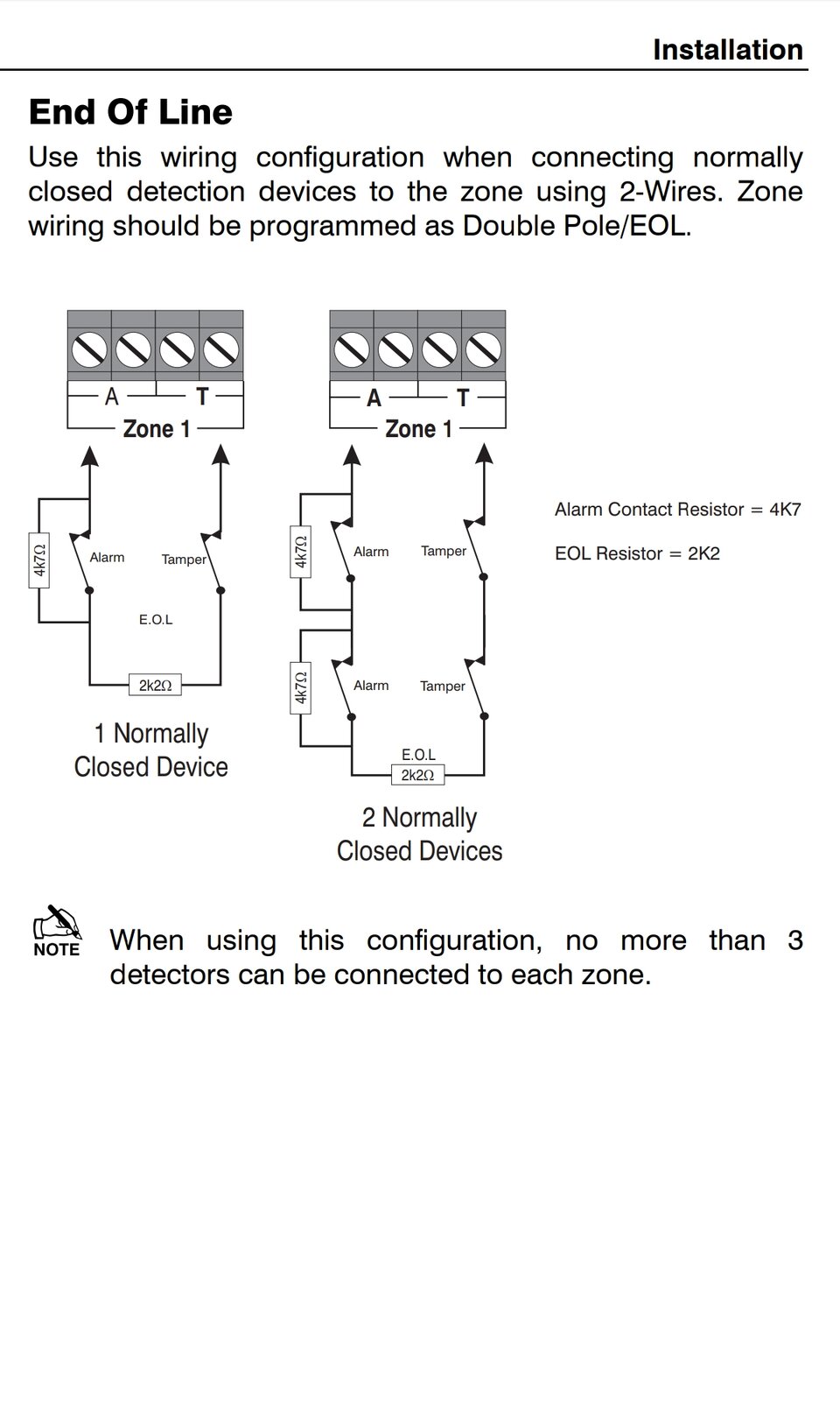

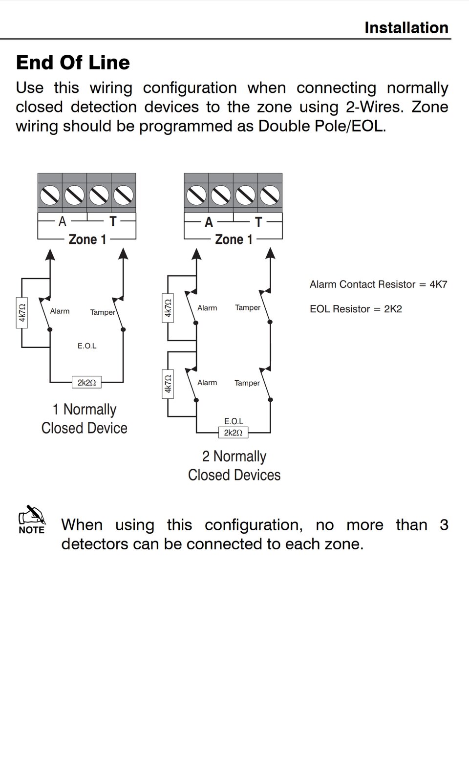

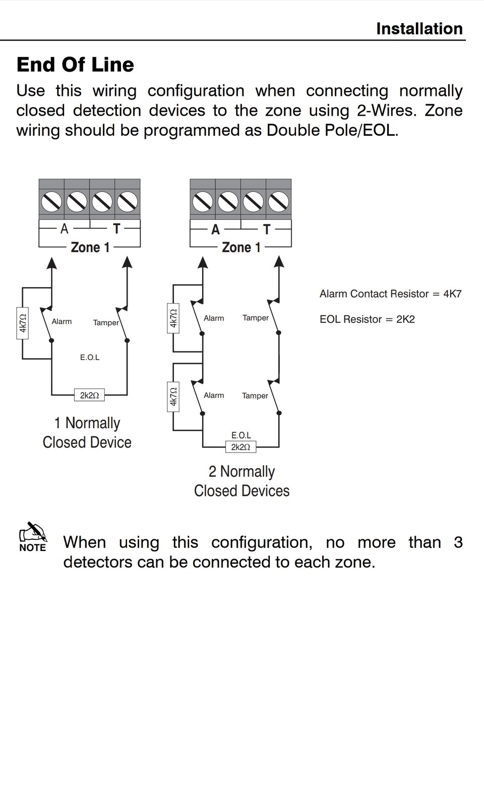

Hi, i was wondering if you could help im changing my sensors and system over at home and some of the zones have multiple sensors on them
So if im using Blue and White for my zone, using EOL wiring with the Capture PIRS, am i right in thinking on the first sensor a Blue in A a Blue in D join the whites together
And then at the last sensor a Blue in A and a white in D?
Would this work?
No
What cable goes from control panel to first pir,then to next pir.
How many pirs share the same cable.
This explains how to wire
The diagram shows the flow of the circuits and where the resistors are in that circuit.
If you take that one pir is 4k7 and 2k2. You would need a 4k7 across the alarm pair on the other PIR.
