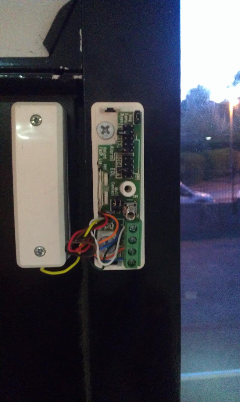

Hi all, still got a few problems with this alarm
:cry: :? .... Everything is connected up now. when i go to set the alarm i get a message saying panic button active and front door active. I think i must be missing something hear. the door contact is a knight yend 74 with resistors. i've attached 2 images one of the door contact and one of the panic button, both just having 4 cables connected. 2 alarm 2 tamper. Any ideas ?
if you go into the engineers settings press [9] this brings up engineers utilities press [yes] press [3] this brings up view zone status press [yes]
type in the zone number of the devices youre having trouble with. (001 for zone one, 034 for zone 34 etc)
It will tell you the status of the zone and also the resistance of the circuit. Let us know what the readings are.
Normally for door contacts and PA buttons you'd just connect 2 wires and they will do both alarm and tamper.
Do you have the wiring diagram supplied with these two devices?
Where in yorkshire are you?
have you altered any of the zone configs for resistor type ? but as RF says you are better looking at the zone status from engineer utils first or twist your alarm pair and tamper pair together and check to see what panel says.
Pull the jumpers off the panic button if your not using the resistors.....(the way you've wired it suggests you aren't using them, put the lid on reset it with the key should now say secure,
cheers for reply guys, The panic button already has had all the jumpers taken off apart from the one on bottom right which says normally closed.
ive just checked the zone status and got as follows
Zone 1 (front door) >65k active
zone 4 (panic button) >65k active
