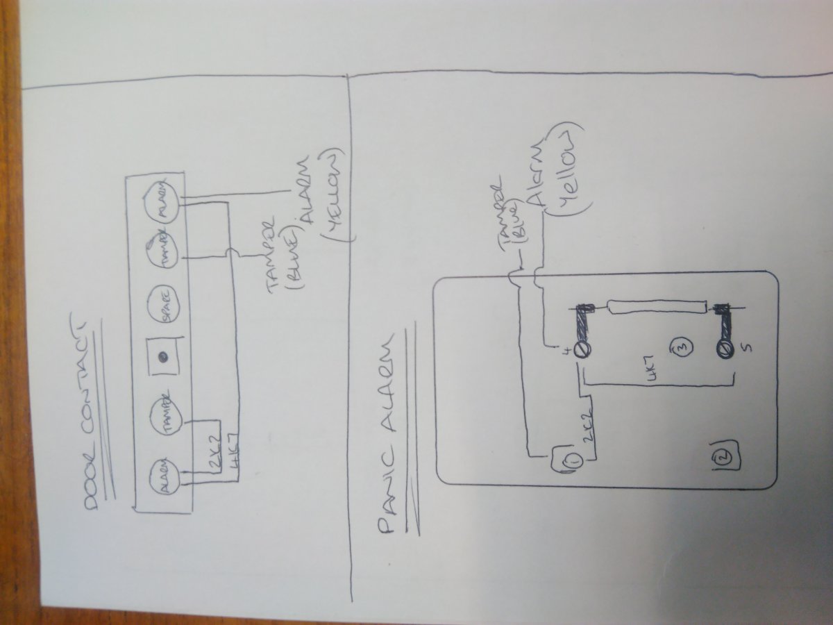

Hello all, I'm after some advice if possible...
Currently installing a Texecom elite 24. EOL wired.
I think I've got the panel sussed for now but the door contacts have got me. I'm hoping what I've done is correct.
If not could someone point me in the right direction.
For clarification..
Alarm- yellow
Tamper- blue
Cheers all.

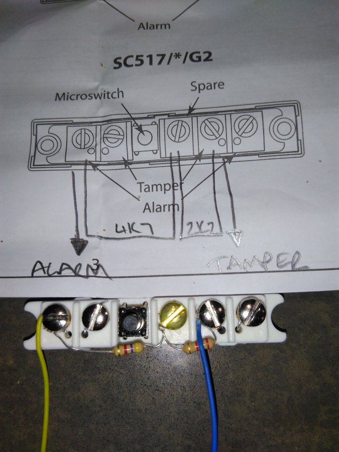

No wrong .... the twisted resistors need to go to one side of the alarm contact , the leg of the 4.7 to the other side of the contact with either the blue or yellow ... the 2.2 goes to one side of the tamper switch and the other wire ( blue or yellow ) to the other side of the tamper switch

Thanks Sparkymarka,
I can see it now! You're right I should've gone with resistors built in, hindsight and all that. Attached a pic with the correct wiring.

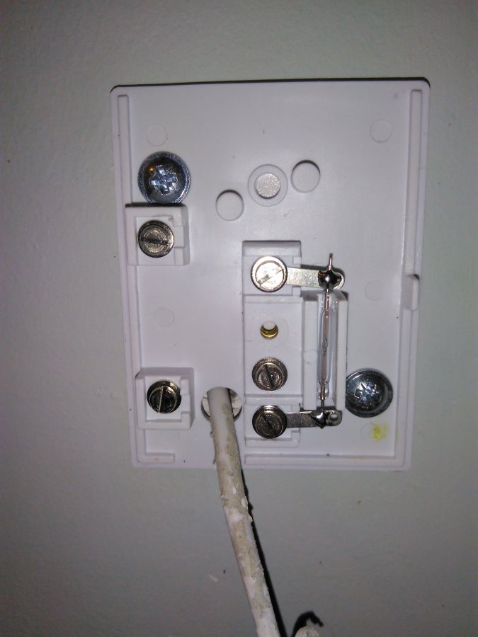

Whilst I've got you here, would you be able to look at the panic alarm I've attached and see if that's correct?

Ah I can see where I've gone wrong with the PA.
The alarm conductor should be connected to the bottom of the glass red switch terminal and not the top.
