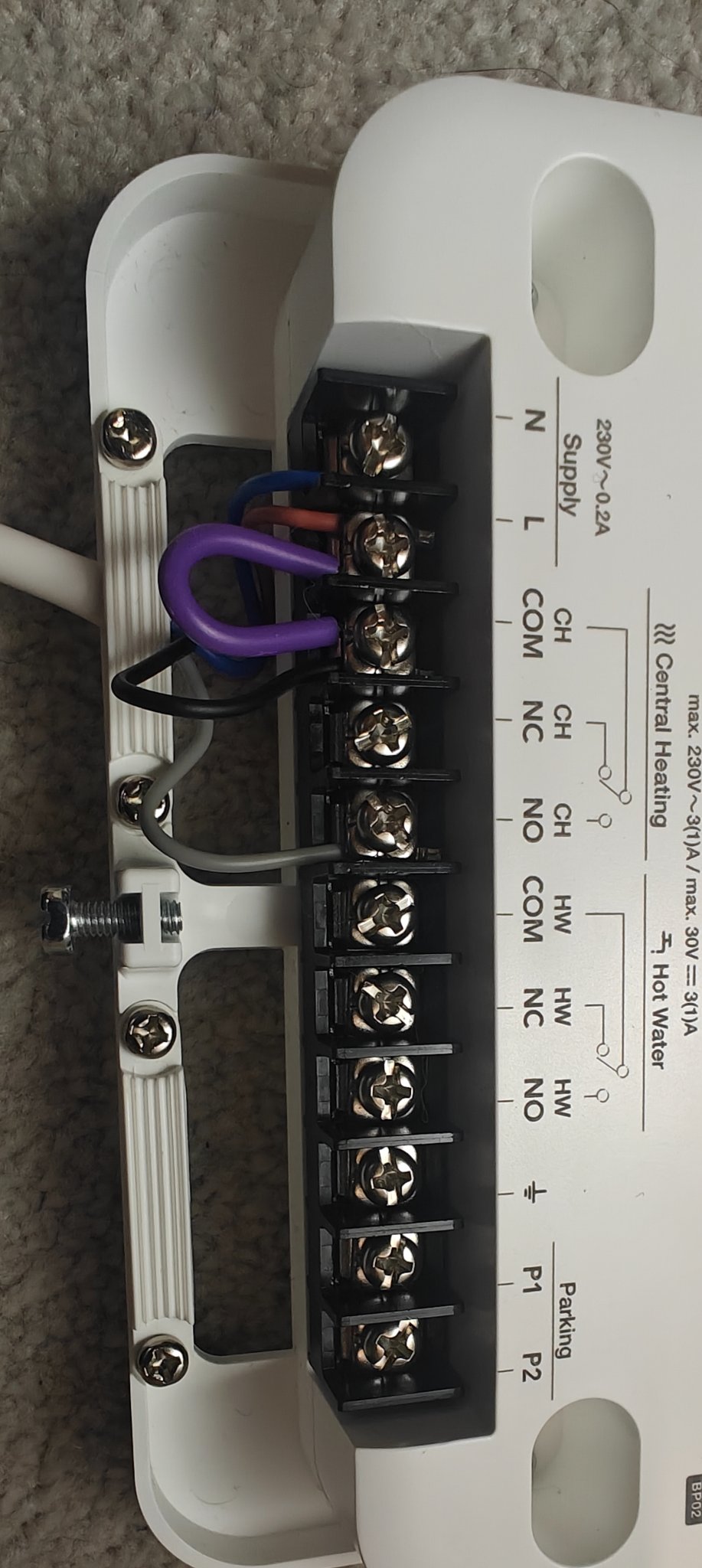

Hi All,
I am currently trying to get Tado V3 Wireless set up on ESI 2 Valve PCB (no hot water). I have followed several threads on here and else where but unable to get it working fully. I have managed to get it into the state in the pictures attached (1st is of the original set up) and can confirm when powered up it calls for heat and hey presto both valves open and the boiler heats the water.
The trouble is the stats didn't call for it and the boiler wont stop, I have tried my best to go through all the threads to see if I had missed anything but cant see my mistake other than buying a house with an ESI set up!
Current wiring
PCB - Receiver
0v - NO
RH - NC
L-L
N-N
Receiver Loop
L-COM
I have tried with the +V wired to NC but that did not change anything.
It has been a very long evening doing this!
Any help would be much appreciated!

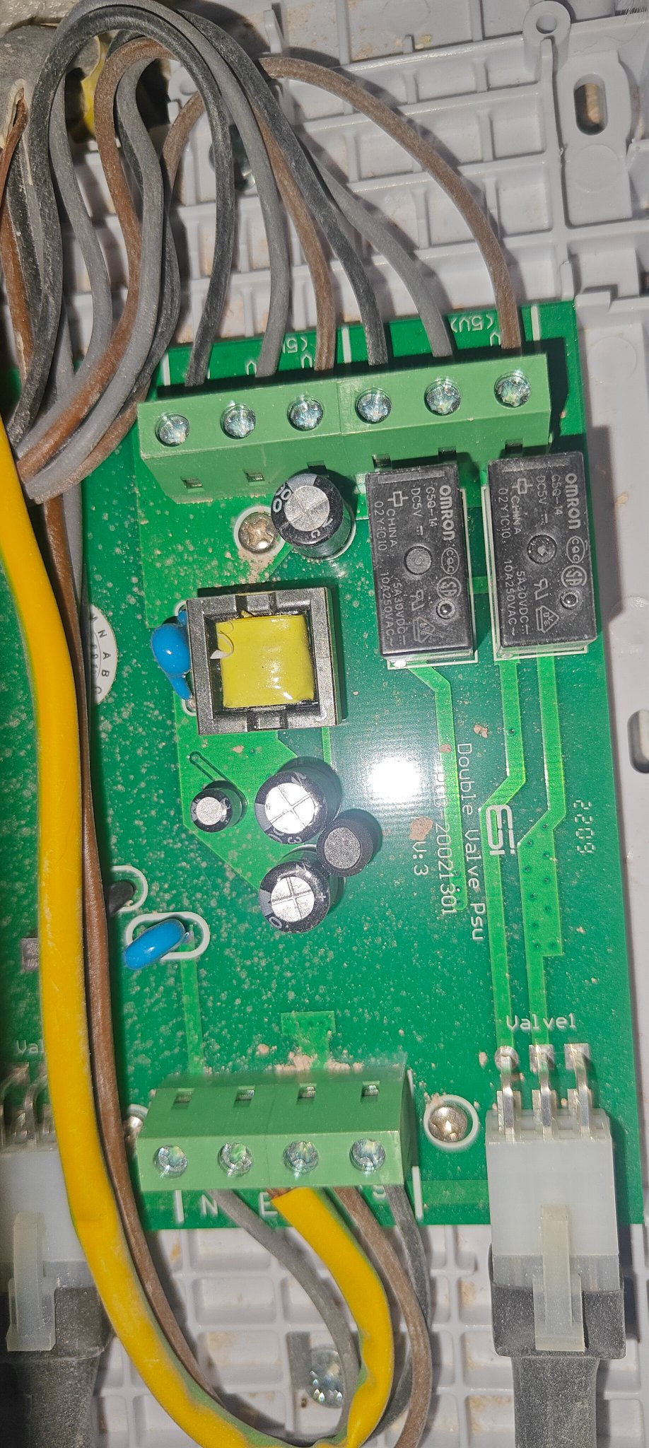

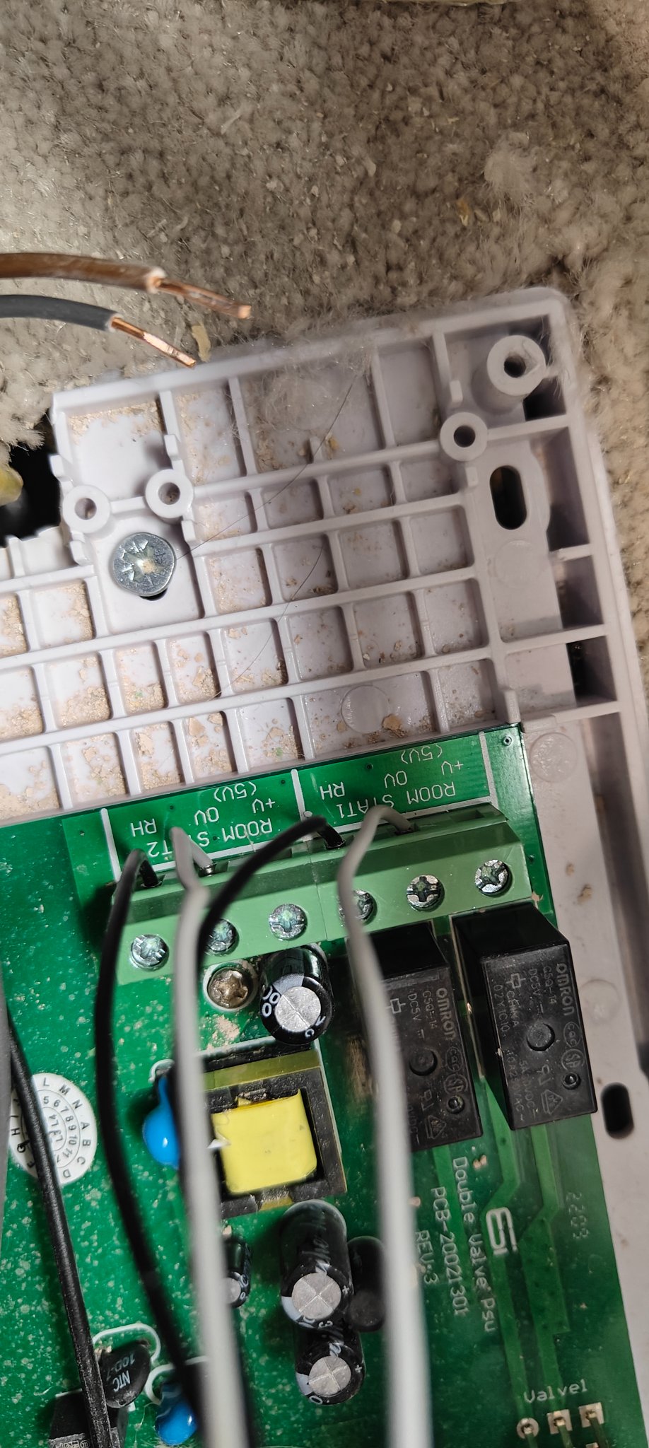

Where does the grey in pick 3 go to, is that split to the greys in pic 2?

Your right, I'm not to sure why I've linked the 230v to the COM on the receiver. I think that was from following another thread and I've forgot to unlink that.

The grey in pic 3 goes to one of the greys in pic two on the 0v, there is two recovers both wired up like pic 3, one for each stat. So this is linking each RH to NO
The browns in pic one are linked to the ESI Wired Stats on the wall into the +V which is only carrying 5V.
The 230v for the receivers is coming from a junction from the boiler supply to the board at the Valve end

Interesting, looking at the MI, it seems like it may be very specific to those specific stats, given they have 3 matching terminals - +V, 0V, RH
The +V and 0V seems to be the 5VDC switching side but not sure what RH would be, maybe something to do with hysteresis for the stats and in effect could be a N but it's not clear and there's nothing in the MI indicating what RH may be. Also, given you have shunted 240V down that RH line I'm not sure what the outcome of that may have been for the controller.

If 240 volts has been applied to terminals that output 5 volts to what would have been 5 volt supply for OT stats, Those capacitors on the PCB will not be happy
Thanks for the advice all, managed to get round to it today and just removing the 230v link managed to get it working fully.
Will monitor in the long run tho for any oddities but right now all working as intended.
