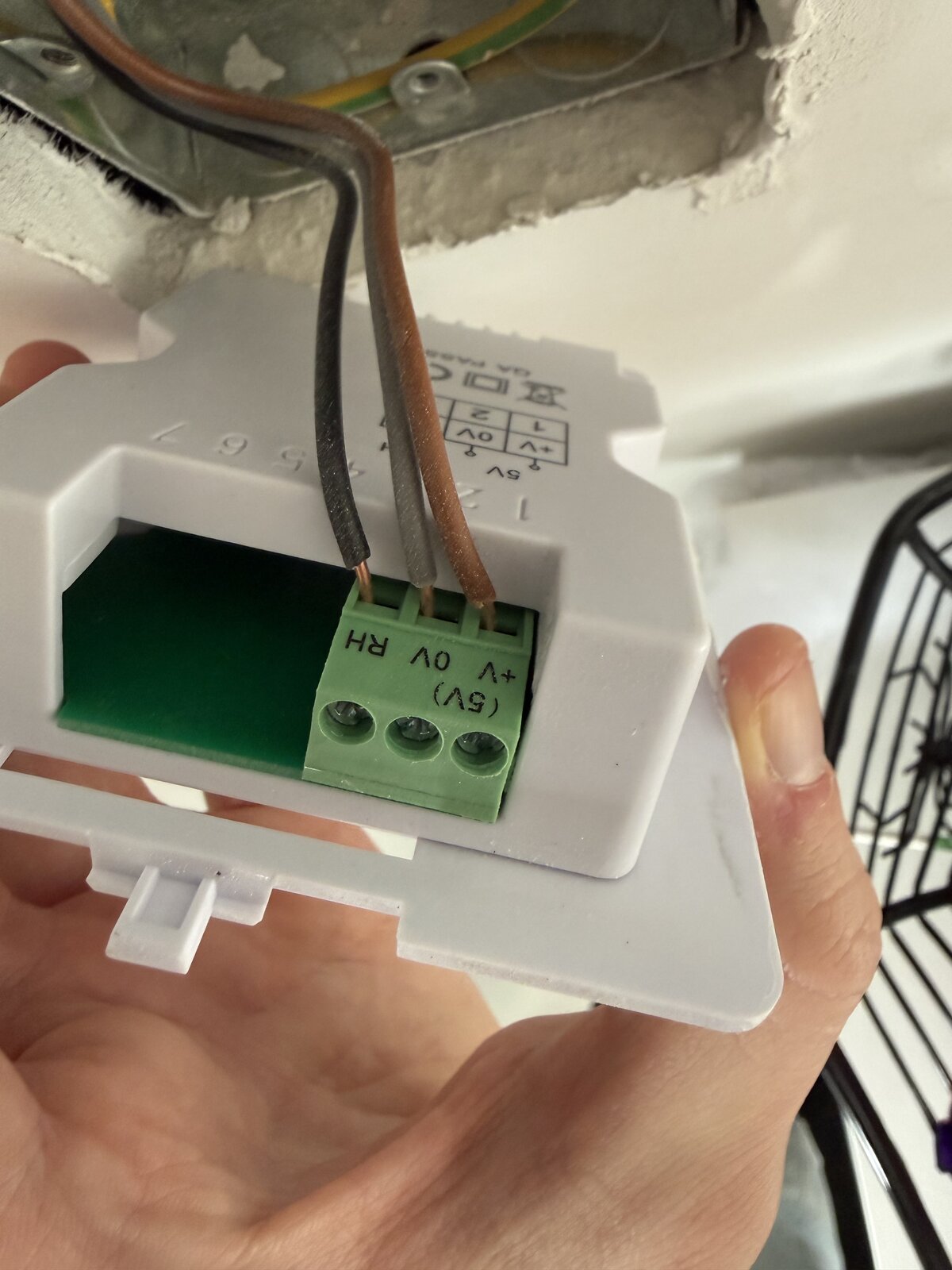

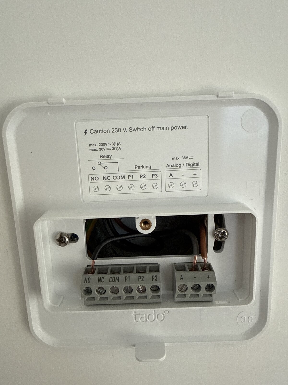

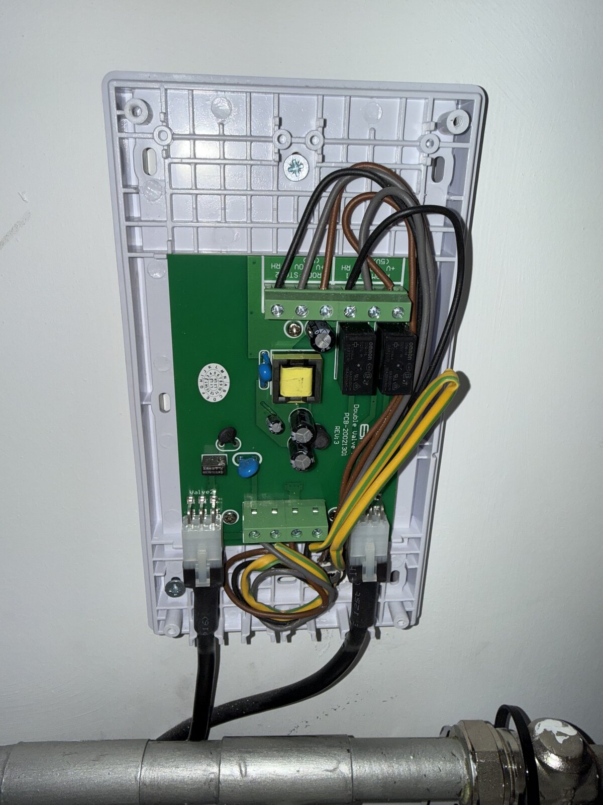

I have gone from an ESI Thermostat and trying to upgrade to v3+. I’ve added photos of the old one and the tado. When I set the heating to on nothing happens. I also have a thermostat upstairs I will need to change as it’s dual zone. Any help appreciated. Thanks

The ESI thermostats use 5V DC, the Tado requires 230V AC.
There is no compatibility between them. If you want to use the Tado then the ESI control PCB will need to be removed, a suitable wiring centre installed in it's place, the plugs on those zone valves cut off and the wiring for them and the new thermostats connected to the appropriate terminals in the wiring centre.
