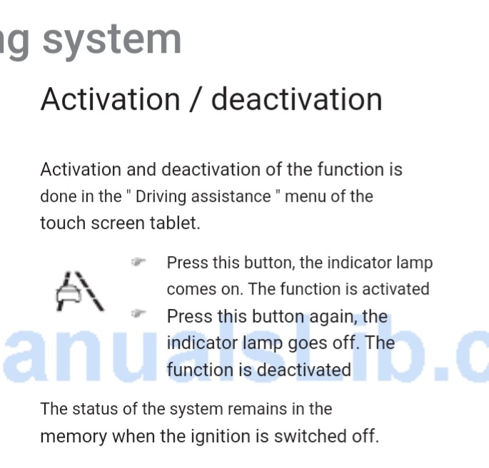

@Burnerman. Got the car back at lunchtime and everything seems ok, runs smoothly, no shakes/bumps etc.
However, there is a warning on the dashboard saying, 'System Deactivated' and a picture of the car between two lane markings. Guy in the garage says it's the lane wander system switched off but he isn't sure how to turn it back on again. His diagnostics box says everything is ok.
Looking on Google/YT my wife can only find instructions to press a button on the fascia, unfortunately, she doesn't have the required button!
Any ideas how to re-activate it or do we need to go to a dealer?
If there isn't a fascia button (my C3 has one), then it will be an option from the touchscreen:
...and glad it's going ok...so far! :)
Thanks RG. Whats that menu title at the top, the one that I can't read the full wording of, as she has looked through the menus and can't find it.
Sorry, the writing cut off at the top is just - Lane Departure Warning System.
And it should hopefully be listed under the "Driving Assistance" menu of the touchscreen.
Yes, we found that one in the manual. Problem is, she doesn't have that button on the dashboard so we are thinking it may be in the touchscreen menu, (somewhere!), but we can't find it. May have to go to a dealer and get them to reset it if we can't figure it out.
