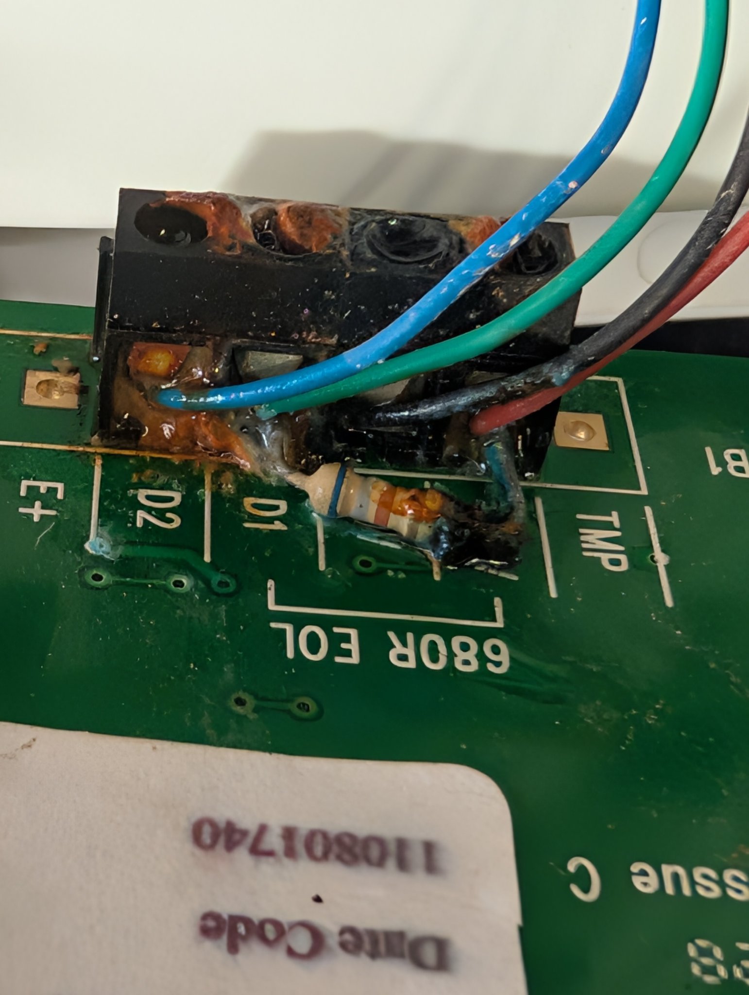

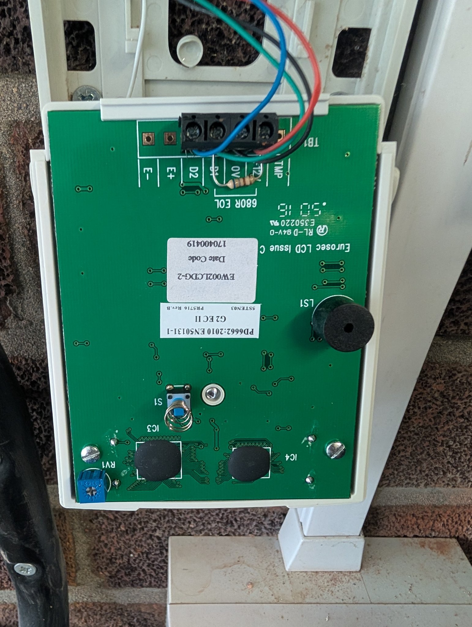

OK, the keypad definitely had water in it. Terminals looked corroded, but board looked OK.
However, through the joys of being a hoarder I remembered that years ago I bought a replacement with the intention of swapping our main unit as one of the buttons was sticky.
So I have replaced the keypad. I've not touched the main unit yet. What order should I do stuff now, to avoid any risk of stuff going off?

Her are the photos of interested.
After and before
