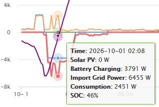

Very true, we tend to just consider our own homes, looking at my own 1791451722890.pngI already use 4.4 kW overnight at cheap rate, add 7 kW to that and looking at 50 amps, so getting close to the mark, here I peaked to 1791452013005.png6.4 kW so add 7 to that and at 58 amps, that's getting close to the mark. I call them the big three, washing machine, tumbler drier, and dishwasher, all three have a delay timer, so can set before going to bed to run when we have off-peak, summer we don't worry so much, but still we get 12p/kWh for export and pay 8.625p/kWh for off-peak import, so better exporting during the day and importing overnight. Winter we run out of battery, so can pay 32.277p/kWh using the items during the day.

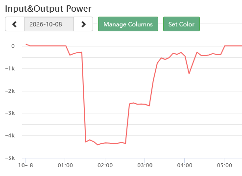

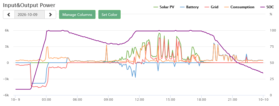

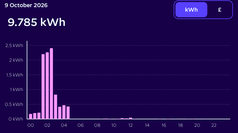

1791802789409.pngThis from the smart meter, or this 1791802880282.png from the solar software will give you a far better idea of electric use to what any electrician can tell you, unless he puts in a data logger, which is really doing the same thing.
In my case 1791803205368.png I am already using 4.5 kW during the off-peak, to charge my batteries, If the tumble drier, washing machine, and dishwasher also run at the same time, scrolling back, I can see nights where the use was higher 1791803472863.pnghere using 6.455 kW, and for 60 amps 13.8 kW is the limit. A short overload will not blow the fuse, it does take time, but as seen with my house, charging batteries takes time.
One would not want to charge an EV using standard rate, so the smart meter is really a must, so what we need to see is your smart meter readings, but as I have done, make sure the MPAN number does not show on here.
