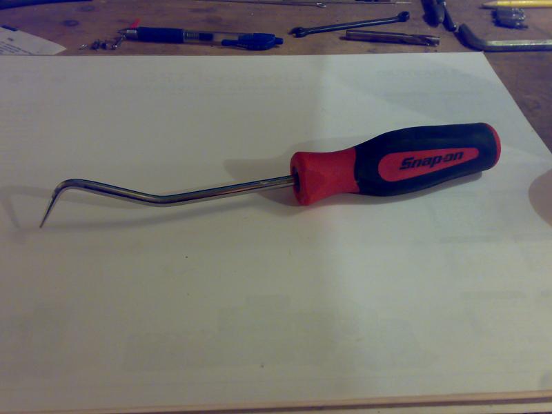

A professional electrician installed these connection units in the undersink cupboard in my downstairs cloakroom. [They isolate the handwash and the light+fan, and the switch shuts off the fan.]
It looked a neat job when it was done, 3 years ago - but can you spot the problem?
They are fastened to the inside of the cupboard, so if it needs to be removed for, say, some plumbing work they will need to be disconnected.

You can't prise the fuse out on the SFCU.
No probs ;)
ricicle is right - and I don't recognise Mr Tinker's implement and wonder if it would work in the limited space.
Monkeh may have "any number of ways to get that out" but a layman shouldn't have to have specialist knowledge in order
to take out a fuse?
I'm thinking of replacing the SFCU (and the FCU below it) with MK units which have horizontal fuse holders held by screws.
By the way, the shelf does come out (if you take the doors off)
I don't think there is a requirement that the fuse must be removed using an average length screwdriver though, is there?
Something short could be used to remove the fuse.
