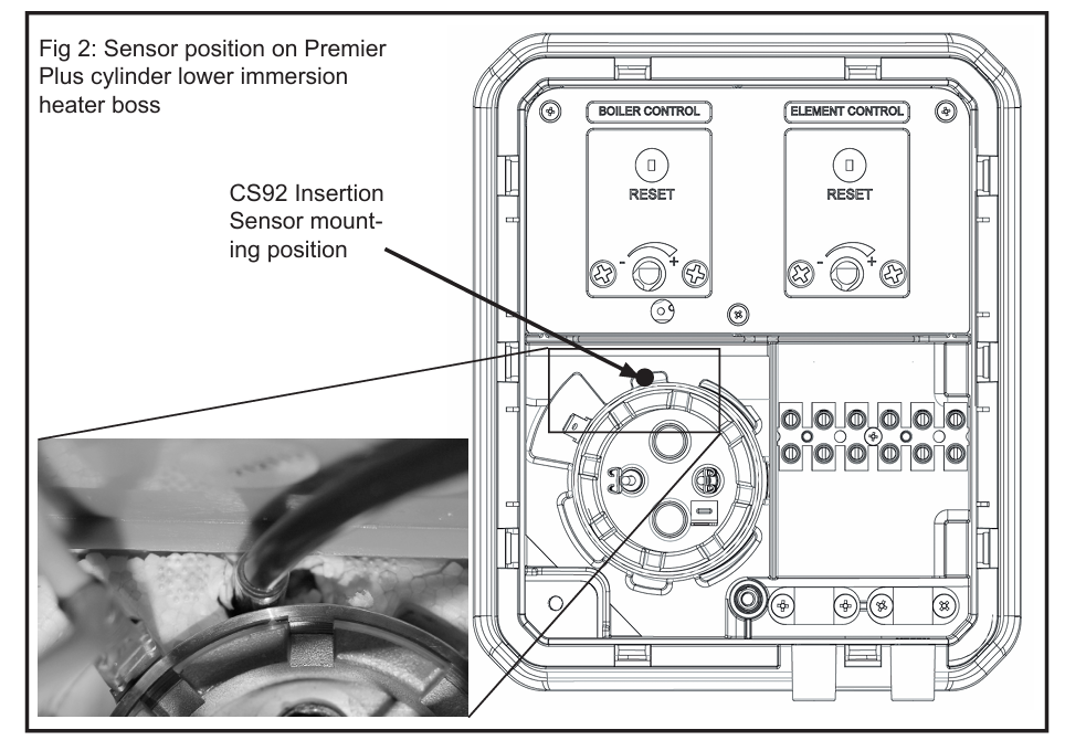

The kit appears to come with a insertion sensor, but i have no idea how you would install this on the unvented cylinder - Santon Premier Plus in my case?
The cylinder is fully encased plastic, and there isnt any obvious slot to attached the sensor.
Anyone have direct experience in the installation of such sensor for the Santon?

A suitable pocket can be made in the cylinder insulation using the immersion heater access panel.

Just also got some feedback from Resido (Honeywell). They told me the same, by accessing the immersion heater panel.
They mentioned that the insertion sensor should wedged in between the moulded insulation foam ensuring that the sensor contacts the stainless steel immersion heater boss outer surface.
Does that sound about right? - however, just not entirely sure how secure that approach would be...

Yes that's correct with the sensor
