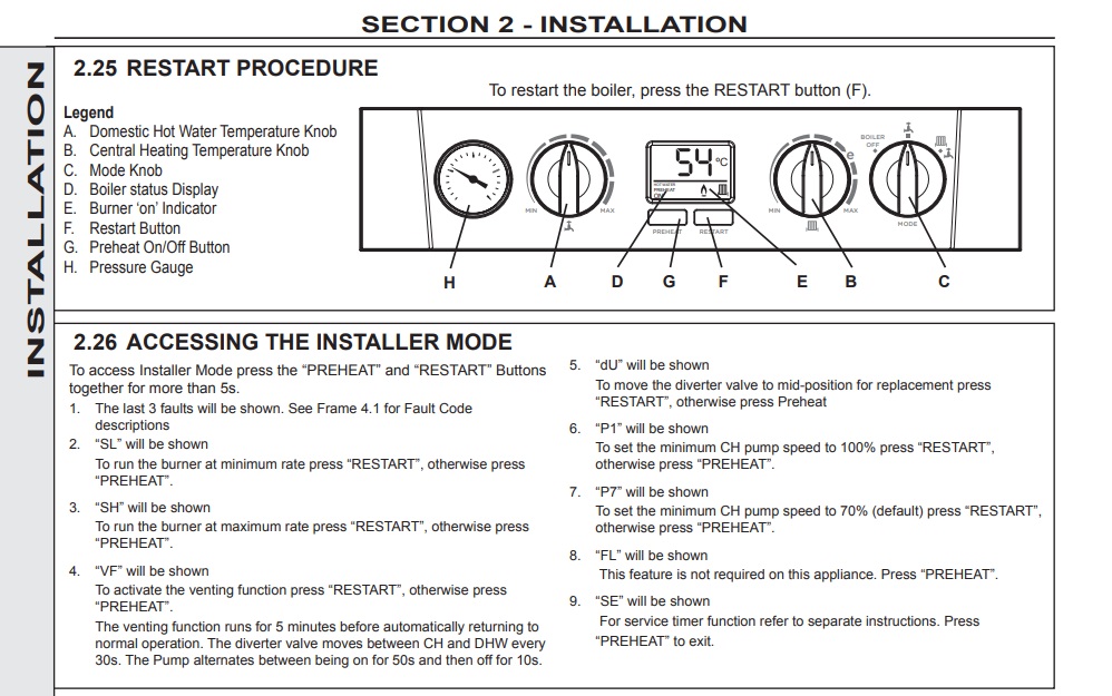

Apols. I think the original link from karlbbb was to the Logic Max. I thought it was a bit weird for Persimmon to use the Max version! Here is the manual for the standard Logic, but this manual is from 2019.
EDIT: It looks like there have been a couple of Logic models over the years. But this is the one called C35, so it looks right. If it works the same as this one, you can set the pump speed to 100% on page 38 in the section "Accessing the Installer Mode".
EDIT 2: In a Youtube review in 2017, it looks just the same.

I would certainly increase the pump speed to 100% after first taking a few readings while cycling at its default setting of 70%, you may finally settle for some intermediate setting.
EDIT 2: In a Youtube review in 2017, it looks just the same. View attachment 283644
Ah thanks for that - I had indeed read that section but clearly hadn't twigged the pump setting was a permanent one; I'd falsely equated it with the other "tests".
Any potential downsides to running the CH pump at 100% all the time, other than increased wear and increased electricity use?

If I've read the manual section screenshotted above, it looks like I only have a choice of 70% or 100%, with no middle ground available.

I definitely think you should wait for a reply from somebody who knows this stuff. I'm pretty sure it's a 7m head pump, which I think means it's pretty powerful when run at 100%. It says 15-70 on it, and I've seen it referred to elsewhere as a 7m pump. By default, on your boiler, it runs at a variable speed between 70% & 100%.
