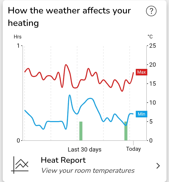

However, I don't know. Summer now, so can't really test until winter, but when running we would look at the app. 1749560079422.png The report will clearly not work without the router running, so there is no way to really know what has gone on during a power cut. All but wife's bedroom not firing boiler should one would hope still work. But if it fails, by then it's a bit too late.

Been there done that. A storm took out the local EE mast, and my heating thought I was not home, so turned heating to Eco mode, since then the geo-fencing option has been turned off.
The problem was Nest Gen 3 also has a PIR sensor in the wall thermostat, so each time I approached it, the heating would be turned up, had it said 17ºC I would have known something wrong, but it said set to 20ºC but only getting to 17ºC and I thought my boiler was simply not big enough with the bad weather.

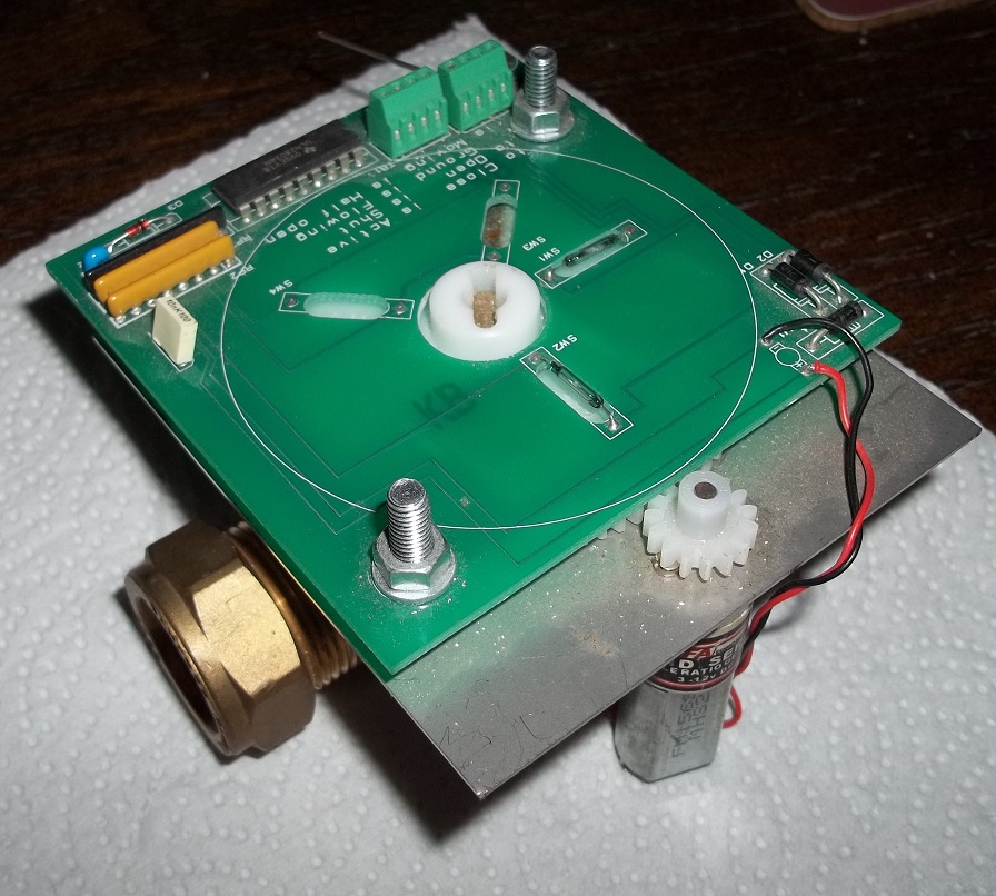

My heat only boiler and the pump are the only items that depend on there being a 230 Volt 50 Hz supply. In a power cut an invertor supplied from a 12 volt battery can power the boiler if the heating is required. All the valves are 12 Volt DC motorised valves which along with the control circuitry can be powered by a battery,
Sure, but as I wrote, if one has an inverter that can do that,it could surely also run a router?
I would have thought that is unusual. Although my experience is limited, I've never personally seen CH motorised valves that weren't 230V AC ones.
