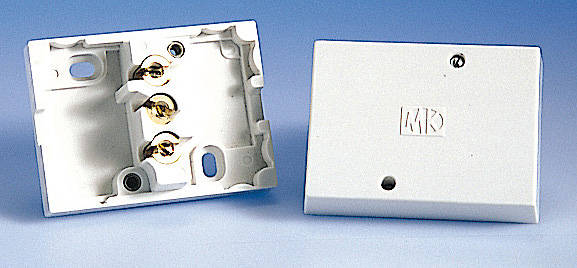

IEE Wiring regulations state that connections other than compression (ie, crimps) should be accessible......blar blar......I've used JB's under the floor (within reason) and I see no real problems (my opinion) as long as the connections are good.......

It can be done, but you can use one these to hide them !
images
:D

Therefore can I extend the ring with crimps which will be plastered into the wall ? Will I need to cover the crimps with insulation tape due to the moisture of the plaster ?
Best to make these accessible too. Sink a box in the wall, crimp the connections and fit a blank plate - that way they are easily accessible in the event of a fault.
