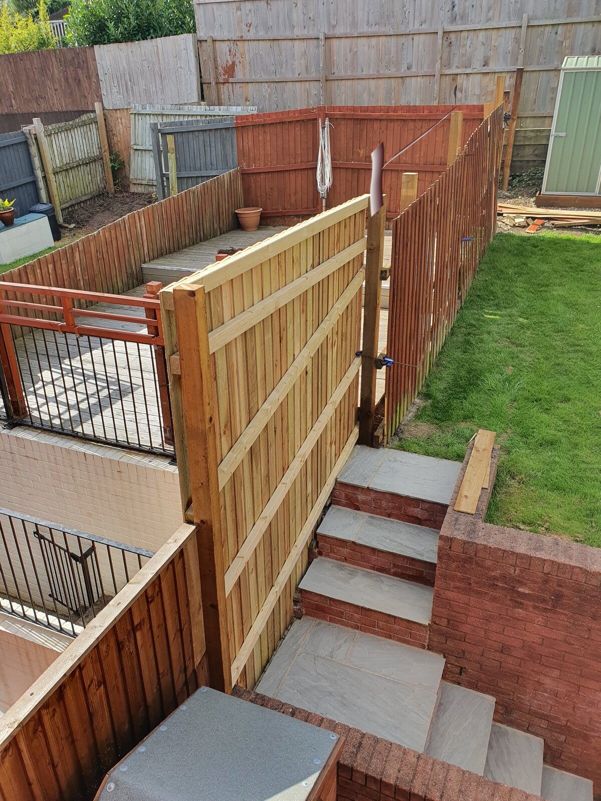

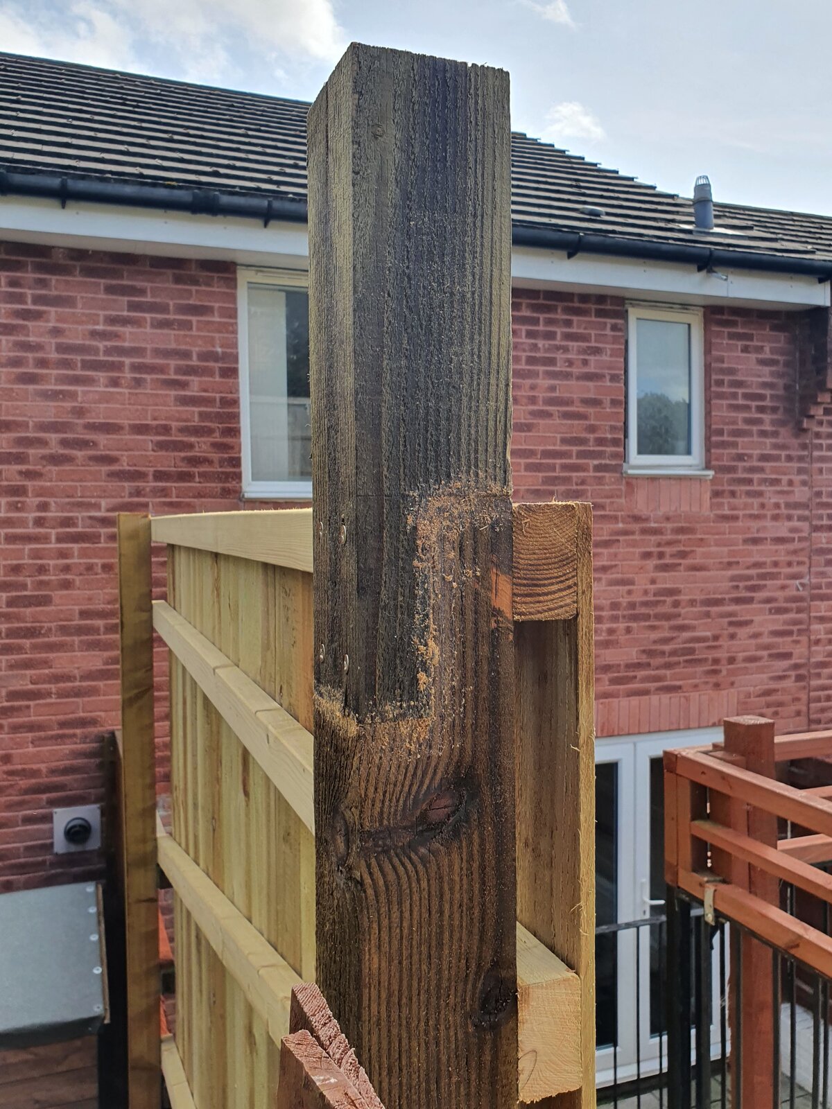

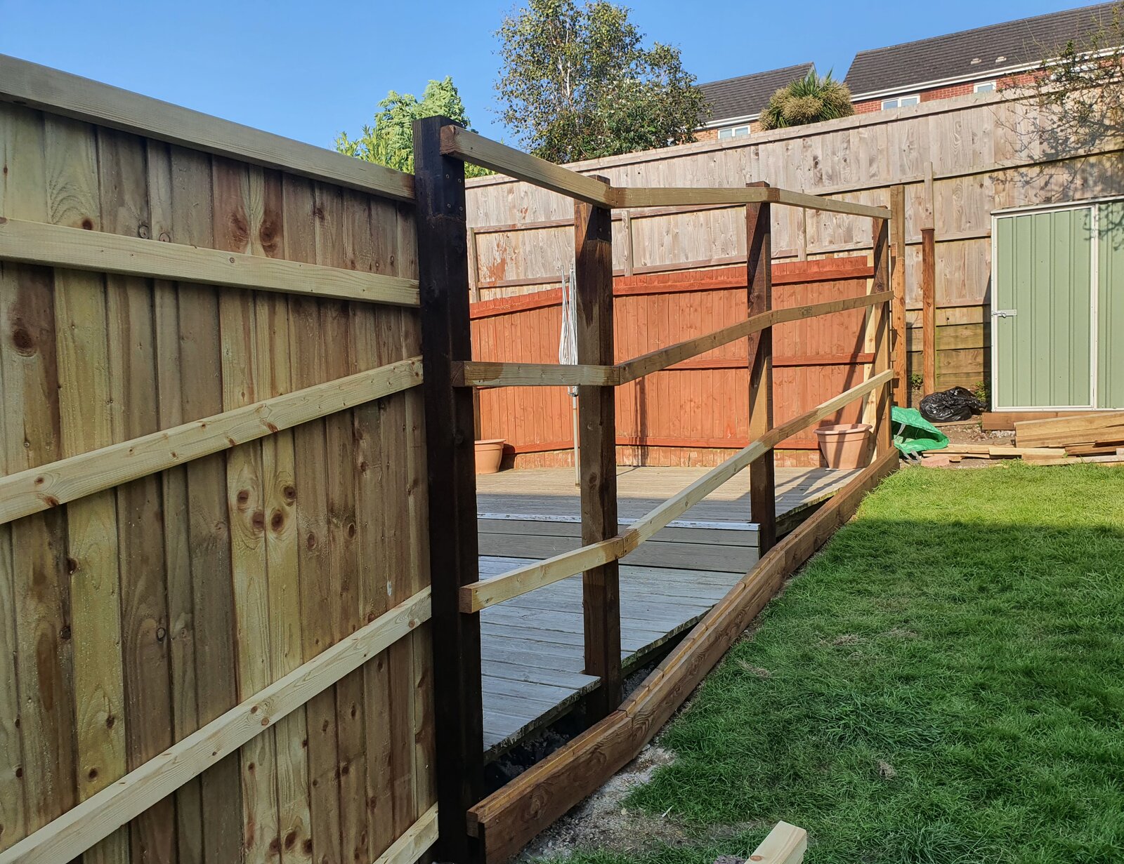

In the attached photos I've replaced a section of fence. The new post on the end of that section that will start the run of new fence needs extending as well as next one. I've bought a new 7ft post and cut off 15" each end so that the perfectly flat end joins top of posts. I can then hang rails.
I'm looking for a galvanised nail plate. Possibly 100mm × 150 or 200mm.
Can anybody recommend one? Or suggest alternative? I'm not keen on extender that fits over each end as that's normally for a broken post or if you're after a really rigid fix. Also it would stand out too much.
Look forward to any help. Thanks.

Thanks for your response.
Yes I realise that. That's 6ft 6"
Next door has decking so they've raised their level from a sloping garden. So wouldn't it be right that the height of the fence could be 2m from the level of their decking? Otherwise if it was from the bottom of my sloped lawn they'd be able to look over.
Also those plates from Toolstation, how come they aren't flat? What fasteners would you recommend? Thanks again
its 2m each panel from the highest post from the ground each panel needs stepping down or up so at least one end coplies with 2m from ground level

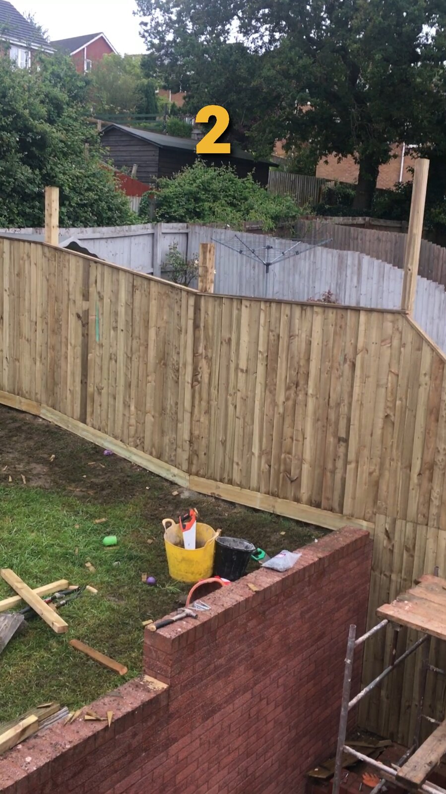

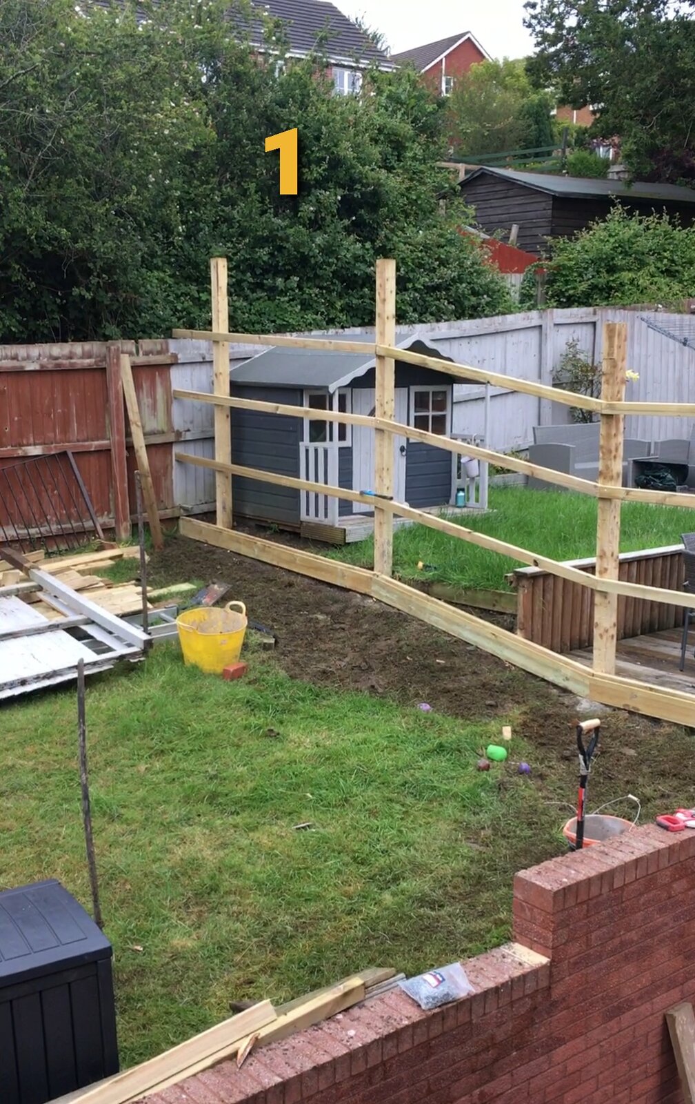

Just attached a photo which was installed last summer by contactor.
He followed slope line. Must have put in 12ft posts then cut them down.
75 inches from bottom of gravel board to top of feathered edged boards.
Cut the boards to 69 inches so 6" gravel board.
Consistent all the way down baring in mind they too had decking. Photo attached prior to boards being fitted.
Do you think I should remove the posts and install 10ft posts then I'll get the 6ft minimum from top of posts to level of their decking or for the extra 6 inches height fit the nailed plates as posted above from Toolstation?

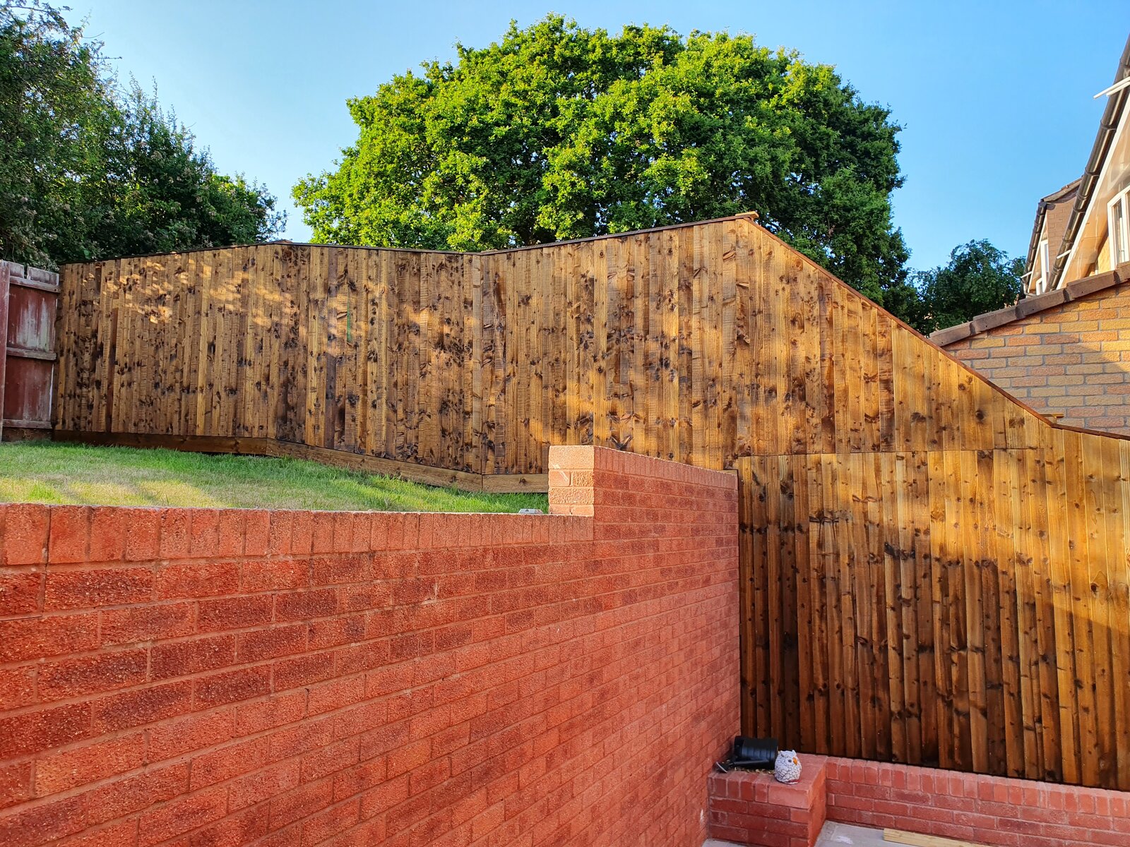

So you would be happy with the post's height and just install the 6" gravel boards with boards cut to say 72 inches (as boards I've got are 2.4m) so it's not over 2m. So follow the slope at 78 inches from bottom of gravel board to top of boards all the way to top of garden regardless if the decking next door gives them height advantage?
Finished. But didn't really have help from this site.
