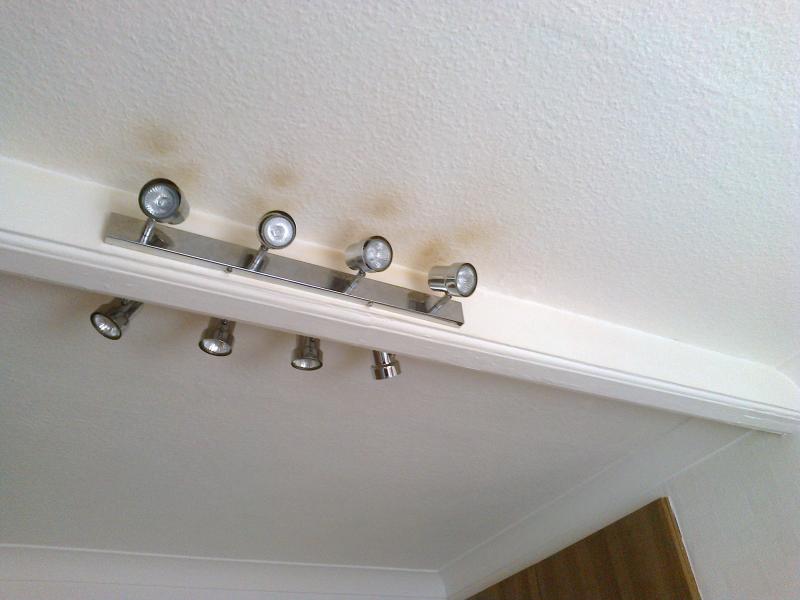

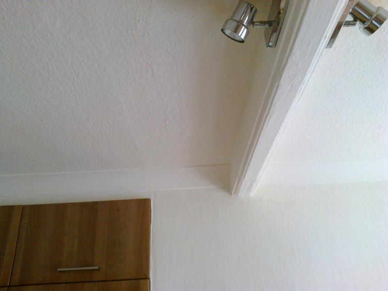

I couldn't put downlighters into my kitchen ceiling due to lack of access and other problems and we have a beam running across the middle of the ceiling as well - next best thing was to install spotlights on either side of the beam but this of course required the cable to the lights to be extended.
The guy doing the work used a thing that looked like a ceiling rose - I think it might have been this to join the extra wire we needed
http://www.diy.com/departments/marbo-5a-4-terminal-white-junction-box/189648_BQ.prd
Is this the right thing to have used?
Now I'm finding that the spotlights (which are mounted sideways on the beam) are burning the ceiling - so, other than setting the kitchen on fire, do I get them moved onto the ceiling or would putting 35W GU10's sort that (it's currently 50W in them)?

No it wasn't. (Disclaimer - I am assuming that you want the room lit, not just spots in it).
As long as it's accessible it's OK.
Your "electrician" should never have installed them there.
Almost certainly not.
My kitchen lighting has been the bane of my life
Best solved, surely, by installing lighting designed to light it up, not lighting designed to not do that?

What other option is there - I didn't know what other option there was - hence the two x 4 spotlight lights - it does light the entire room up but boy, it gets hot in there?
No, it's not accessible - it's been tucked into the ceiling and plastered over - we have no access above as I have an upstairs neighbour

There is nothing wrong with a spot light correctly installed but so often people try to copy and miss of the essential bits.
Having a spot light aimed at a white area will give a spread of light but it has to be aimed at a white area. In my bedroom I have spots on the wall above the bed as reading lights. If I aim these at the white ceiling instead of dark bedspread they really light the room but on the dark bedspread they are useless.
Using LED will remove the burning problem but rules are rules a luminaire shall
be kept at an adequate distance from combustible materials. Unless otherwise recommended by the manufacturer, a small spotlight or projector shall be installed at the following minimum distance from combustible materials up to 100W 0.5 meters.
It does not matter if 2W or 50W the rule does not change. In real life clearly the LED does remove the problem but also some one in the future could change it back to tungsten.
529.3 Provision shall be made for safe and adequate access to all parts of a wiring system which may require maintenance.
The type of junction box you show has screw connections which in theroy require maintenance there are specials which have spring terminals and are classed as maintenance free. I am sure there are many junction boxes like you show which are not accessible fitted before the rule was made.
However in the view of two basic rules being broken clearly the guy who wired it up was not an electrician. Or at least not one trained to work in domestic homes.
If it was my own daughters house I would simply swap to LED and not worry. However if I was asked to do it outside my close family then I would have to follow the rules even if I thought it was safe.
Using LED will remove the burning problem but rules are rules a luminaire shall be kept at an adequate distance from combustible materials. Unless otherwise recommended by the manufacturer, a small spotlight or projector shall be installed at the following minimum distance from combustible materials up to 100W 0.5 meters.
That is surely talking about the minimum distance in front of the light - i.e. one should not 'point' a spotlight or projector at combustible material less than 500mm away (which, I imagine, no-one would normally contemplate doing, anyway!)?

Thanks all. The spotlights do work well - the kitchen is white with white worktops so there are no dark spots but given the fact that I've got 2 sets of 4 50W spotlights going, it gets pretty damned hot in there - plus there's the burning of the ceiling.

BAS - the ceiling height is 255cm. The beam is 16cm deep. I did consider putting in a false ceiling to effectively get rid of the beam, but it's not feasible as the beam is lower than the top of both the window and the fridge/larder unit.
Hi, change your lamps to led, that will solve the burning !
Some of the discolouration on the ceiling may also be caused by kitchen fumes and fug being drawn into the lights and then carried up and deposited on the ceiling. Again, swopping the lamps for lower wattage LED ones will help.

I'm in Scotland though and I don't believe there are regulations to having to have a qualified spark do the work - they guy was doing a lot of work for me and said that he'd do the lights as well.
Nor in England, but a proper electrician would (should) have known where it was OK to install lights like that.
