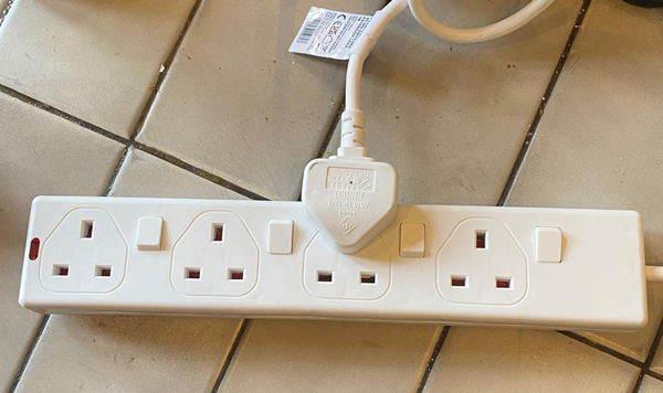

Hi there,
I've just bought a 4-way extension lead ("PELB1751") branded "Pro-Elec", which is seemingly a trading name of Farnell. It bears a BS1363 marking.

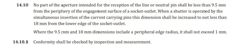

Maybe it's just me, but I can't really make much sense of 14.10 of BS1363, which says:
I can understand that, in the case of shutters opened by simultaneous insertion of L & N pins, the 18mm minimum will prevent a compliant plug being inserted 'upside down' (with L & N reversed and E not connected).
However, traditionally (and probably still most) shutters are opened by insertion of the earth pin - which is certainly the case with the :PELB1751 I have just purchased and, unless I'm missing it, BS7671 does not impose any minimum distance from earth pin receptacle to the edge of the socket. That being the case, it is possible (per photo below) to insert just the earth pin (whose 'receptacle' is only about 16mm from edge of socket), opening the shutters and hence creating a potentially 'dangerous situation'.
I was initially tempted to raise this issue with Farnell but, unless I am 'missing' something, their product does seem to be BS1363-compliant, even though seemingly 'potentially dangerous'.
Am I 'missing something'? If not, what are your views of the above (and of BS1363)?
I just grabbed a tub of extension strips of various brands and ages (but afaict all of which were aquired from legitimate UK suppliers) and found
4 extention strips (branded Philex, PMS, Jo-Jo and Masterplug) that allowed this easilly.
1 extension strip (branded PMS) that barely allowed this (required some force to get the plug in upside down, but it went in).
1 extension strip (branded masterplug) that had a wide enough space above the earth pin to block this.

The way I see it the BS1363 shuttering rules protect against single acts of stupidity. Inserting a plug upside down, and then inserting something in the now-opened holes would be a double act of stupidity. One could equally well insert a foreign object in the earth hole and then a second foreign object in the live hole.
Although to be fair, making the multi way strips a bit wider at the top would stop the plug going in the wrong way.
I'm not thinking of acts of stupidity here, but a young kiddy.
And if that was made a bit wider, it would at least stop that.
Personally, I think that all extension sockets should be designed in the MK fashion, so you can't just access the live parts by inserting something in the earth receptacle.

... I think what you are really saying is that 'it happens that' what have come to be 'standard UK plates' would invariably satisfy, say, an '18mm minimum' requirement for the E as well as the L & N pins.
However, even if manufacturers have (as yet!) chosen not to make them, I see nothing in BS1363 which precludes the possibility of much smaller plates ("engagement surfaces"), particularly for unswitched sockets - so, if they are going to have these rules, I don't see why they don't have a "minimum of 18mm from edge" requirement for the the earth pin (when that pin operates the shutters), just as they do for the live pins when it is they which operate the shutters?
