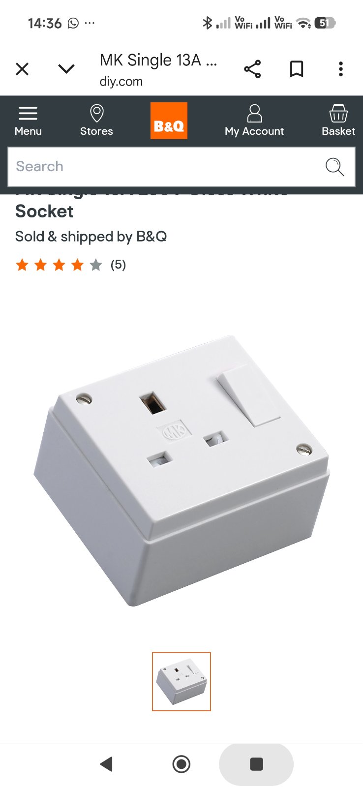

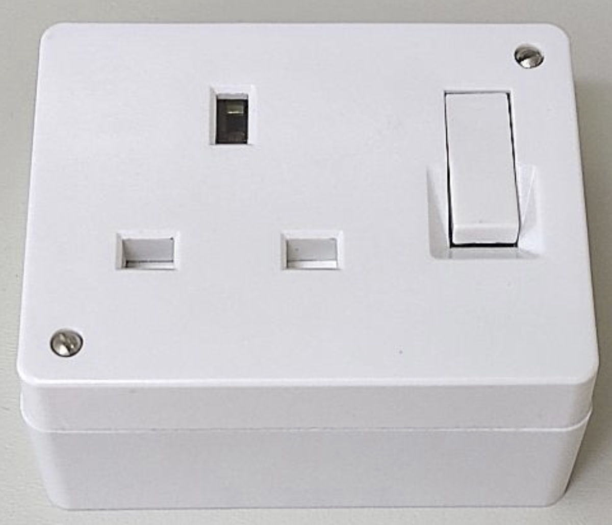

I have questioned fitting sockets upside down,

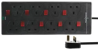

as if the cable entry faces up, then with some plugs, items could be dropped into the cable aperture, it would not comply with IP rating for hole at the top. One shown designed for a floor box, so not a problem, but

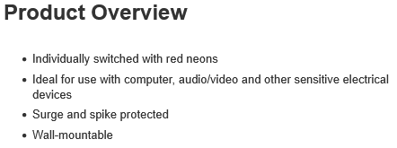

Looking at the "Wall-mountable" bit, would not this mean some sockets are upside down, and the hole for cable for reusable plug would not comply with IP rating?
