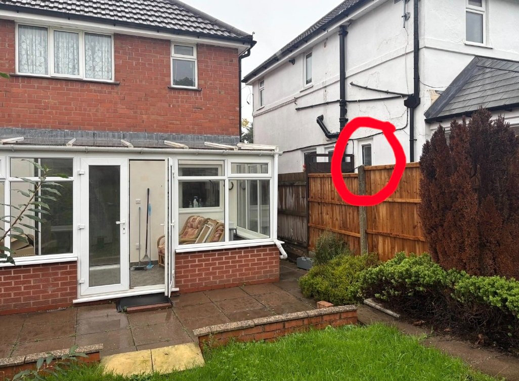

If it's the sole source of light to the kitchen that adjoins that utility room then I suppose they could argue that it is indirectly a window to a habitable room.
But if it hasn't been there for 20 years then that may mean it has no right to light anyway. In which case who knows... should it be assessed based on where their kitchen window was before they built the utility onto it? Edit: Or is this window their original kitchen window? In which case it's a habitable room despite the new internal wall if it's a wall that allows light through.
Is this a planning permission application? If so speak to them. I had objections to mine, with a list of tenuous nonsense reasons for objections. I phoned the planning officer, I just asked if it made any difference to anything. He said no, it's still being approved. So I didn't need to bother even thinking about their arguments, just ignore it and move on.
