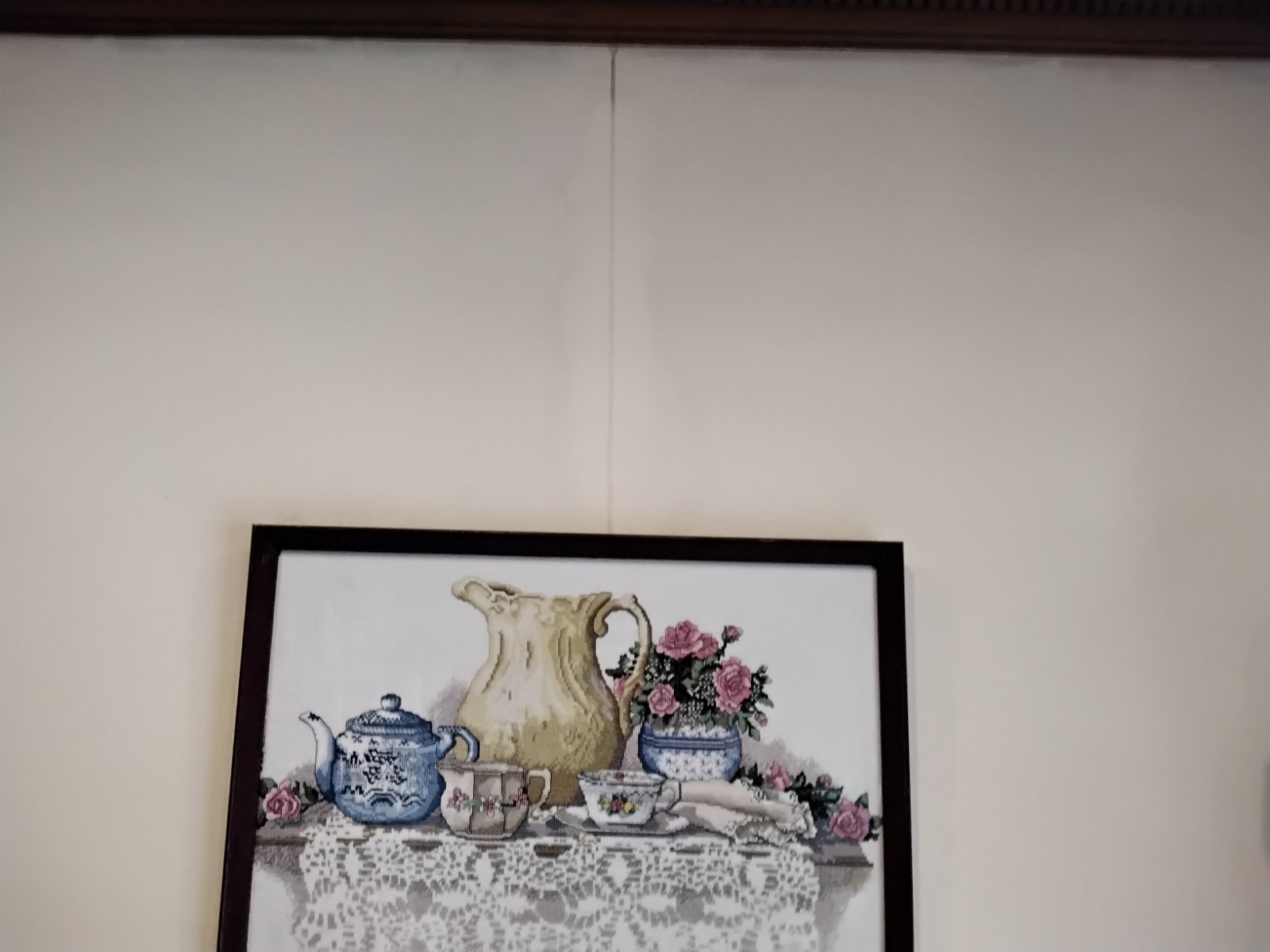

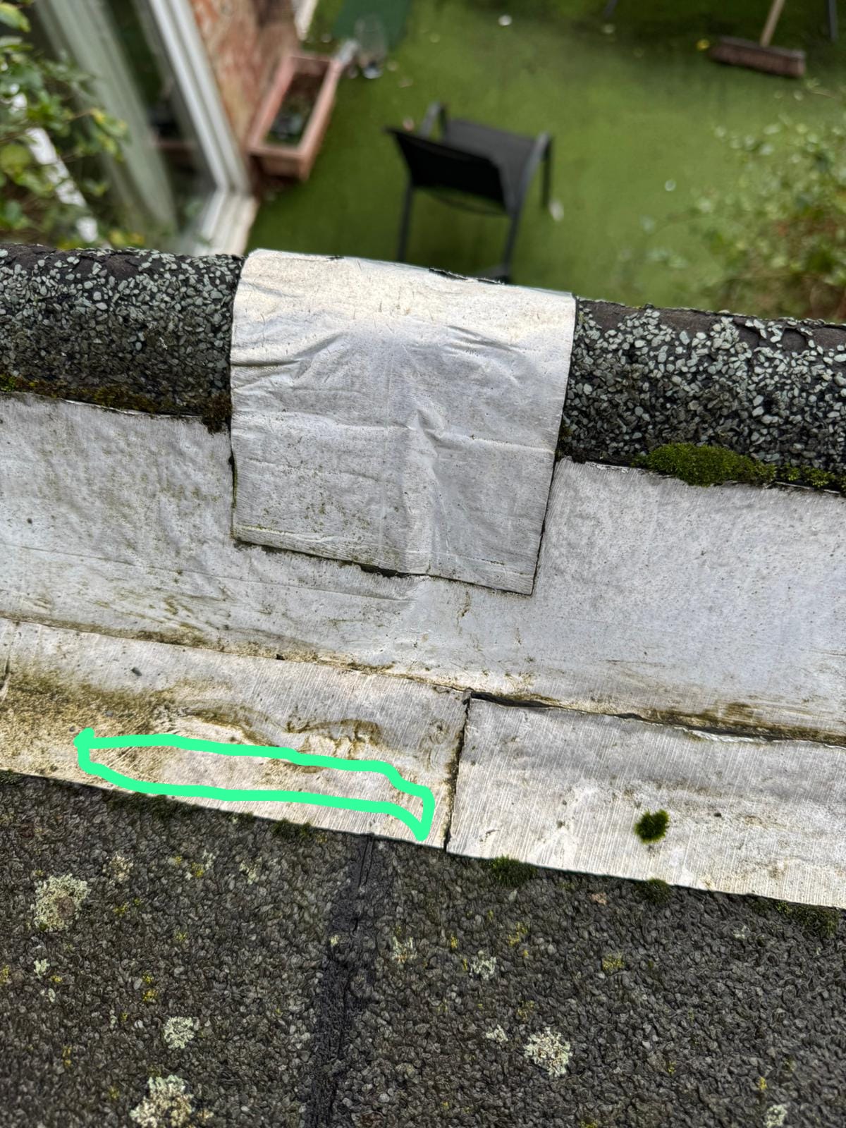

Hi
Water leak noticed in kitchen wall pencil thin line ( photo) on checking on flat roof suspect area marked green in the photo that area is SOFT to touch indicating
Water ingress?? I need help advise to fix this to reduce bickering lol other tapped area are not related they were put to secure joints etc thanking

Hi Iqbal
There is a product called Acropol that is good for those sort of problems.

Many thanks for the input can I just apply on the tape directly??

Your roof has had its day, but I'm guessing you already know that. If you do strip and re-cover, be aware of insulation obligations.

It's been poorly patched .. as above budget for re roof
It will have to wait until summer to get favourable weather any thoughts on detailed material guidance? As Google has various suggestions
But prefer from the more experienced & knowledgeable this will also help to finalise with the qualified roofing company thanking in advance

Dont do anything, wait until "summer" for a new roof - the roof & edging in the pic is threadbare, & the taping is DIY rubbish. Where a felt roof has gone soft it needs cutting out, & the decking below examined.
By the time you've messed about patching you will be trying to save money on something that possibly wont work.
As above, strip the roof, & install a warm roof.

Take the flashband off and brush the Acrypol on. It can be applied to wet surfaces no problem.
But as mentioned above, the felt is at life end. You could further apply Acrypol to all the felt joints and any worn areas, but you are probably looking at a new roof cover in the next few years.

torch on felt or single ply such as Alwitra.

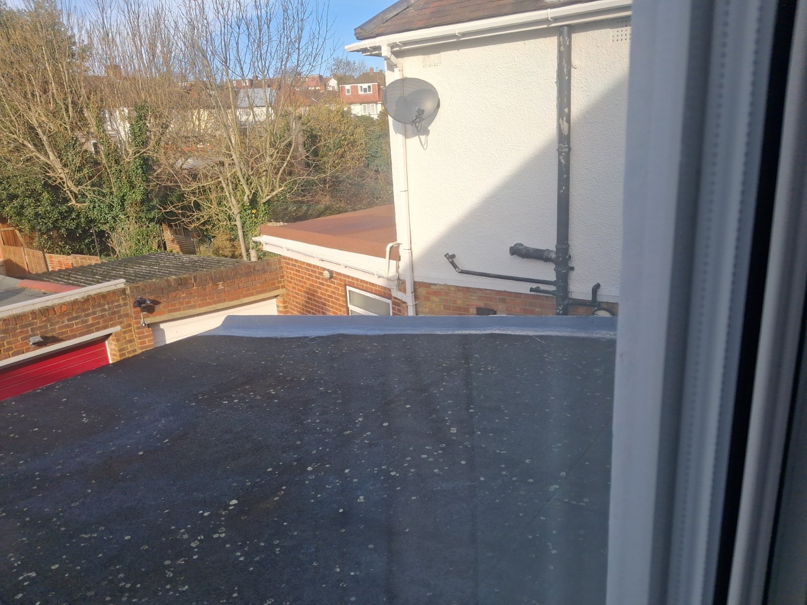

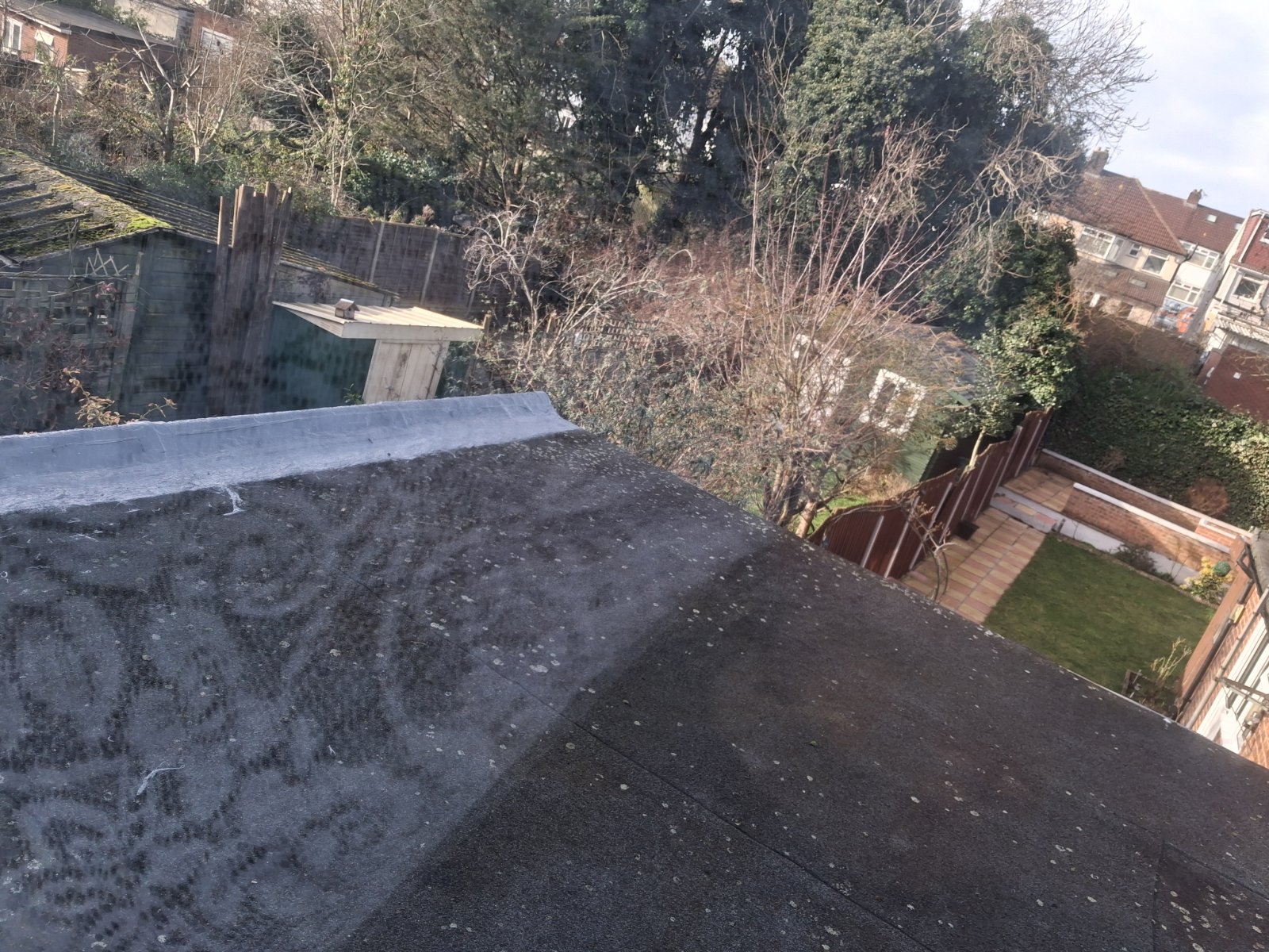

Many many thanks for all the help& advise have temp applied acrypol on both sides I understand the two options on reroof current is 3 layer
Felt torch so will appreciate if any person on here & does London west area for reroof can contact me but it will be early summer job

Tidy job, that should see you through till you get a new roof.
