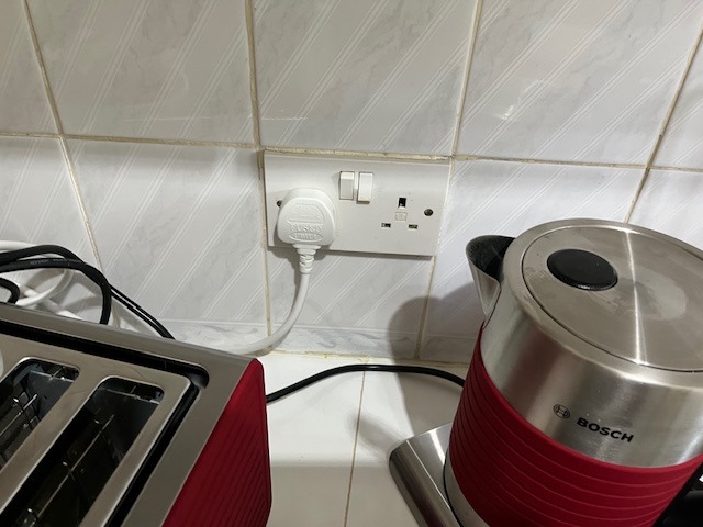

Hi
I rent a flat, had a call from tenants for loud noise and MCB trip in the kitchen. It is a small kitchen with 2 double sockets and 2 switched fused spurs. I checked the fuses in the spur, all good, wall sockets are working fine. However, there is an extension lead in the kitchen powering 3 devices; toaster, kettle and microwave, see photo. I told them this is wrong, shouldn't have extension leads in the kitchen for high current devices. Ts are stubborn, said to protect their appliances from current surges.
Is extension lead legal/allowed in UK?
Is it the cause of the MCB trip?
Thank

Extension leads are not specifically 'disallowed', in kitchens or anywhere else, but overloading circuit (whether via an extension lead and/or multiple sockets) can obviously cause an MCB to trip. Having said that, the 13A fuse in the plug of an extension lead will limit how many loads can be powered by the extension.

Not illegal as far as I am aware.
I can’t think of an immediate mechanism by which that could happen. Any sign of e.g. burn marks on plugs or sockets anywhere?

Don't know where noise from but guess from the MCB, all sockets are working. No black marks on sockets or on spurs.
Yes all reset and working.
MCB are 32A

No sign of burns on sockets or spurs or anywhere.
I think it's got to be the extension lead tripping the MCB.

Unless there is a fault within the extension lead (in which case it would probably not have been possible to reset the MCB), I don't think the extension lead can be to blame, no matter what was plugged into it (an excessive load should blow the 13A fuse in the extension's plug before a 32A MCB tripped).

But is it safe extension lead in the kitchen for toaster, kettle and microwave?

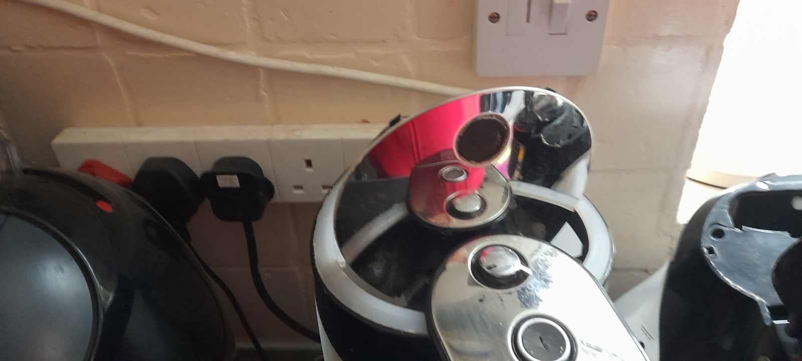

1744823417347.png I can hardly tell someone else they should not use an extension lead when this is my own kitchen. That's a coffee machine, and two one cup kettles all plugged into the same socket using that extension, and we often in TV adverts switch on both one cup boilers on together. So 6000 watts around 26 amps, and the 13 amp fuse has blown once or twice when used a second time, but most of the time there has been no problem. The time taken to boil is so short.
However, I note an MK surge protection double socket is only rated 13 amps for the pair. Non surge protected 20 amps, the pair, but it could well be the surge protection bit is overloaded.

The chances of overload from that extension lead tripping the MCB before the fuse in the plug is rare. However, you should encourage the tenants to avoid plugging in multiple high amperage devices in one extension lead.
The cause of the MCB tripping can be due to one of the appliances at fault, it could be a washing machine, laptop/phone charger or even a dishwasher. Ask your tenants if anything was plugged in when the "noise" occurred.
Next time you're there, see what fuse has been installed in the plug. Last week, I encountered a shoved 20A fake fuse inserted in the plug. Check the continuity of the fuse and report back too.
