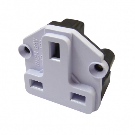

In any case, the closest thing I've seen to an "unfused triple socket" is a plate for mounting in a floor box, with three independent sockets pre-wired together https://www.comms-express.com/products/triple-socket-for-3-compartment-floor-box/,
MK also make a 6 module Euro plate which fits on a triple box and could be filled with three sockets (BS1363 or otherwise).

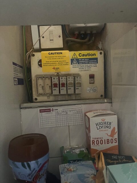

Are you sure that it is an MCB and not an RCBO (the latter will have some sort of test button)? If you're not certain, a photo would be helpful for us.
If it were an RCBO, then 'unexplained trips' are far from unknown, so a 'wait and see' approach may well be appropriate. However, it takes a lot to trip an MCB (e.g. up to 160 amps to produce a rapid trip of a 32 amp one), so it is probably more important to 'investigate'.
MCB trips are rarely due to faults in 'the wiring' and, if that does happen, as you say, trips would recur (or, more likely, could not be reset after tripping). Such trips are far more likely to be faults in connected items (cookers, ovens, microwaves, fridges etc.) and they can sometimes be 'intermittent' faults.
Fair enough. Do you know, or can you find out, what was happening 'electrically' in the kitchen at the time the MCB tripped - in particular what electrical appliances were 'on', and whether any of them had been turned on soon before the trip occurred?
There is fridge, air fryer, kettle, toaster and microwave, hood, washing machine, hob ignition fused spur, boiler fused spur on same mcb.
It is MCB, photo attached.

Tenant hasn't reported another mcb trip , is there a need for electrician to investigate? I spoke to my electrician, he said no need if only once.
He’s right - and you should probably believe him, rather than some random people on the internet.
It may appear somewhat inconsistent with what I wrote previously, but I essentially agree with your electrician - primarily because, given what you have now told us, it seems incredibly unlikley that he would actually find anything that could have caused the MCB trip, even if he did come and 'investigate', if the problem never shows its face again..
However, that doesn't really alter what I said previously ... as I wrote, if it were a single (not repeated) trip of an RCD or RCBO, I wouldn't dream of suggesting that it should be 'investigated' unless it happened again fairly soon, or repeatedly. However, as I also wrote, it takes a very considerable amount of current (hence a pretty major 'fault') to trip a 32 A MCB - so one has to wonder, and potentially be a little concerned about, what was the reason.
One (seemingly uncommon) possible reason would be a malfunction of the MCB (i.e. tripping when it shouldn't have). However, MCBs essentially cannot be tested - so, again, nothing for an 'investigating electrician' to find. If trips were happening repeatedly, with no reason that could be found, then, as a 'final resort', the MCB could be replaced - but it would make little sense to do so after just one trip - and, even if one did that, one would never know whether or not there would have been a second trip had the MCB not been replaced!
So, yes, 'watch and wait' seems to be a very reasonable strategy.
