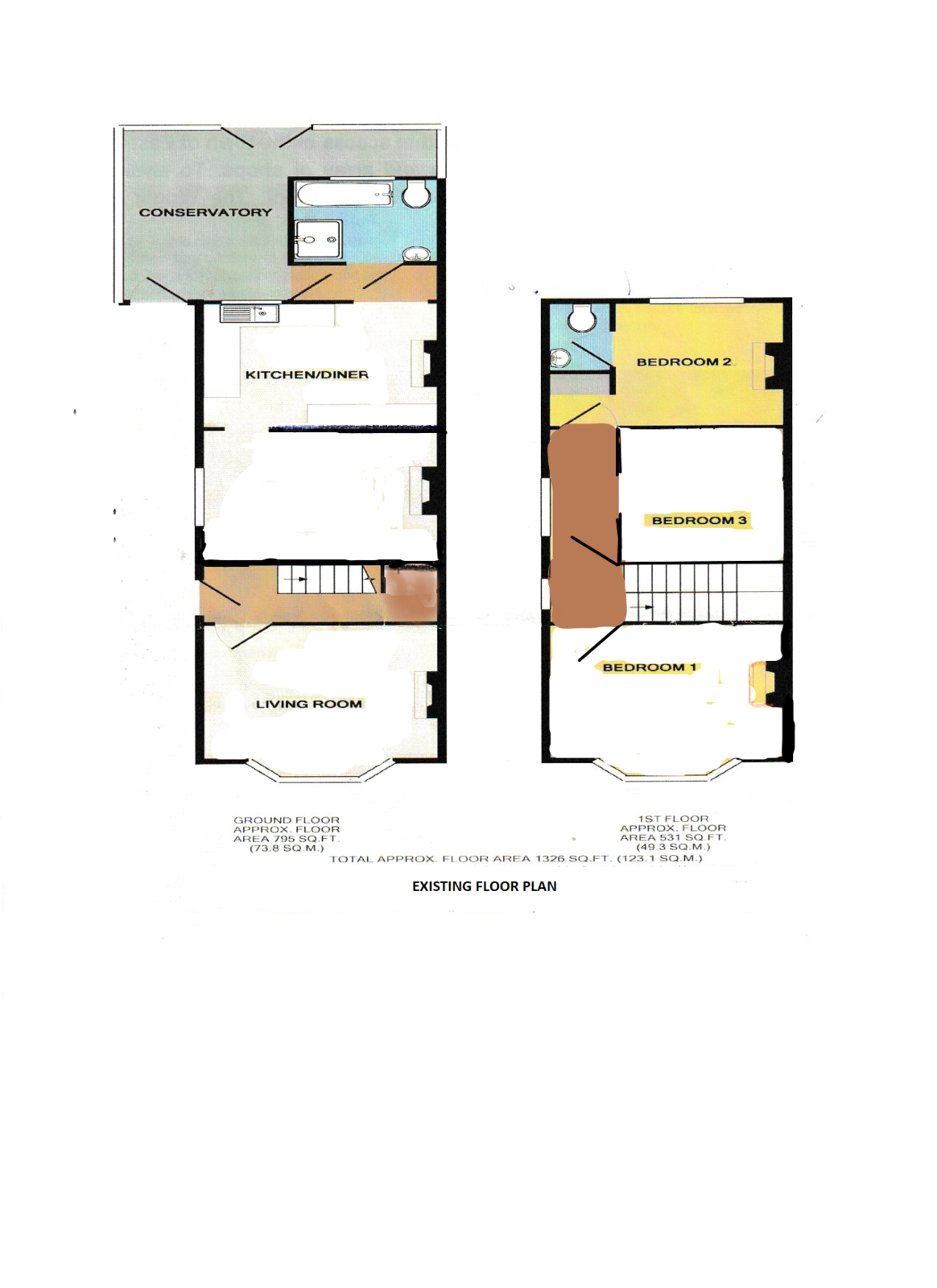

@IT Minion. maybe its a bad photo but there is nothing at the side. The slate roof extension, taking up half my rear wall is not pre 1948, so can come off. The conservatory only comes to level with back wall. I then walk through that far door and go down the side of my house to the front garden. Thanks.

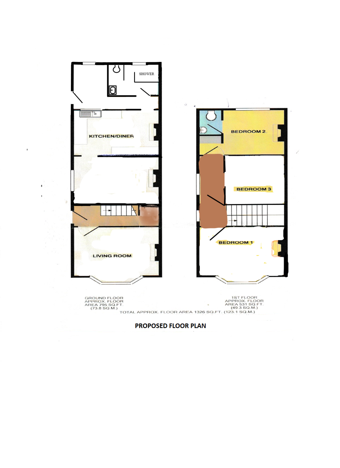

So it's a rectangular detached house. Very deceptive photo. Personally, I'd shove the bathroom back into the house and put the "family room/kitchen diner" at the back looking onto the garden. I have a vaguely similar original layout and put my internal bathroom/utility about where your middle chimney breast is, which was the darkest and dingiest part of the house. I'd try and open some of the back wall (between existing kitchen/diner and new extension) as well, it's entirely my opinion but that series of 4 seperate rooms one after the other seems very odd to me. And a real hike from the lounge and upstairs to the loo!
A decent layout will add far more value to the house than any extra cost.
@cdbe. I know what you mean, it was my first plan. As im doing it myself, whilst full time at work, and limited budget though, its difficult. The wife has also said, that with no bathroom for what will probably be about 9 months, there's no way that she's having no kitchen as well. That middle room is actually the lightest with its big window. I would swop the kitchen though and put bathroom there if she would relent. i have a few months to work on her. If not, my kitchen, with one small window and no conservatory roof anymore, will be very dark. Thanks.
