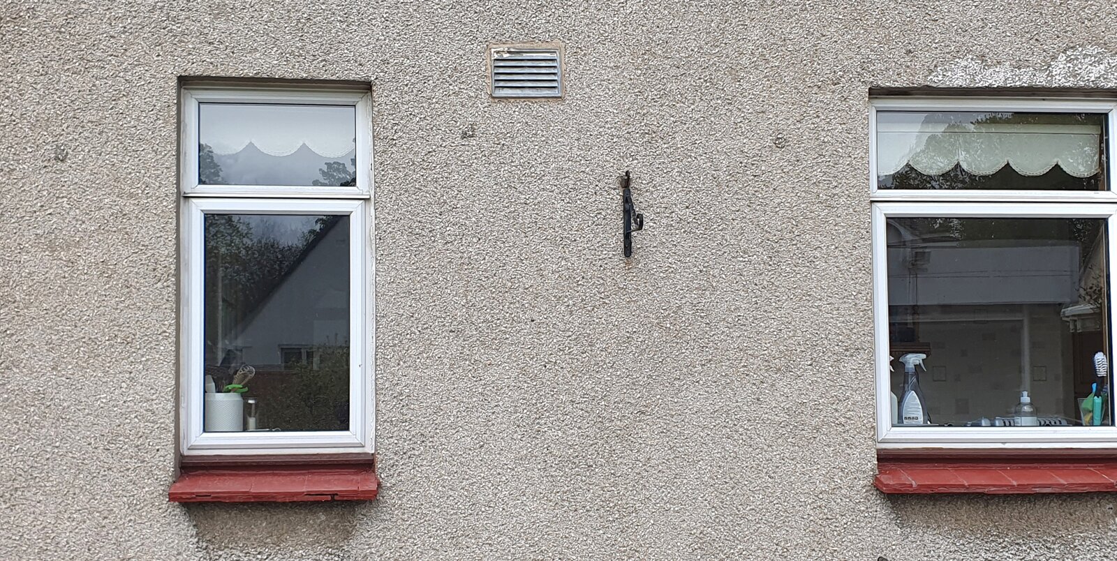

Thanks for your reply. I agree a dirty painted wall doesn't look great either and I suspect a fairly regular paint coat would be required to keep it looking good. This is partly why they market these coatings as do it once and then don't do again and that they're self cleaning but I've never believed that about anything. Basically other houses in this area have painted or rendered theirs white if possible and it does look nicer in my opinion, cleaner and more modern. Also we're getting grey windows, I know I know some people hate them but combined with a white wall we like the look. But they dont go so well with the roughcast colour hence wanting to change the wall colour. Image attached to show the render colour as is

Yeah, I get it. It has repair and insulation scars. The textured finish will look good painted, a lot better than smooth render does.
Light grey would be my choice, give the muck a better chance of hiding.
