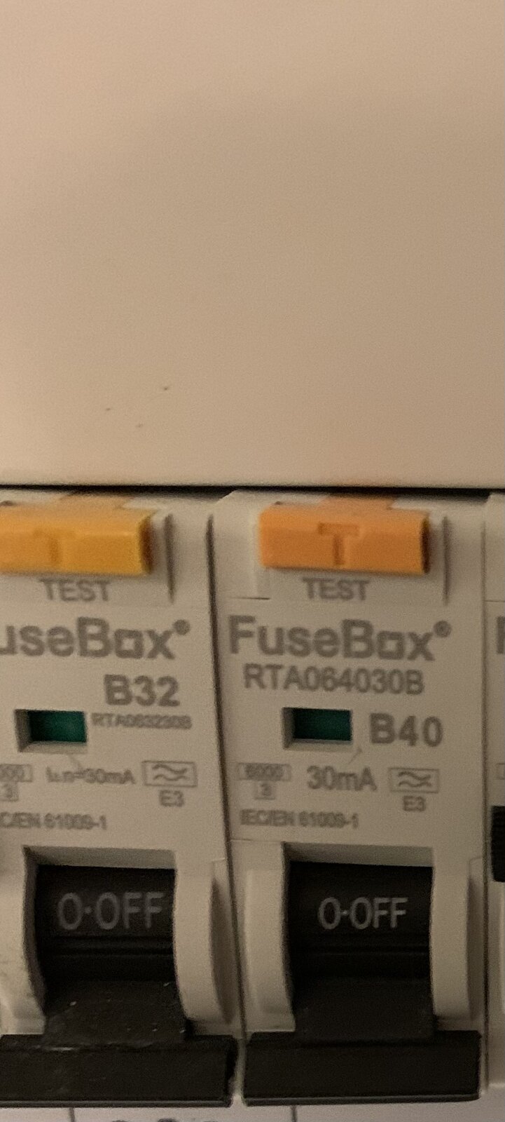

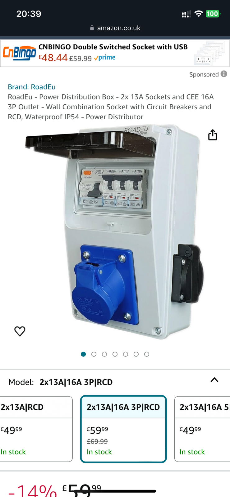

I need an external 16 amp socket and seen this unit with a 16amp and 2 x 13 amp sockets.
I already have a cable running from the Fusebox to the outside location.
Could the unit be connected to the external cable and leave the fuse as is at the Fusebox or do I need a different connection

Thanks for the reply. I will contact an electrician as it is more complicated than I realised. Question can I have a twin 16 amp unit? What size would the fuse then have to be.
The plug that plugs into it has no internal fuse, so regardless how it's wired or how many sockets connected the fuse must not exceed 16 amps
The Amazon box seems to have MCBs in it so if it’s fit for purpose the sockets should be appropriately protected regardless of the supply size (within reason). If an individual socket is fitted, the RCBO needs to be replaced with a 16 A one.
