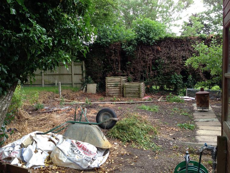

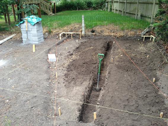

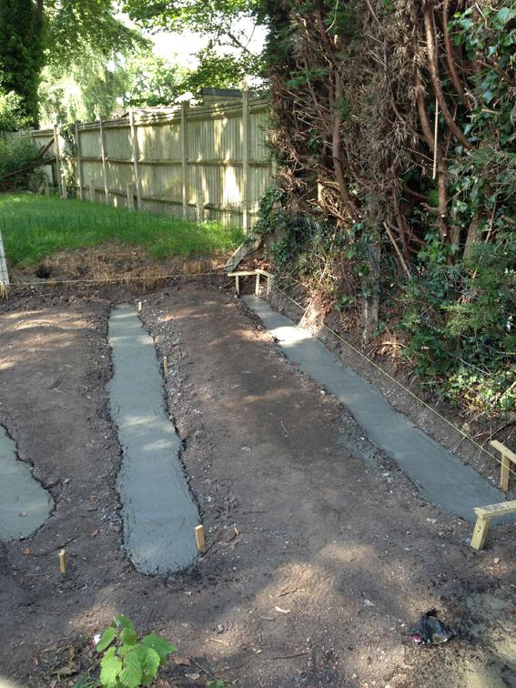

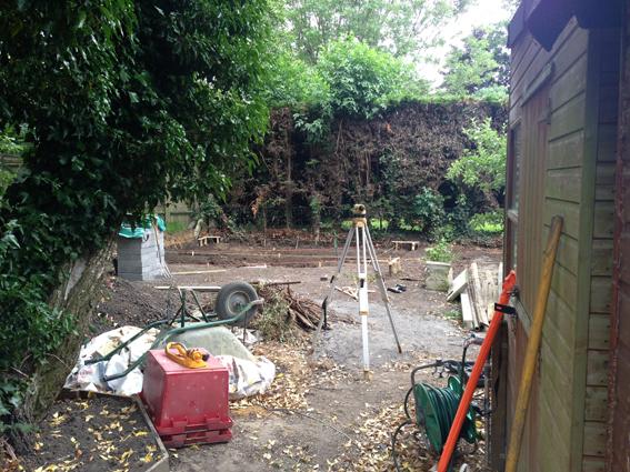

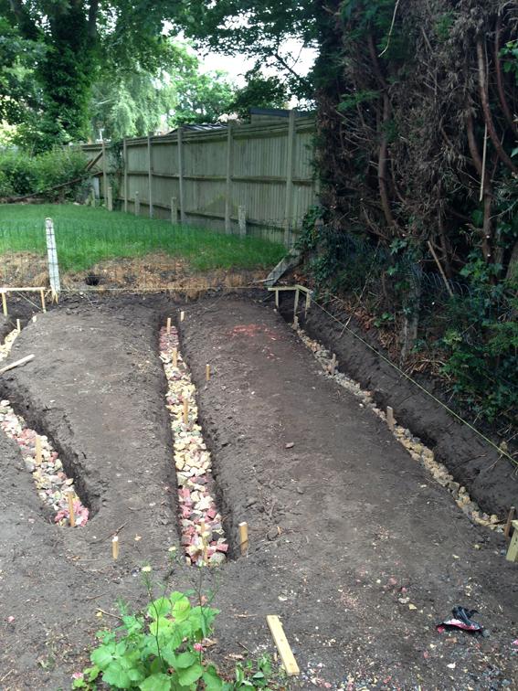

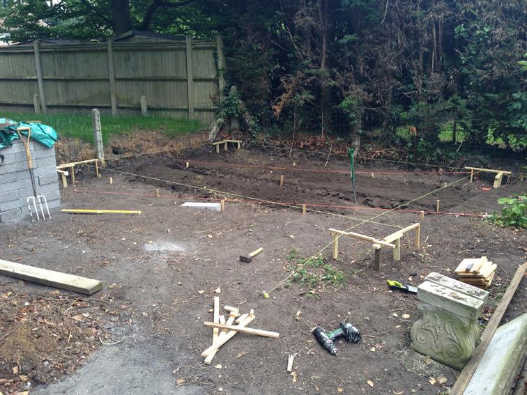

If you're interested this is where i'm @ to date... Think it will bore most but might set-up a blog charting progress in case it helps someone else in the future...
