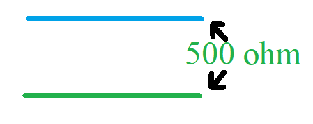

Yes, but only because you have introduced a 500Ω N-E fault.Working with this ...... as the volts increase, so does the mA leakage, at 4 volts within limits, at 12 volts near the edge, and by 15 volts tripped.

Well in the above mentioned garage there were NO LOADS running, are you trying to say the RCD shouldn't trip?Yes, but only because you have introduced a 500Ω N-E fault.
As I've written, if there were any loads on the installation, introducing such a fault path would cause the RCD to trip even if the N-E voltage were zero.

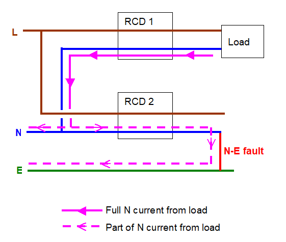

Not at all. On the contrary, I'm not only saying that the RCD should trip in the situation you described, but that it should also trip (in almost all real-world situations) even if the N-E potential difference were zero. I say that because, even if the N-E pd were zero, the RCD would be expected to trip if there were any significant loads anywhere in the installation (not necessarily in the same final circuit, nor even a final circuit protected by the same RCD) - and (other than for an unoccupied property) it would be an extremely unusual real-world situation for there to be no significant loads on any of the circuits for any appreciable period of time.in the above mentioned garage there were NO LOADS running, are you trying to say the RCD shouldn't trip?
Indeed, and that remains the case if the load is on a different final circuit from that with the N-E short (even, I think, a final circuit protected by a different RCD).Yup, without a load an NE short would not cause an RCD to trip. Once a load is running then once the N to L balance gets to the threshold of an RCD trip current then yes it will trip.
Surely that cannot be right?(even, I think, a final circuit protected by a different RCD).
With a TN-C-S supply, any other supply there is no way to be sure neutral and ground have no potential difference, I know with some supplies we put diodes in the earth connection to allow a small difference without current flowing, all part of the cathodic protection, but only seen that with canal boats.Yup, without a load an NE short would not cause an RCD to trip.
It is rightSurely that cannot be right?
No. The full N current from load (as well as the full L current from the load) goes through the RCD protecting the circuit(s) with a load ("RCD1" in diagram above), hence no trip of that/those RCD(s)If it were, would it not mean that all RCDs (e.g. a row of RCBOs) would trip with a single fault?
With anything other than a TN-C-S it is surely inevitable that there will be some N-E potential difference, isn't it? Absence of some N-E pd could only occur if the length of neutral conductor from transformer to installation is zero (impossible), or if no customer served by the transformer is drawing any current (incredibly unlikley)?With a TN-C-S supply, any other supply there is no way to be sure neutral and ground have no potential difference,
