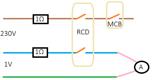

Maybe I'm being dim, but could you perhaps explain that statement?
Other than in TN-C-S installations, there is not uncommonly a significant N-E potential difference (due to VD in the supply neutral) - and, indeed, even with TN-C-S there is not uncommonly a significant PD between the CNE/PEN (hence N & E within the installation) and 'true earth' (for the same reason). However, in no case does that result in any 'potential for tripping' of an RCD.
Of course it does.
Of course it does.
You may regard it as a matter of "of course" but, as I wrote, even if it's because of my being dim, I'd be grateful if you could explain why you believe (if I understand you correctly) that a significant N-E potential difference may result in an increased possibility of RCD tripping. Thanks.
