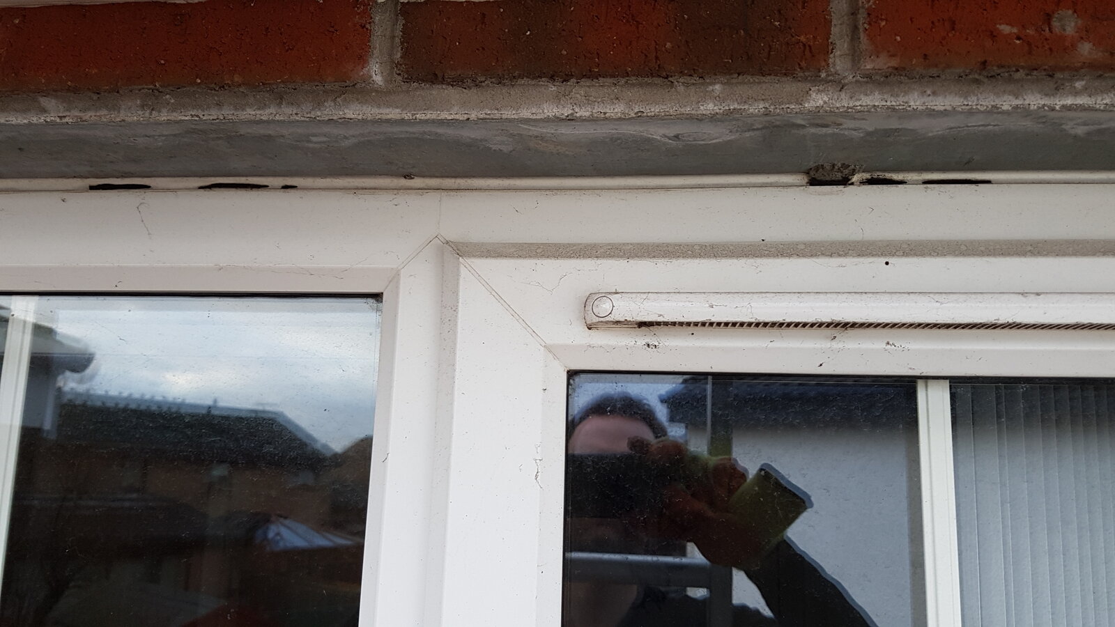

I've noticed some fairly big gaps in the silicone above a couple of our external windows.
I was just wondering if we might be better trying to use something other than silicone to cover this?
I'm thinking if we re-silicone, due to the size of gaps if might just break away again.
See attached photo.
Any suggestions or advice on this would be appreciated.

tbh although difficult to gauge 100% from the pic, the gap doesn't look overly excessive. It's failed partly because the original bead wasn't quite wide enough for the gap, some shrinkage etc. I'd make good bits of crumbling concrete as can be seen in the pic, then would use this or equivalent:
Dow Corning Dowsil 796 LM Frame Silicone Sealant - Brilliant White (sealantsandtoolsdirect.co.uk)
Ensure you cut enough (but not too much!) off the nozzle to give a slightly larger bead than originally applied.
It might look neater to pull out existing silicone, put in new and trim over to hide.

I would pull off the old silicone, then either fill with a small bead of foam or seal it with silicone then slide a bit of 45mm trim in the gap and then seal with a thinner bead and also hiding the underside of the mortar/catnic killing 2 birds with one stone

In my opinion, these are your options and tbh any will be better than current situation.
1. Go with basic sealant out > sealant in as per my original suggestion. If you apply it correctly it will look fine and will do the job. No need to fill gap prior to assuming your bead is large enough.
2. Go with thin trim as per my first pic. It's easy enough when up there to run sealant into the gap before applying the trim. You should then run small bead of sealant around the trim to hide any slightly messy edges and aid draft-proofing.
3. Go with deeper trim as per my second pic and Cranks suggestion. Again, if going to that bother it's easy enough to fill the gap prior to adhering the trim. Again seal edges to hide any rough bits and aid draft-proofing.
Don't bother with expanding foam, size of gap doesn't merit it.
p.s. If you're slightly apprehensive working up the ladder, you might be better sticking with option 1 for quickness and easiness, just a thought.
p.p.s. If your other first floor windows have the concrete exposed but you don't intend to do anything with them, you might be better just doing option 1 so things look consistent across all the windows, again just a thought.

As long as you remove what you reasonably can it'll be fine. Just make sure your new bead is large enough to get good adhesion to both the window and concrete. You can apply in colder temps but things like flow and surface adherence can be issues. I'd say wait for a slightly milder day, ensure the surfaces are dry etc and go for it, but don't apply when the snow's falling :)
