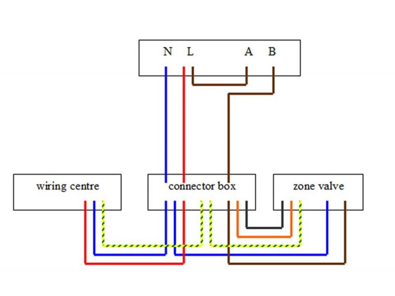

Why do I need a connector for the browns? Thought I understood till you said that...!
If I use a timer and a 92e thermostat, I won't have frost protection to the new zone? Unless the wiring gets clever - which I can't work out how it can.
Because there is nothing in the wiring center you can connect the brown too.
In my ;last post I suggested you look at the Honeywell Sundial RF pack 1.
You could have a separate frost stat with that set up.
There is nothing in the current HTG valve connector so why can I not wire the brown from the valve into this?
Oh, you mean both valves will open with the current stat and therefore wouldnt be zoned....?
In which case, what type of 'connector' are you suggesting?
So you could use the grey as the live to L and the blue to N.
For the browns you'll need a connector.
Any small electrical connector, they come in a strip of 10 normally just cut one off.

Doitall - Have read all your posts- just wasn't understanding them all.
Didn't realise either you just meant terminal blocks! There is space in the wring centre to wire the brown into... hadn't realised you were also suggesting linking the stat to the valve within the wiring centre - make sense now...
Also, apologies for missing your edited post where you suggested Honeywell Sundial RF pack 1.
Many thanks for your patience on this, I now follow. Much appreciated.
Before you rush of, post back exactly how you think I said do it.
Better to spend a week on here that damage the pcb etc, and time isn't a problem during the day
You can't use the space on the board for the Brown.
A drawing for you Stu. if you go for the clock option post the details
Notice I added a connector box as it will be easier for you and make the unused wires safe at the same time. A surface mounted box with a connector strip and blank plate will do.
Why can't the space on the board be used for the brown if it goes via a stat and terminal block?
Thanks for the drawing! It's what I was thinking of. Just hadn't drawn it out.

This okay?
