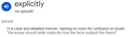

I'm a bit lost - are you perhaps just quibbling about my having included the word "explicitly", which seems to be the only difference between what I wrote and what 701.55 says?
Well, that depends what exactly you mean by 'explicitly'.
Clearly you have confusion and doubt so not explicit - but I do not.
If you mean that it has to actually say the words 'item suitable for zone 1' then no, it does not say that.

Well, that depends what exactly you mean by 'explicitly'. .... Clearly you have confusion and doubt so not explicit - but I do not.
As I suspected, basically just a quibble about words! If it helps (as as you suggest yourself below), just change my word "explicitly!" to "actually".
I have absolutely no 'confusion or doubt'. The simple fact is that if the MIs do not actually state that the item is 'suitable for installation in Zone 1" - which is what BS7671 requires.
