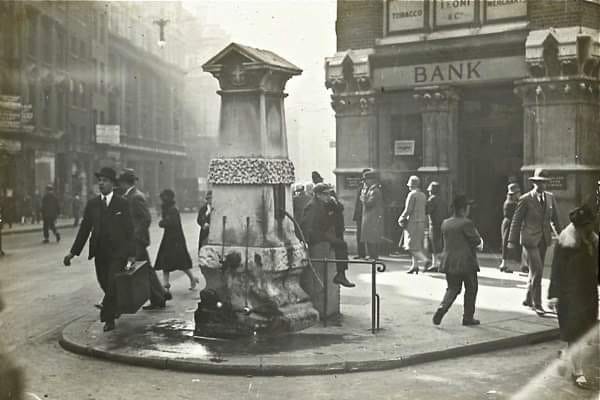

This is the old Aldgate Well pump.
It used to be noted for its flavour and high content of minerals, especially calcium. Can you guess why?
https://www.historic-uk.com/HistoryMagazine/DestinationsUK/Aldgate-Pump/
