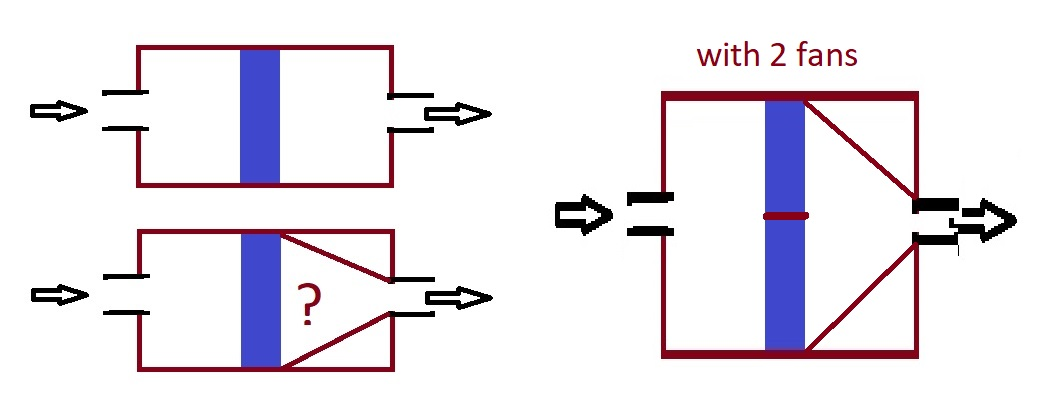

This is an odd one:
Instead of a standard inline extractor fan, I used a 300mm PC fan.
To adapt to 100mm ducting, I made a box with 100mm inlet and outlet.
The box sits in the loft and takes air from a roof vent via 1.5m of 100mm ducting.
It pumps the air down the house via 6m of 100mm ducting.
Effective air flow is 2 times greater than a standard £80 manrose while I paid £10 for two PC fans :-)
Hence the DIY.
Here is the technical question:
In the aim of increasing the air flow even more, should I install the second fan in parallel or in series (one in front of the other)?
Parallel setup would force me to make twice as large housing.
Series setup seems easier.
Anyone knows the "aerodynamics" of 100mm ducting? ;-)
In parallel, or one Fan will damper the other one.

Thank you!
Actually, I never shut the door of this room. I can't open windows as it's a busy road...
Now to make a larger "compression chamber" for 2 fans :-)

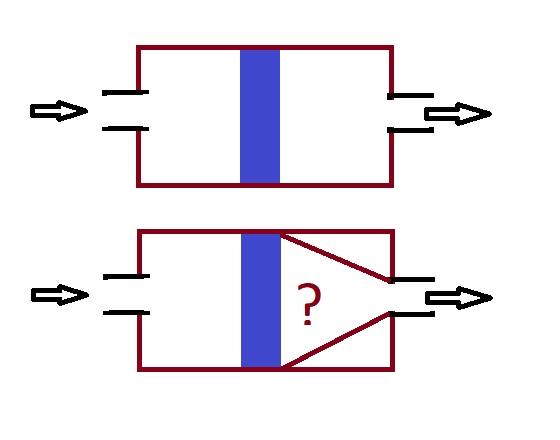

I am also wondering if making slopped walls on the outlet side will help?
As on the bottom "drawing" - top throw.
