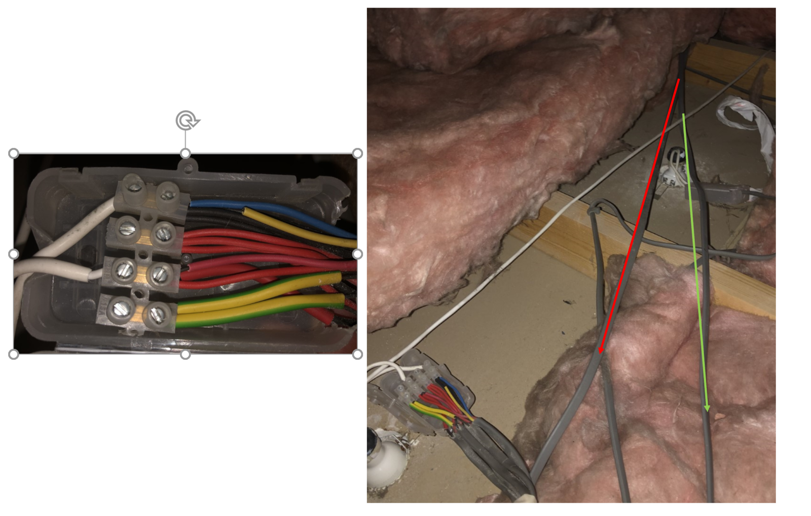

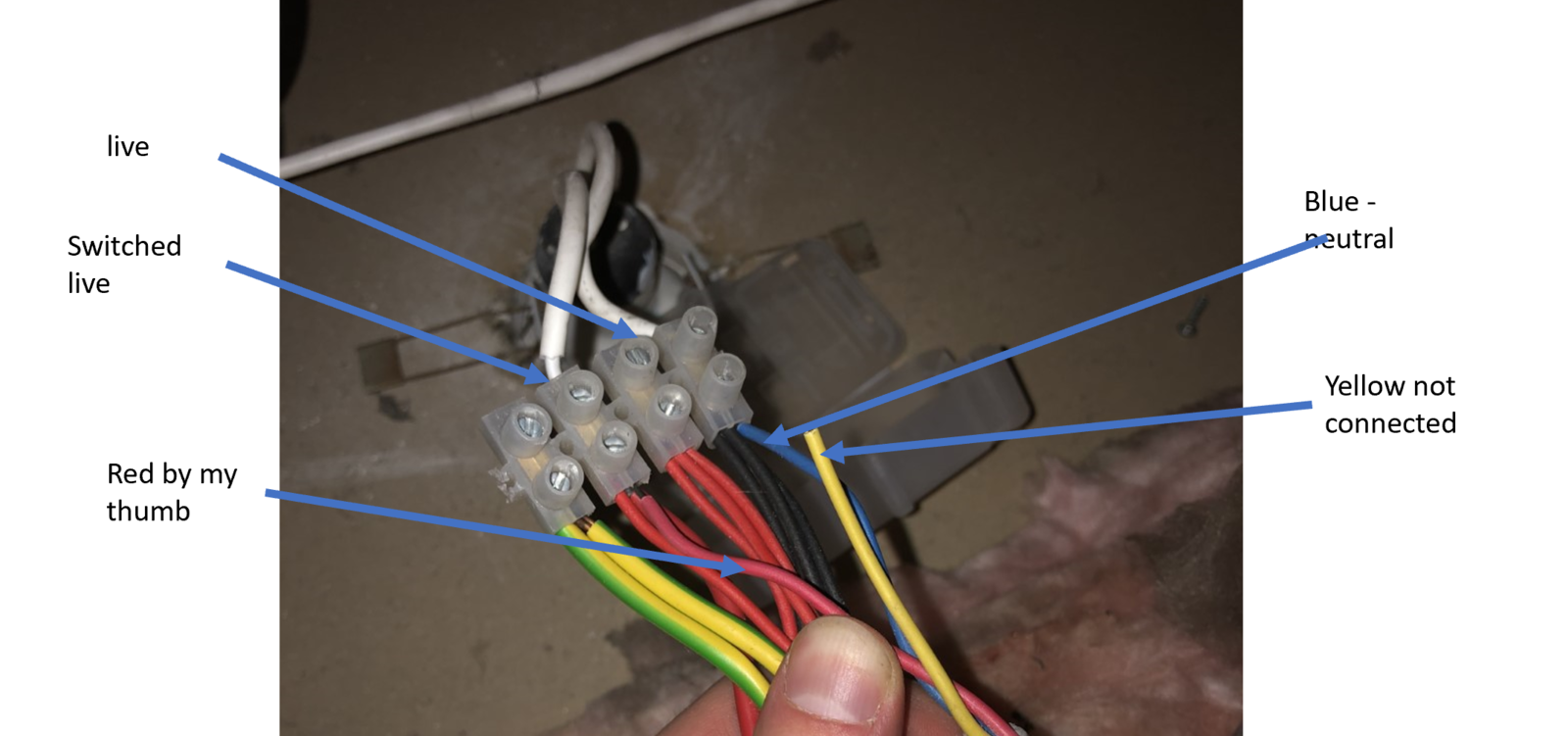

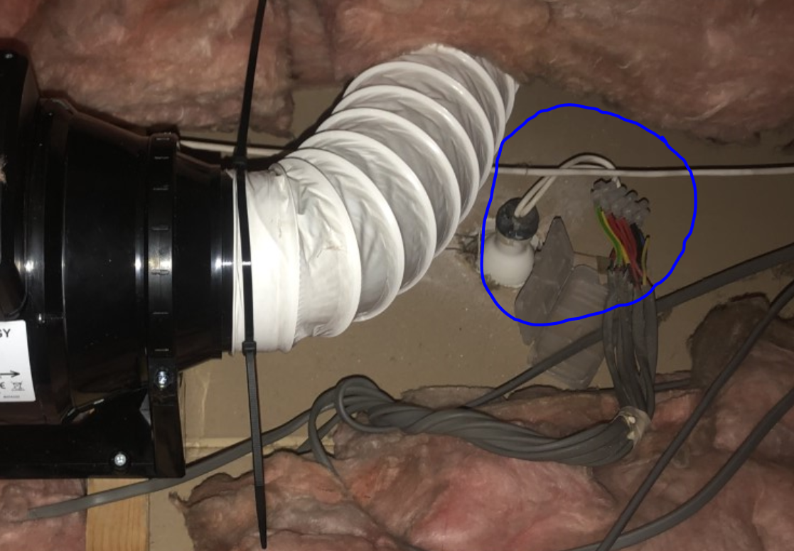

I have just checked the plug and it would seem like i dont not have a live wire, only a switch live. I have checked the other lights in the same bathroom and they have a live wire, see blue circle. Can I take a wire from the live terminal and feed it into the extractor fan??
From the photo below, the red arrow cable comes from the light switch and the green arrow goes to from the isolator to the fan. The fan cable doesnt come from the the terminal box on the left that is for the standard lighting.
Hopefully the pictures are better.
Yes, but we need to see which of these cables is the fan cable
and separate them so we can see which wire is which.

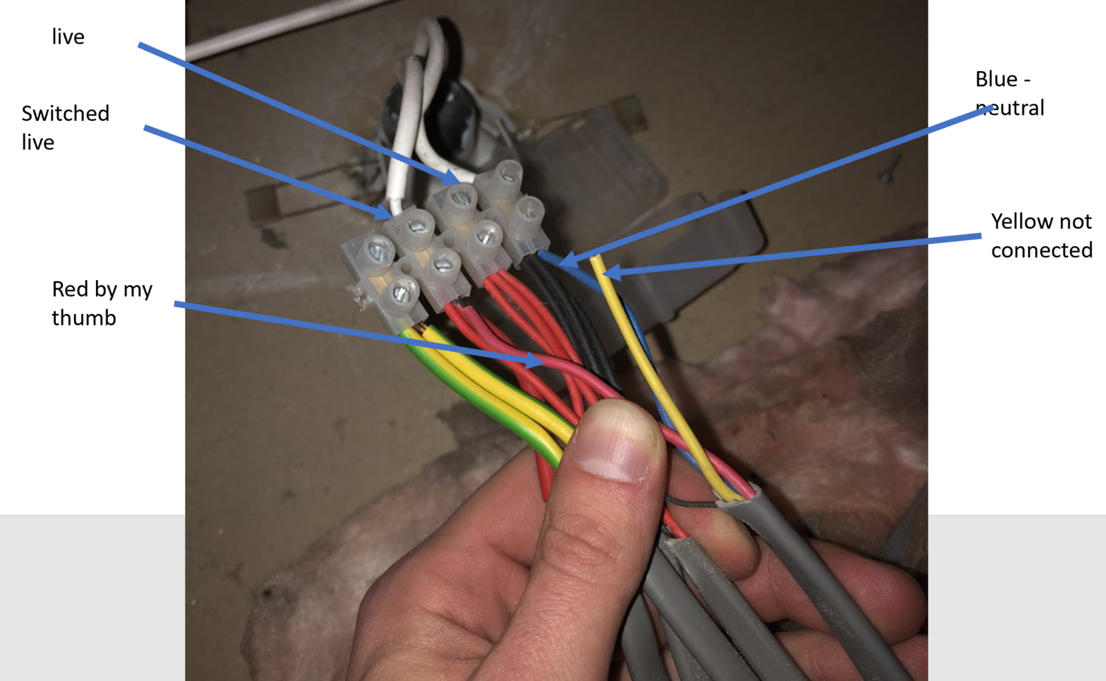

Ok so the cable in the bottom right is the feed going to the isolator. The red goes to the switched live terminal, blue to neutral and earth to earth. Therefore there is no wire going to live which it seems could be the yellow however it has not been connected and cut short.
Right, first make sure the yellow is connected properly throughout and then put the yellow in with the permanent live wires.
It should now be sleeved red throughout to show it is now a line(live) conductor.
I would personally make the red the permanent live but that is not essential.
