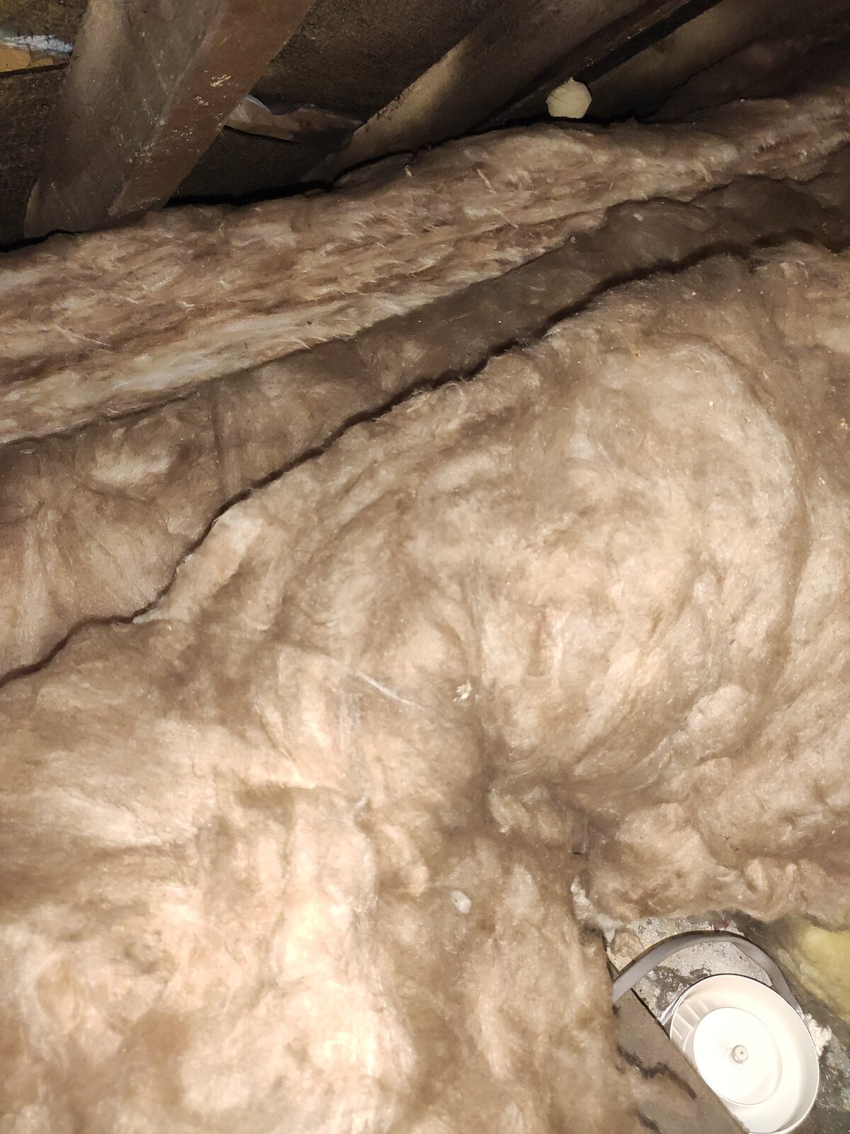

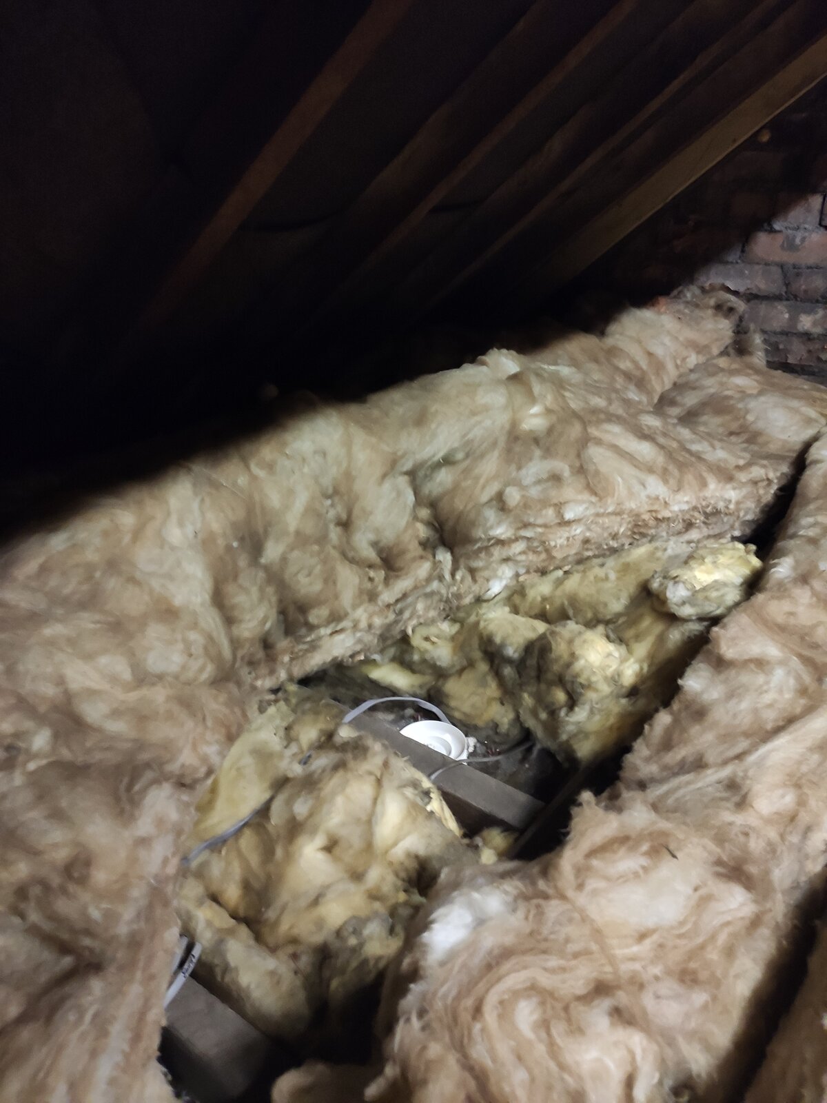

go and have a look in the loft. photograph the fan spigot. Verify that it is not covered in insulation. Phograph the eaves. Can you see daylight? Pull back the insulation if not, on at least two sides to allow airflow. How far is the fan from the eaves? Do you see any other ventilation gaps?
Thanks for those replies. Sorry I should have said that the fan is in a bathroom. It sounds like it can't be assumed to have adequate ventilation up there. Would it be clearly noticeable if it were getting too humid after a shower, or would there not be a way until damage had been done to the structure?
Re "having a !Tradesman" do it probably won't be a guarantee its done properly" - I meant tradesperson just as a general term for someone in a profession that works on building stuff, including good people! I'm just wondering who would be the best type of professional to look up? It doesn't seem obvious to me.
I saw this after I wrote the above - the fan isn't covered by insulation. The fan is one or two feet from the eaves. When I looked before there only seemed to be daylight from a few holes that might be vents in the tiles - the loft is pretty dark overall.
pull back the insulation (in daylight) and post photos please

I've attached photos of the fan amongst the insulation and how it appears at the edge of the loft with the insulation pulled up - the sun had gone down, but it seems to be all closed up anyway.
looks like the insulation was rucked up to block any eaves ventilation
and your roof is now felted which will also block ventilation
though I think there is something wedging open the overlaps to let air in
the eaves do not seem to have a gap big enough to poke a duct through
by the look of that black powder, you are in an area that was once industrial, or had lots of coal fires. It's possible to hoover it up if you want to (it is very heavy when collected)
That last photo is interesting!
What's the electric item?
Looks like n old light fitting minus the bulb and cover.
Absolutely not safe like that if still connected.
