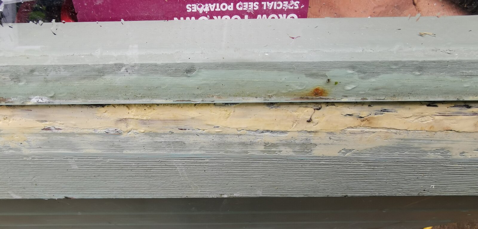

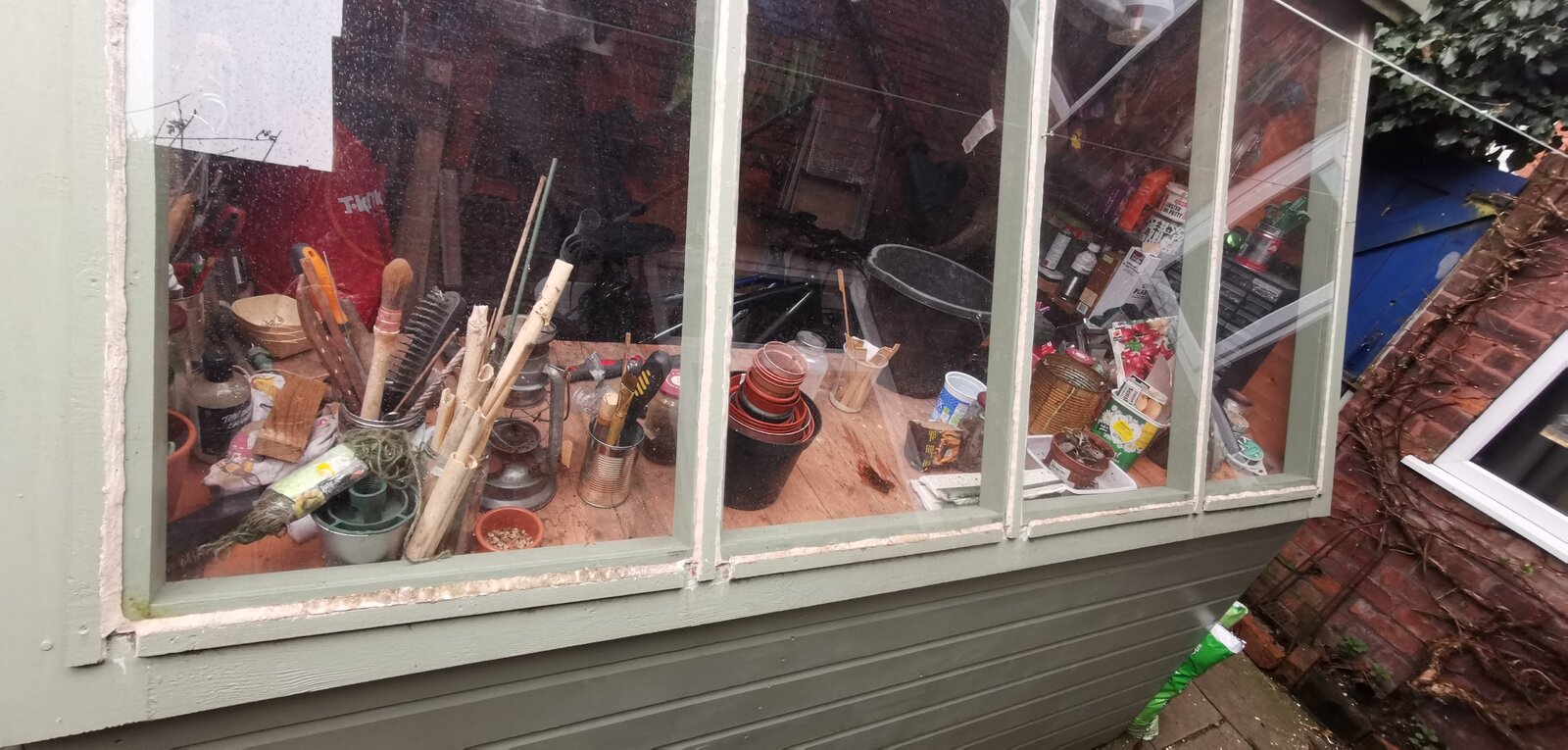

Doesn't look like the glass is held down by anything. It is surrounded by the square beads for positioning. If the mating between the bead and shed is not sealed, that could let water in. Show a pic of the leaking location from the side.
The water is definitely not getting in under the felt, unless of course rain is so hard driving it splashes up but it has never leaked and I have never seen water running down from the top of the window. All the water that has leaked has done so at the bottom (of the edge where the putty has shrunk). I will just dig the putty out on a hot dry day and go over the top with sealant and live with it.

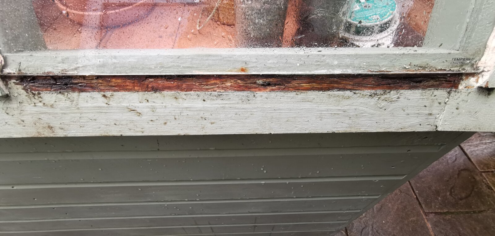

Well, some months on and the putty looks horrible. There has been a lot of wet weather in Cheshire so it seems the putty at the bottom of the window is trapping moisture behind the glass that has dissipated down into the wood which is actually starting to rot! I'm absolutely gutted as I didn't think this was apparent until I pressed it with my finger and it was spongy. I won't tackle this until drier weather in Spring but suffice to say I shall take out all the putty at the bottom (already done the corners in the hope that it will drain) and try and treat the wood before painting again. Now I wish I had used taks as I did with the old perspex as the water drained and no wood was rotten.

Ok, so it seems that nobody can help with this. Again, why would a single isolated bead of water appear with no apparent evidence of it's journey ? I just give up with it. The thought of digging all that horrible stuff out again depresses me.

You have been given sound advice, but seem to have ignored that advice.
Again, if water is running down the interior of the glass, it has absolutely nothing to do with water ingress lower down the glass.

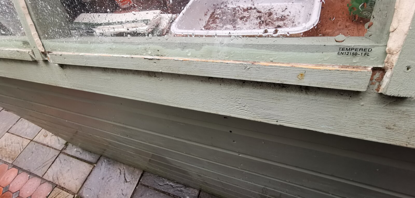

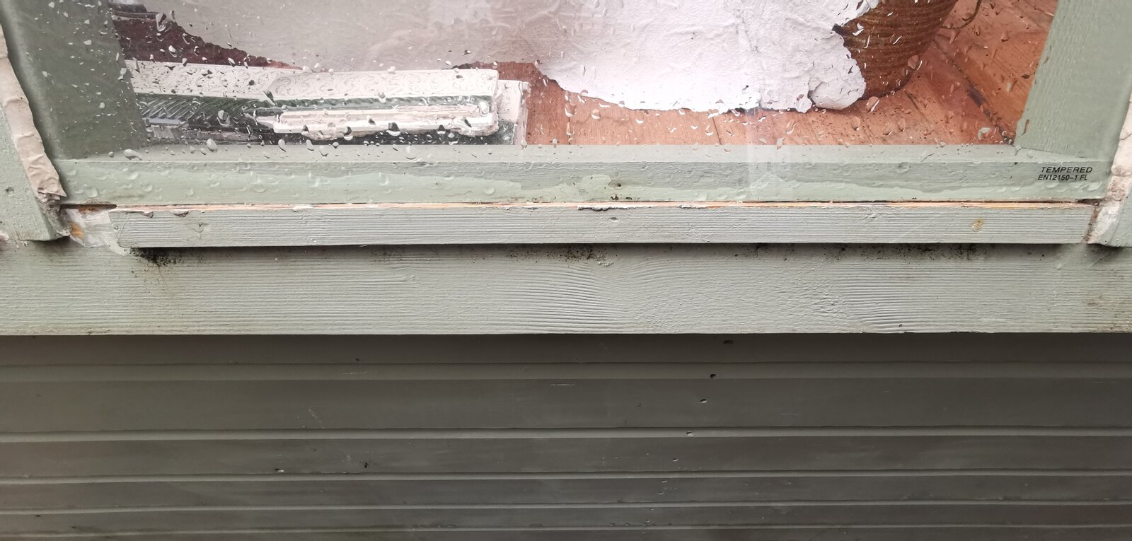

Well, I have removed the still not set putty from the bottom of the window to let any trapped moisture drain (gravity) and yet the water retention is now worse than ever. When the old pvc windows were just sat in the frame heald with small nails, there was no water ingress at all. I may remove the small (and now rotting) wooden battens holding the glass and replace with something more free draining.

Well, whilst you have removed the putty from the outside of the glass it is still sitting on a bead of putty. That is what is causing the water to collect behind the glass.
When putting in glazing you have to apply a bead of Putty into the rebate first, importantly, the bead should be pressed against the inside edge of the aperture and the glass pressed into that. The extruded putty in the inside is then cut away by sliding the knife or chisel along the face of the glass. I
Small nails or glazing sprigs hold the glass in place the bead of putty that goes over the top is to look good.

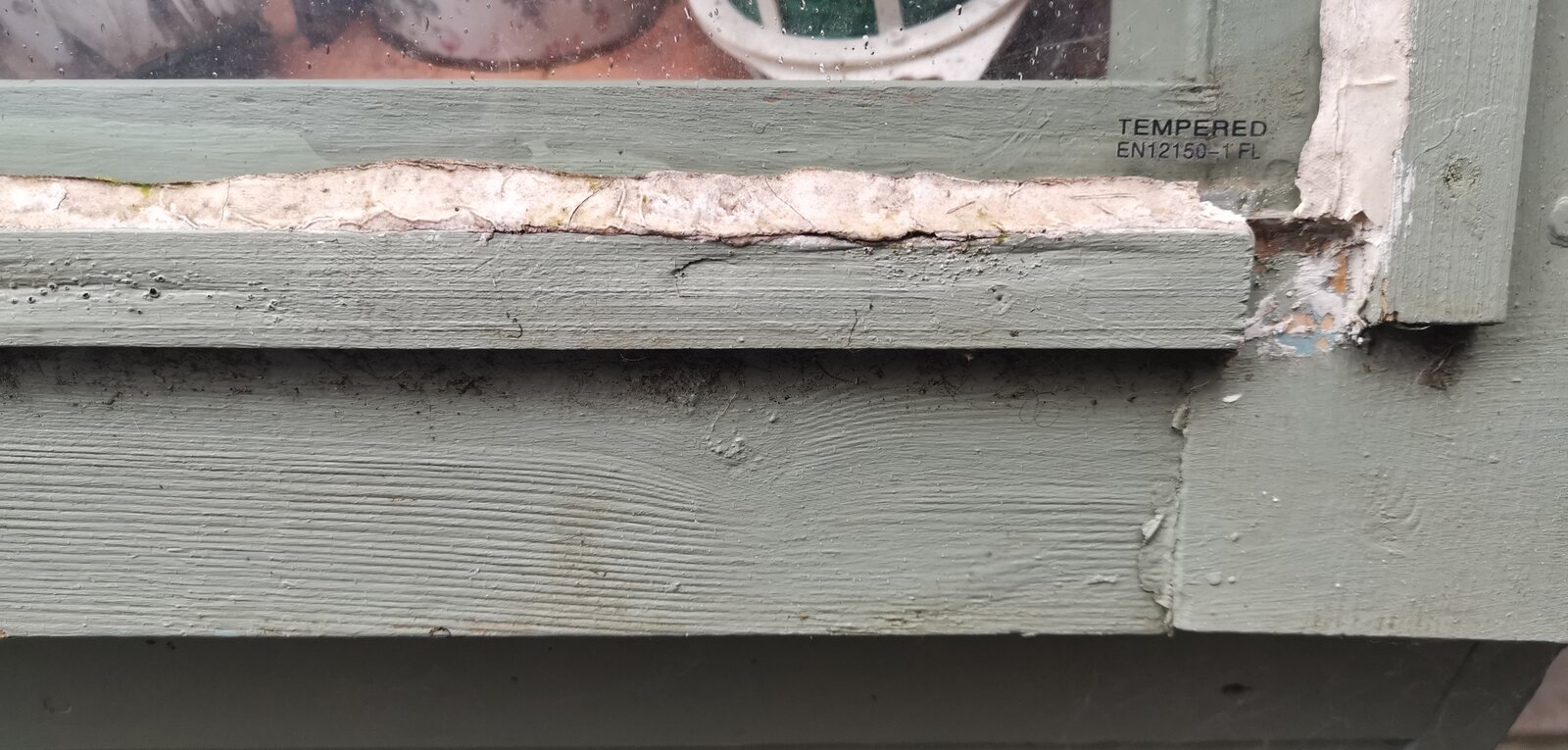

Well, I think what I'll do is just try and get out the residue that holds the water and replace with new wood ledges and keep open to allow water run off (as it did with the pcv glass)

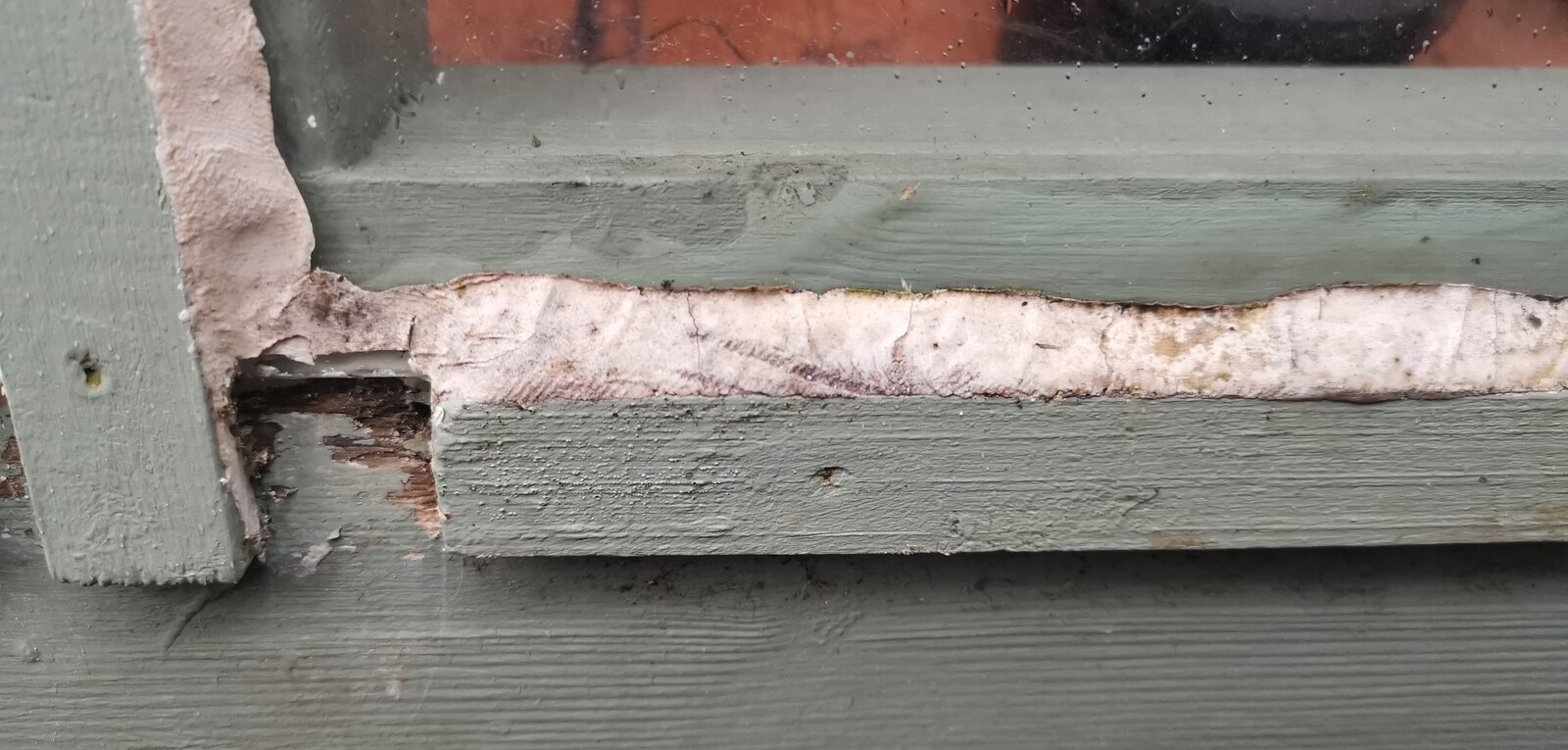

Well after removing the putty to give the water a bottom drain, and a few dry windy days for the water to disappear I am astonished to find water is just as bad. So basically this water likes to travel upwards and defy the laws of physics.

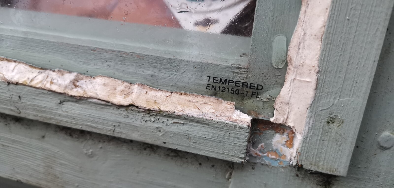

Its even worse than I thought because of this never ending wet period that drags on and on. I can't believe how quickly this wood has rotted. I shall have to paint it with Ronseal rot wood hardener and fill it.
Even taking out the wooden shelf that was rotten the water still seems to travel upwards defying the laws of gravity.
