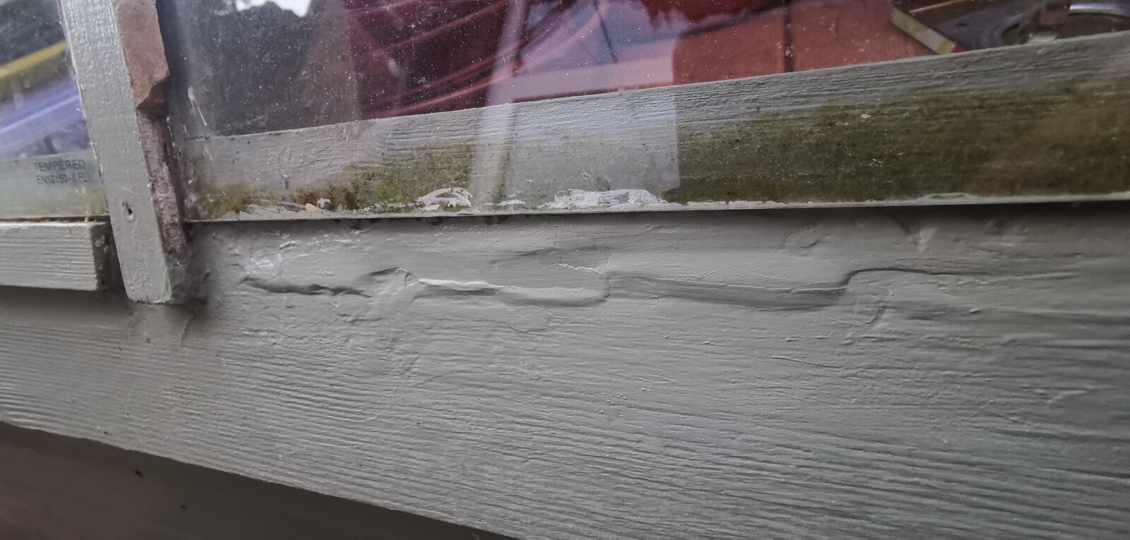

Failing putty (new shed window) (Ed.)
And it has got worse, bubbling up. So much for Weathwrseal paint!
No paint can work on wetted/moulded substrate. If wet, paint will fail. If drying from wet, paint will fail. If mould growing on the paint or under the paint, it will fail. Mould growing under glass indicates ineffective putty seal. I presume you are using putty because the trade advises it. Trade is for profit and frequent maintenance produces profit. Therefore you must be doubly careful with that. The most effective general purpose sealant you can get is the hybrid polymer. It will work on most things except some plastics. The rot is caused by water getting to the wood. The water is entering at the corner between the rotted piece and the surface it is attached to. The attempt to seal that corner with paint has failed. A bead of sealant will work. All corners at risk of paint cracking from thermal expansion and contraction should be sealed.

I haven’t read the whole thread, but to me it’s clear that the very first photo shows condensation, not leaks through the putty.
Plants create moisture and humidity, the glass is cold hence the water vapour condensates on the glass, it's normal.

Having read the entire thread through and not commented until this point personally I'd use a multitool to careful removing , existing putty , hopefully not breaking any glass. Then remove glass and clean all putty out ... then completely ditch the putty idea. Use a butyl flexistrip ( from Hodgsons sealants , reddiseals sell it ) as a backing ' putty, press the glass firmly on and fix with sprigs. Then a low modulus clear silicone around all edges of the glass and apply TREATED and pre stained/painted wooden beads, using sheridised pins. Then once fitted firmly, go around the edge of the glass, where it meets the beads and apply another line of clear silicone to ' cap ' the joint, on the inside of the shed and the outside. I'd also make sure you do that too bead regardless of what Tiger sheds say. I have uses this method many times on wooden sheds and all you should need to do is reapply the ' capping 'sealant as and when it starts to deteriote with thermal movement of the different materials ( wood shrinking and expanding mainly ). Even if you get that putty on and it stays dry , after a few years it WILL crack and you'll be revisiting it anyway. Wooden Windows ( including sheds ) need constant maintenance and if you forego that maintenance it will come back and bite you on the arse
Well I sanded the surface down and painted again and overnight it has already started bubbling with NO rain. I just can't believe this!
