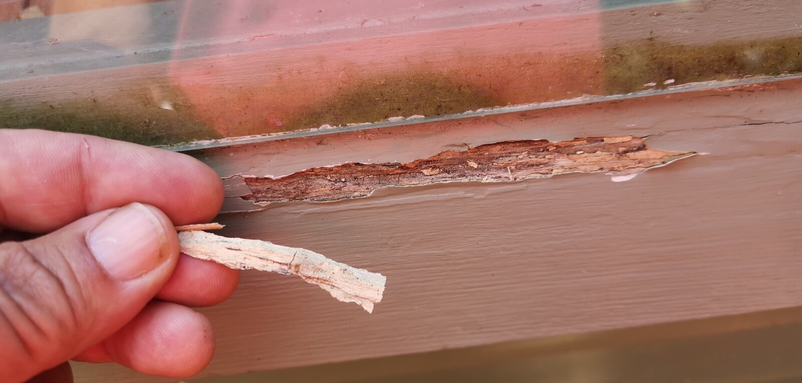

The putty isn't blistering, it's the paint which is clearly illustrated. I'm over the putty now but it's getting personal with the paint and "Everbuild" so called wood filler.

Mold and moisture can affect paint severely. Apply undiluted thick bleach using brush in all areas you intend to cover. Use multiple application as needed. This will kill anything biological. Then fill, prime, and paint. Primer is a glue that enable adhesion. Even so, it will struggle with smooth sanded 2 pack wood filler.

I don't remember your mentioning primer before. I presume you don't use it which is a huge mistake.

Your image seems to show you holding a bit of rotten wood that has come off. Is this falling-off what you are calling “bubbling”?
Paint is not going to cure rotten wood.
The “wood hardener” products might; I’ve never tried them.
Wood hardener is basically a water-activated polyurethane compound. It works by sinking into the timber grain and where it comes in contact with water, it catalyses.
A problem is that it has to be used correctly, i.e. ALL rotted/punky (soft) wood needs to be scraped and wire brushed away BEFORE applying the wood hardener. After use it is normal to build up the timber to the original level using a 2-pack epoxy wood filler which is sanded and filed to shape after it has thoroughly set. I don't know if the OP did this - if he didn't then it won't work

I used Ronseal wet wood hardener on the rotten wood after I scraped the loose stuff out as it states that it turns rotten wood hard. I then filled with Everbuild wood filler (a single tube) sanded when dry and primed. Then painted with Weathershield.
