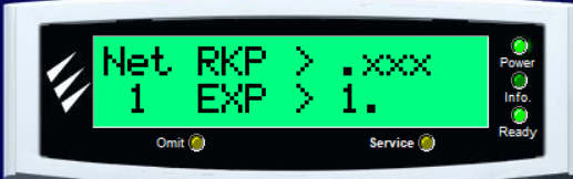

I set the address to 5 and the system doesn't like it keeps asking me to confim the devices it shows the key pad as X. I thought that i had set the addressed correctly i.e. Expander address 1, key pads 2, 3 and 4. It seems that the keypads can only have 1 to 4. Can the expander and a keypad have the same address?
I set the address to 5 and the system doesn't like it keeps asking me to confim the devices it shows the key pad as X. I thought that i had set the addressed correctly i.e. Expander address 1, key pads 2, 3 and 4. It seems that the keypads can only have 1 to 4. Can the expander and a keypad have the same address? Correct me if I am wrong, on the dip switches, up is on.
I think that may be the issue, I've got the dip switches the wrong way round. I'll change the keypads now.
Nope, it looks like the addresses were correct the system is not happy now.
I'm Going to put the address setting back to where they were and start again. One question, Should these keypads be assigned to a zone?
3 keypads … set keypad one to address 1
Keypad 2 to address 2 and keypad to address 3 …. Normally it switch one on up for keypad 1 etc
That is how I had them set initially, however I started with 2 because the remote expander is set to 1 is my logic wrong, can the expander have the same address as the first keypad
the dip switch chip should have an on side.
address 1 is all off or dip 1 up
address 2 is dip 2 up
address 3 is dip 3 up.

Right my problem is that I assumed that I could only have unique address numbers. We are now cooking with Gas. Thank you for you patience I have a reasonable knowledge but at the age of 79 and only doing this to help out a neighbour I get the odd thing wrong. Once again thank you very much for your assistance/
