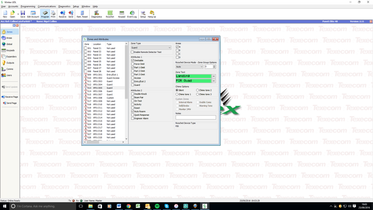

Hi HandymanJo - I am using Wintex and have all devices in area A and all but the landing and hall in area B. So in Wintex when I get the 'Zones and Attributes' page up: for everything but the hall and landing, Areas A and B are ticked and C and D are not ticked. For the hall and landing only A is ticked.
Go to zones
Put all devices in area A
Make all device guard except the device you want go start entry exit
Put tick in part set 1 for landing
Make hallway guard access
Take screen shot zone set up so I can see config
That's correct

jdp80 - I just checked the Expanders on Wintex and only Expander Area A was ticked - I guess that was the issue? - as I am now going to use part set instead then I wont pursue this but at least I now know why it wasn't working
