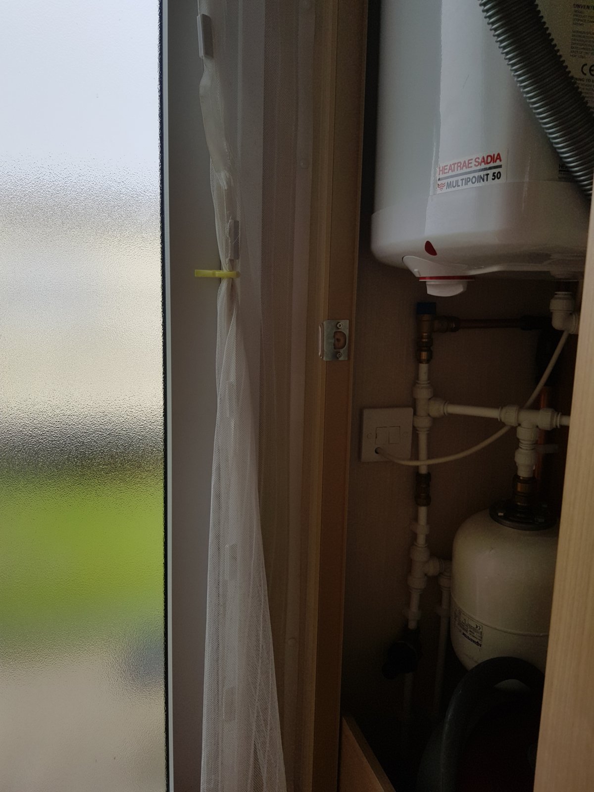

Just to update you, the thermostat on the boiler works. I turned the temperature dial up, the red light came on to heat the water, 5 minutes or so later the red light went out.

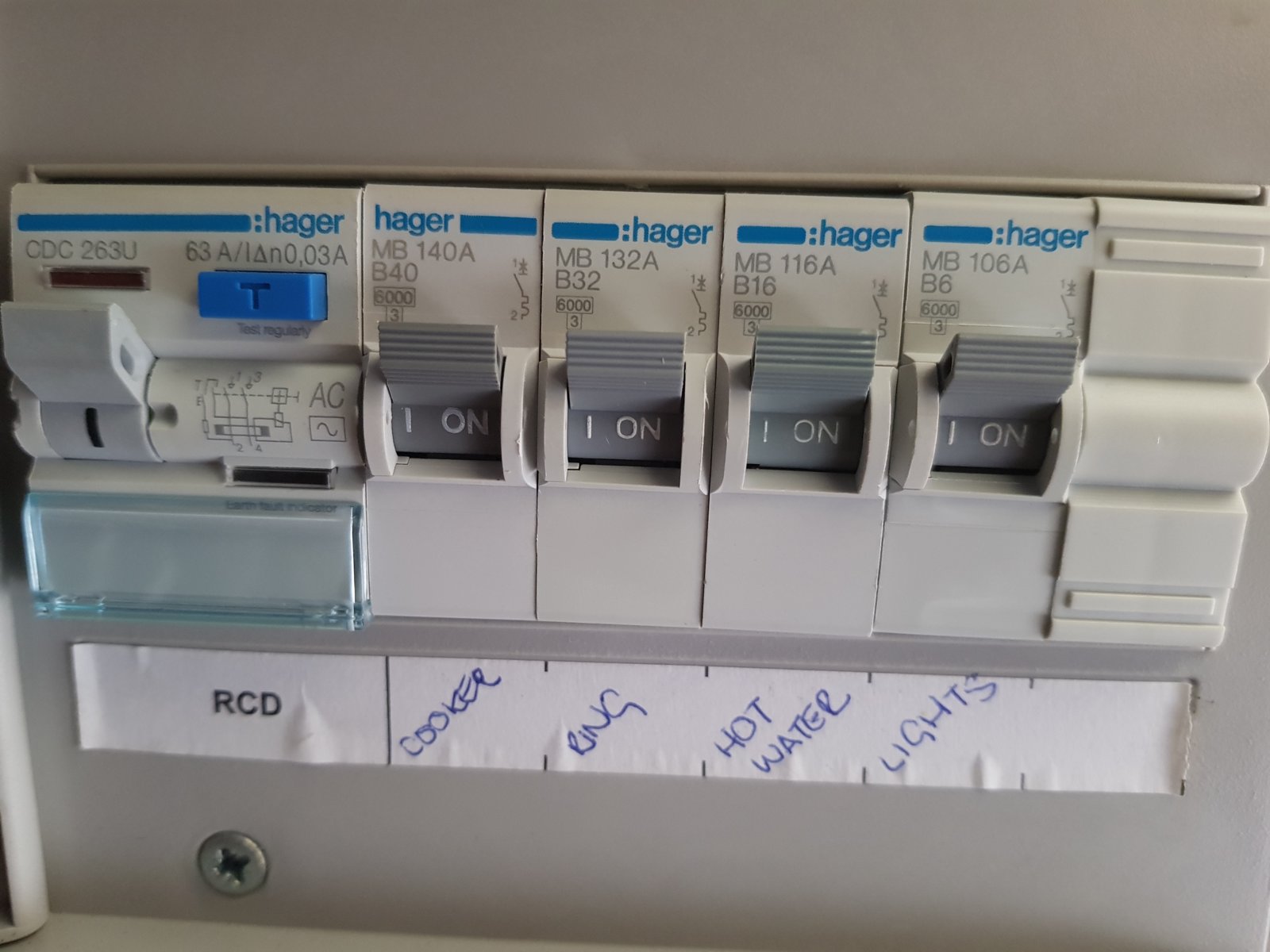

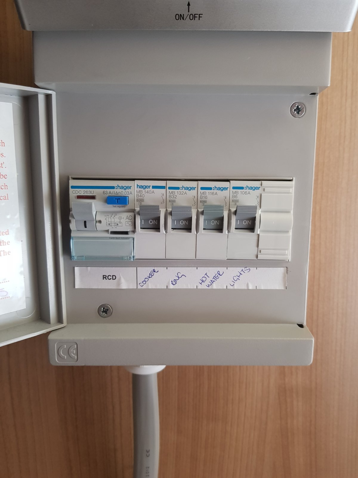

I have attached a couple of photos of the fuse board. The MCB marked Hot Water is the boiler, which looks like a 16amp fuse to me?????
I have also noticed that the 13amp FCU is fitted inside the boiler cupboard and recessed in to the external wall using a back box. The front door is next to the boiler cupboard and if you shut the front door with a little bit of force then the wall shudders slightly. Just thinking along the lines of what was previously mentioned about slightly poor fitting fuses inside the FCU and being exacerbated by being sited 20cm from a slamming front door. Picture attached should show/explain this more clearly.
P.S. Not sure if the fuse is fake.......apologies for misleading anyone, but you all sound like you are enjoying the research opportunity. Your knowledge and help is appreciated.
Yes 16A MCB (not fuse).
You could replace the FCU with a 20A switch.
Could be. It won't help.
Just make sure the terminals are done well and tight - and the fuse holder.
