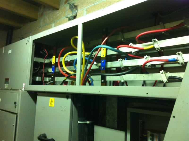

800amp fuses protecting a busbar, and then 16, 25, 35 mm etc feeding 63amp, 100amp etc switch fuses bushed onto the busbar chamber.
Doing a periodic inspection I have come across a busbar which had limited space around it, so they have terminated SWA into the busbar chamber and run this for no more than 3m to a switch fuse, and then SWA out of the switch fuse.
I do not like this, and without double checking the regs, I think this is actually OK......
Thoughts?
On the same job there are actually a few SWA's terminated directly to the busbar chamber which feed TP boards across the site - no switch fuses installed. These are obviously non compliant.
What size is this shorter SWA. Will the 800A fuses provide adequate fault current protection for it ?

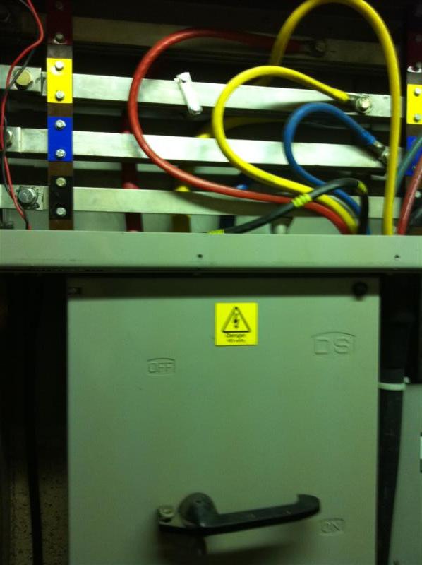

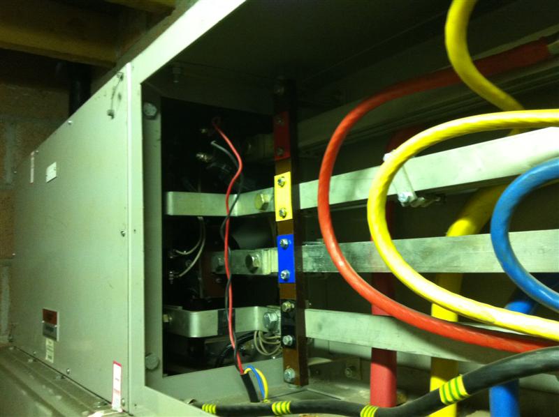

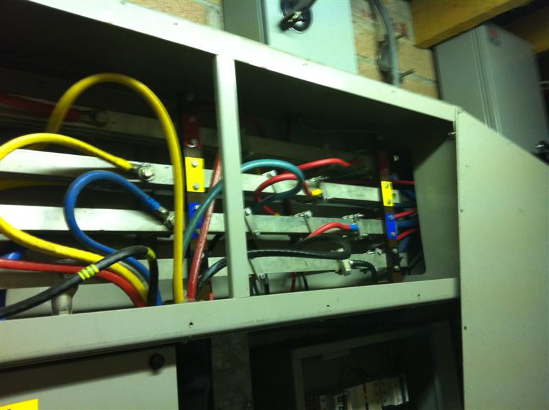

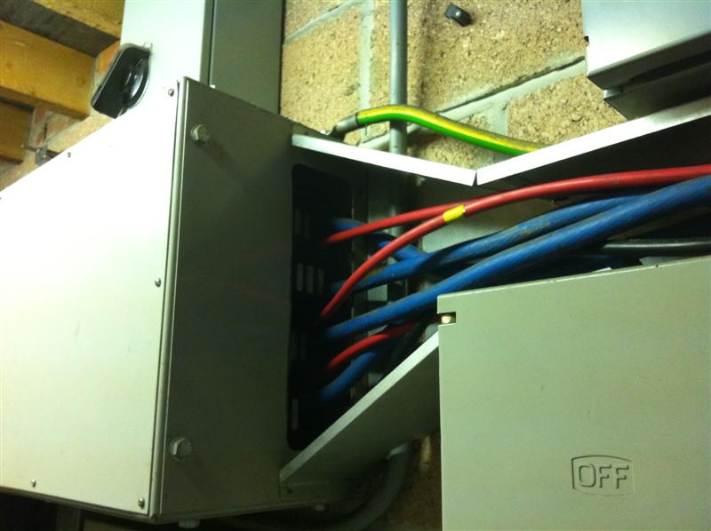

The conclusion was actually a new 800amp MEM MCCB board, an 800amp generator transfer switch, some 300mm galv trunk and some 240mm tri-rated singles (doubled up).
Oh, and a few days prep work followed by a full saturday shutdown....
I am still on site doing other works, so may take some pics.

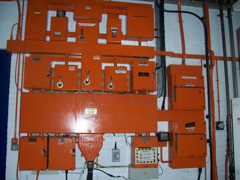

Nice...though does not look quite as impressive as a long line of switchfuses mounted along the top of a busbar :P... busbars are a dying way of doing things these days due to the time taken arn't they?

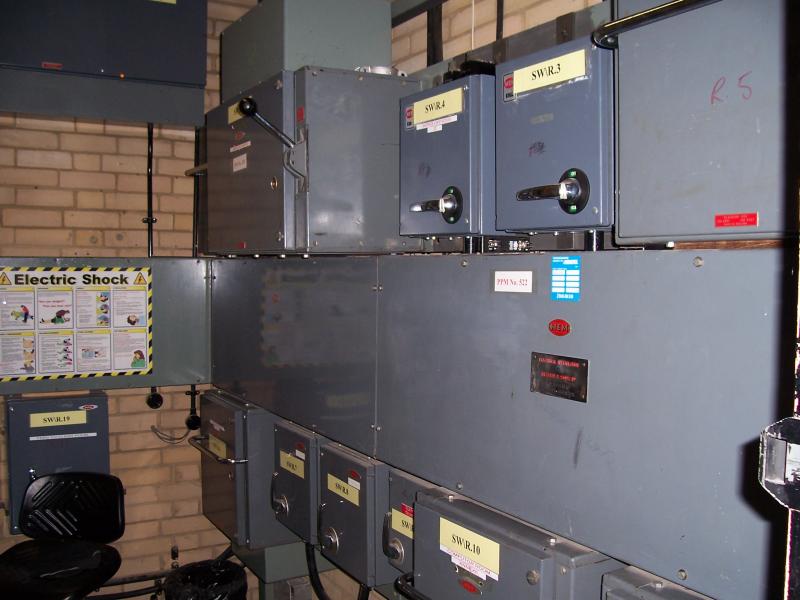

Nice bits of kit Ricicle, MEM glasgow chambers if i'm not mistaken, nice orange paintjob on the second one (I still paint the conduits in school workshops orange!).
For me its the cast iron stuff from the era before sheet steel thats really impressive, always loved the ornate art deco decoration of Bill, Simplex, MEM, English Electric etc, for that matter ever seen the control room at Battersea :D

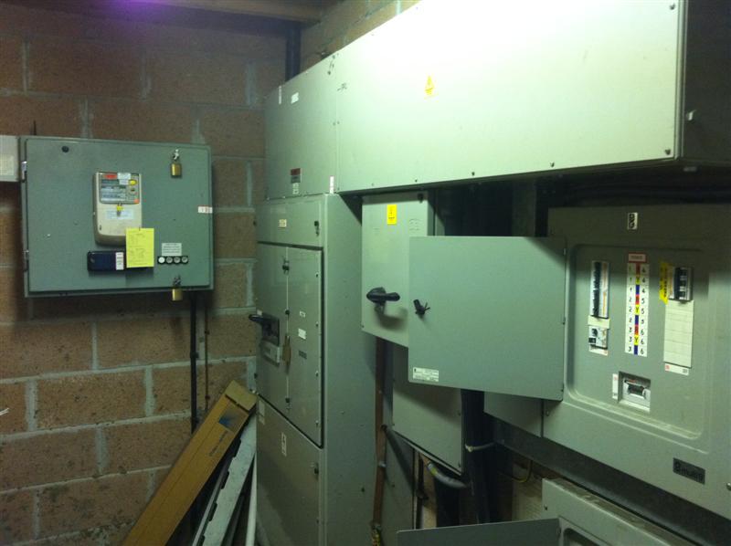

Not got any pics of the new kit yet - but here is what was pulled out.
Dorman Smith eh. , don't see much of their stuff round these parts, replaced some of their sockets last week, I think they are a Manchester outfit so perhaps they sell more up north. Mostly MEM and Ottermill-Simplex round here although I encountered Mitsubishi boards and busbars in a school the other day, never knew they made DBs
A lot of their older stuff says its made in Preston, so not a million miles from manchester
It seems to often be used quite extensivly on educational sites, due to being specified by the local authority.
Their new stuff is pretty good I think, the neutral block covers arn't great and the terminals on the RCBOs are a little naf, but other than that the boards themselves are pretty solid
Lec, thats the same site as you posted a pic of a while ago wasn't it, with the live ends of the busbars exposed due to badly fabricated trunking work?
