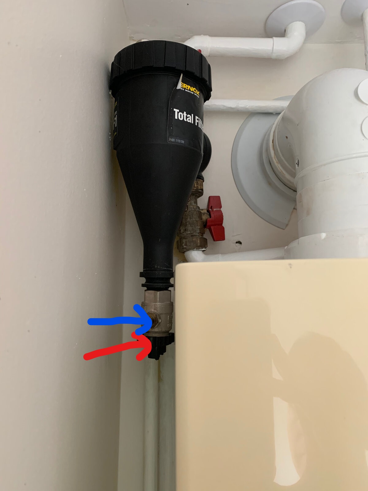

This is our Fernox TF1, which was professionally installed for us a good few years ago.
The plastic end cap is also intended to serve as a key for the brass drain valve.
Space is very tight due to the position it's been installed, and the plastic thing is not easy to fit and turn with your fingertips in this tight space. The valve profile looks like it has two round faces and two flat faces. Is this the same as a red stopcock handle?
Can I buy a tool with a longer shaft to make it easier to open/shut?
unscrew the part marked in red , then fit it into the valve marked blue, that is how you open the valve

The drain (ball) valve can be quite tight, you can use a adjustable spanner on the flats to turn it 90 deg far more easily except access is exceptionally tight.
Yes, I know that. I've drained it several times before. It's also important to switch off the CH/HW, close the top and bottom valves, and remove the magnet first, and have something to catch the outflow!
Yes, I've managed to get a small Bahco on it before, but it's awkward as the handle is angled to the jaws. l would like to find a better tool. Is it similar to any other plumbing fittings?
