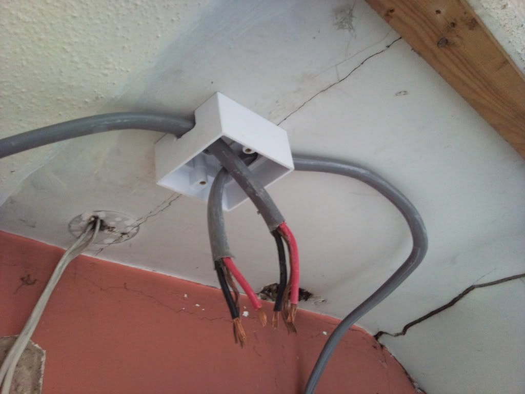

We had a false ceiling in the bathroom. It hid a multitude of sins. Its been taken down. I have to re-fix the shower isolator to the main ceiling (it was originally here when this was an airing cupboard). This is a temporary fix. Eventually the whole bathroom is being refurbed, and a new ceiling put up. And we need a shower in the meantime!
But. See my pictures for what I have found.
How the hell do I dress these 10mm² cables for connection to the isolator?
Burnt wires inside shower. Worrying. But we are scrapping this shower in a few weeks. Very very annoying. :( Would you chance it? :(
Cheers
Is the shower circuit rcd protected ?
If you don't know how to dress the 10mm TE are you wise to consider terminating it?
Dress live, neutrals and earths/cpc (with sleeve) so they are formed to drop in to the respective terminations. Do not have the whole cables over lapping each other.
Prior to terminating, put a 10 deg bend on the cores to help make an elbow.
So when the faceplate is offered up to the back box the cores fold in a bit and should allow closure.
You find the deeper the back box the more space there is, with shallow boxes you may end up having to pull surplus sheathed cable out the box cable entries as you close in up.
When cables drop down from a ceiling, that allows the cable to push up and back in to the ceiling as you close the plate to the box.

I have connected all cores to the switch now. Going to try to offer the switch to the box. I will probably end up with cores sticking out the sides. But its only temp untill we get a new ceiling.
This is a 45mm box, are deeper available??
I was surprised to find two screws on each terminal when I removed it. (I was also surprised to find no burnt cores in the switch too :lol: )
The round Crabtree isolators are a bit easier to terminate into, so consider those for next time.

little tip for those terms with 2 screws- when you put the wire in the hole, tighten the second screw up first, give the wire a little tug, if tight, then tighten up the first screw.
You've found 10mm² twin & earth, i.e. what you'd have if you'd installed a new circuit from scratch.
How is that any more of a puzzle than if you'd put the cables in?
Err - cut them a little shorter?
