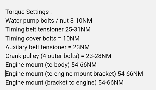

Since its @ 48k miles and the recommended change is 54k miles, I need to prepare to do the change.
Can any Tipo experts quote the torques and special tools needed please?
Will likely fit a Gates belt kit. I've had Gates part no KP15503XS-2 quoted to me.

For the water pump, I'd say 5Nm since that's was official for the water pump when I did my Bora TDI belt change.
I inquired on the Forum website so perhaps I'll get feedback.
Also need to establish if the shafts need to be locked before the belt comes off. Its a single cam so not too complex.
Regarding torques, all the tyre centres torque wheel nuts for liability reasons but that's a another story.
Do you know the thread size and pitch? There are standard tables online for recommended torques for threaded fasteners. If the water pump bolts are (say) M6 x 1.0, 5Nm would seem a bit low? Depends on how much thread engagement you have though.

Regarding the water pump, I presume its replaced it as with VWs when fitting a new timing belt.
The Gates belt kit includes the pump whereas the Ina offering is only the belt and tensioner, the pump being a separate offering.
If of interest, a YT video for a similar belt change quotes these torques.
