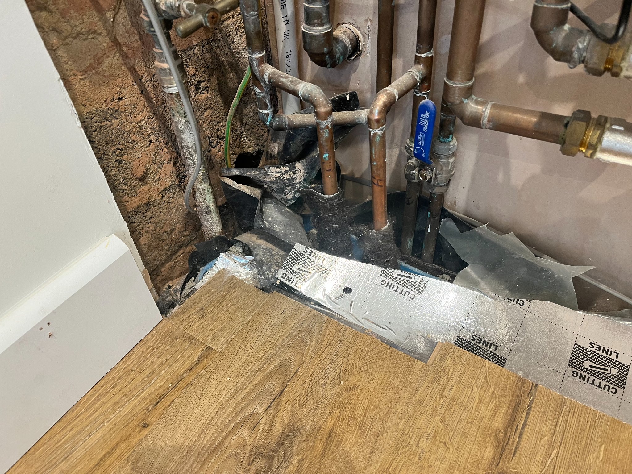

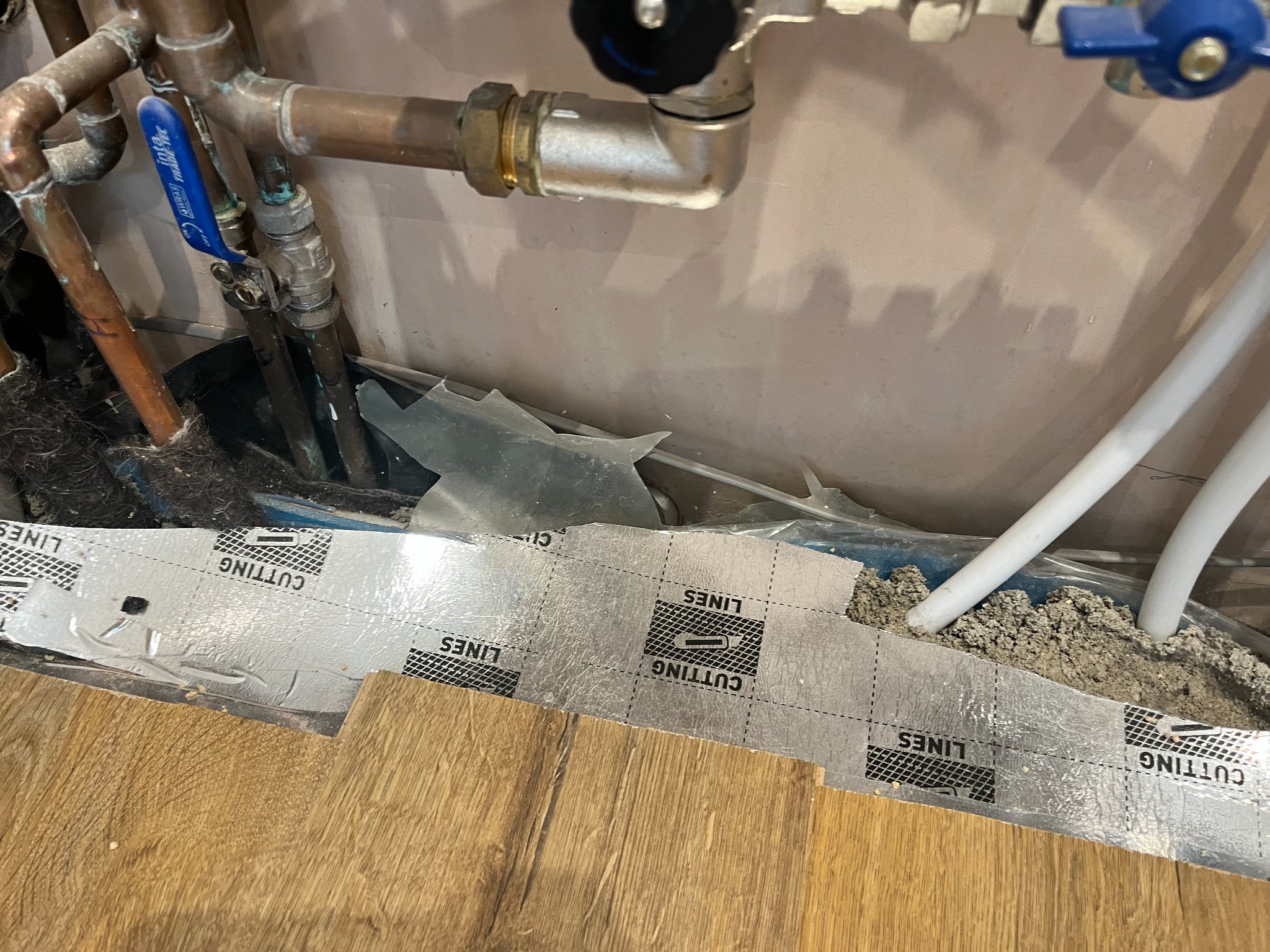

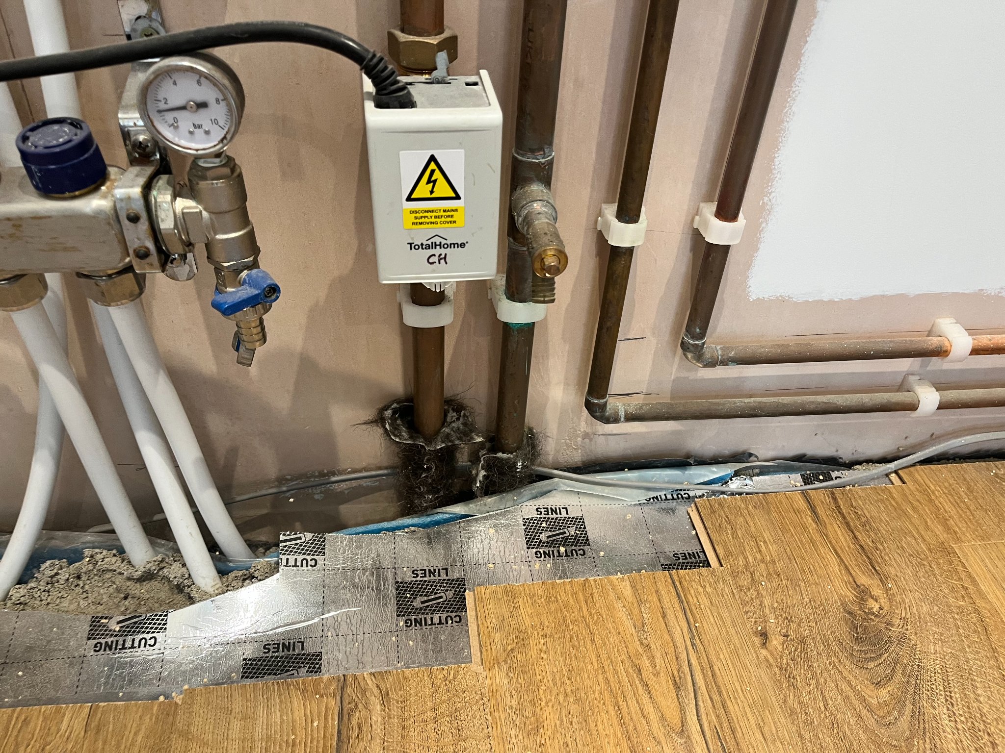

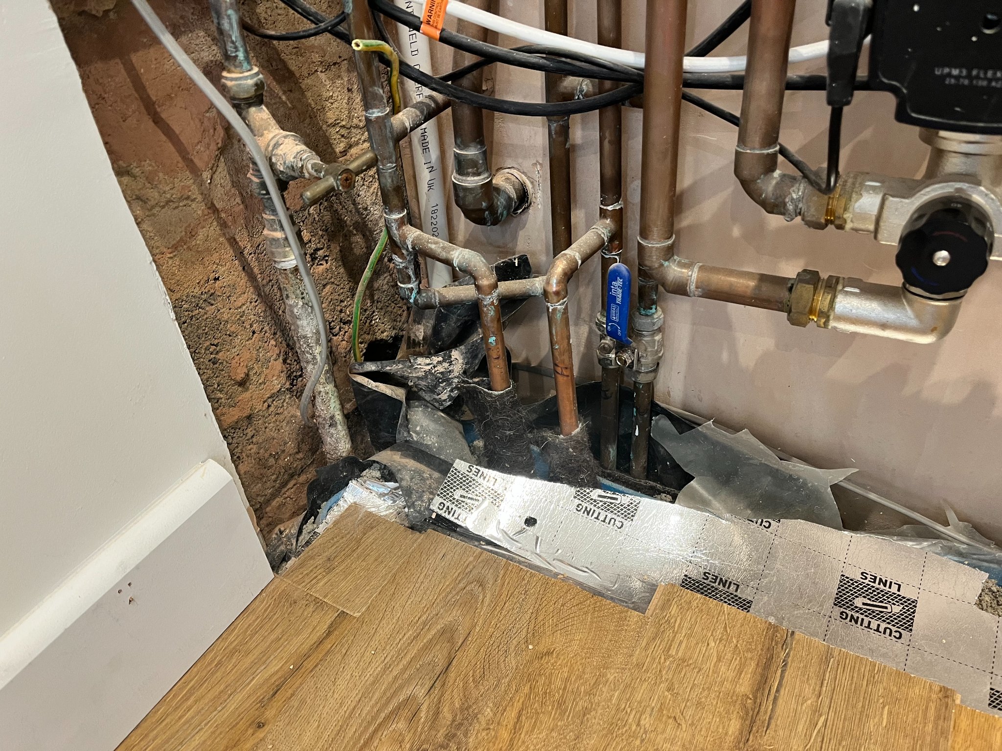

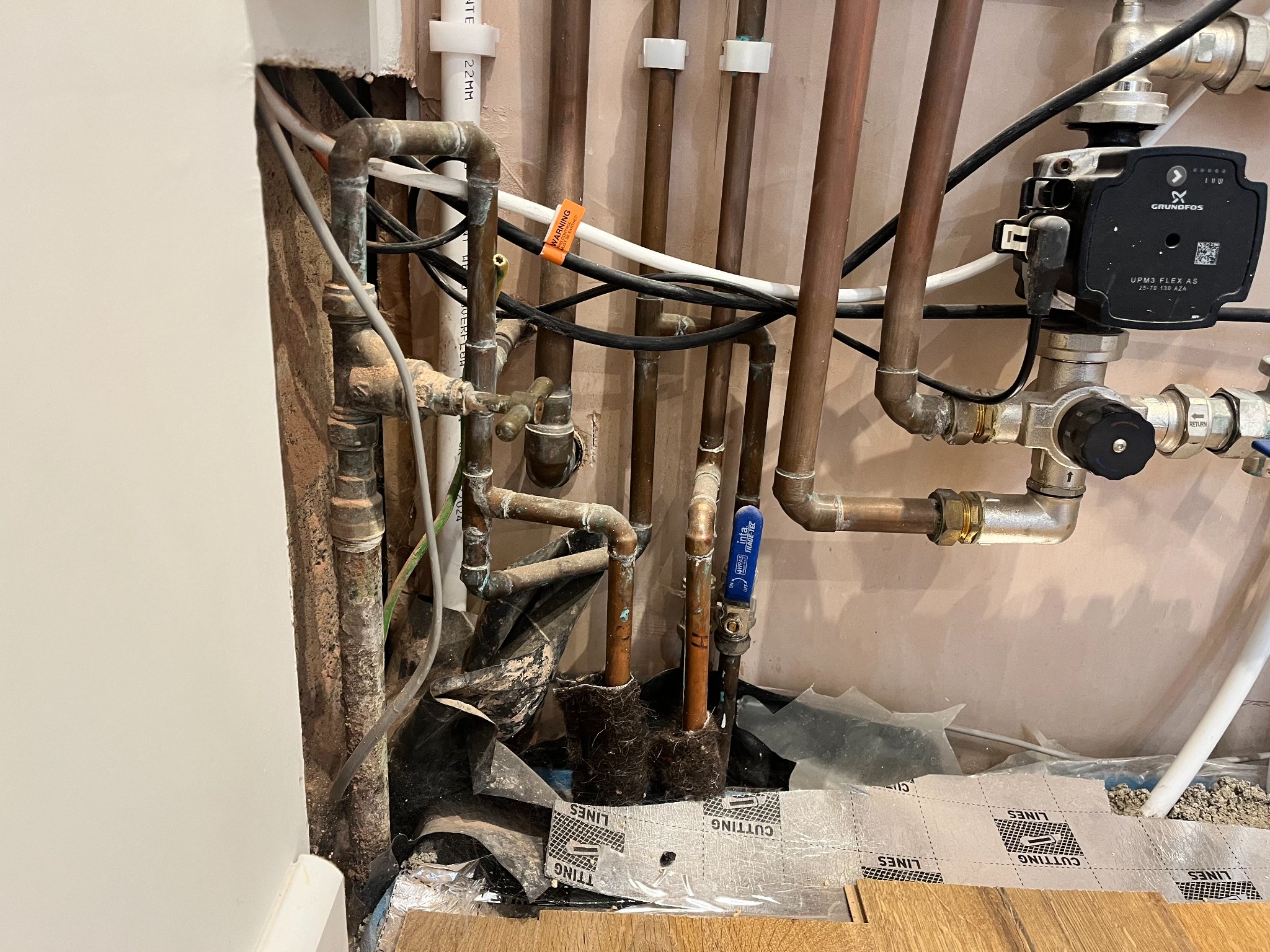

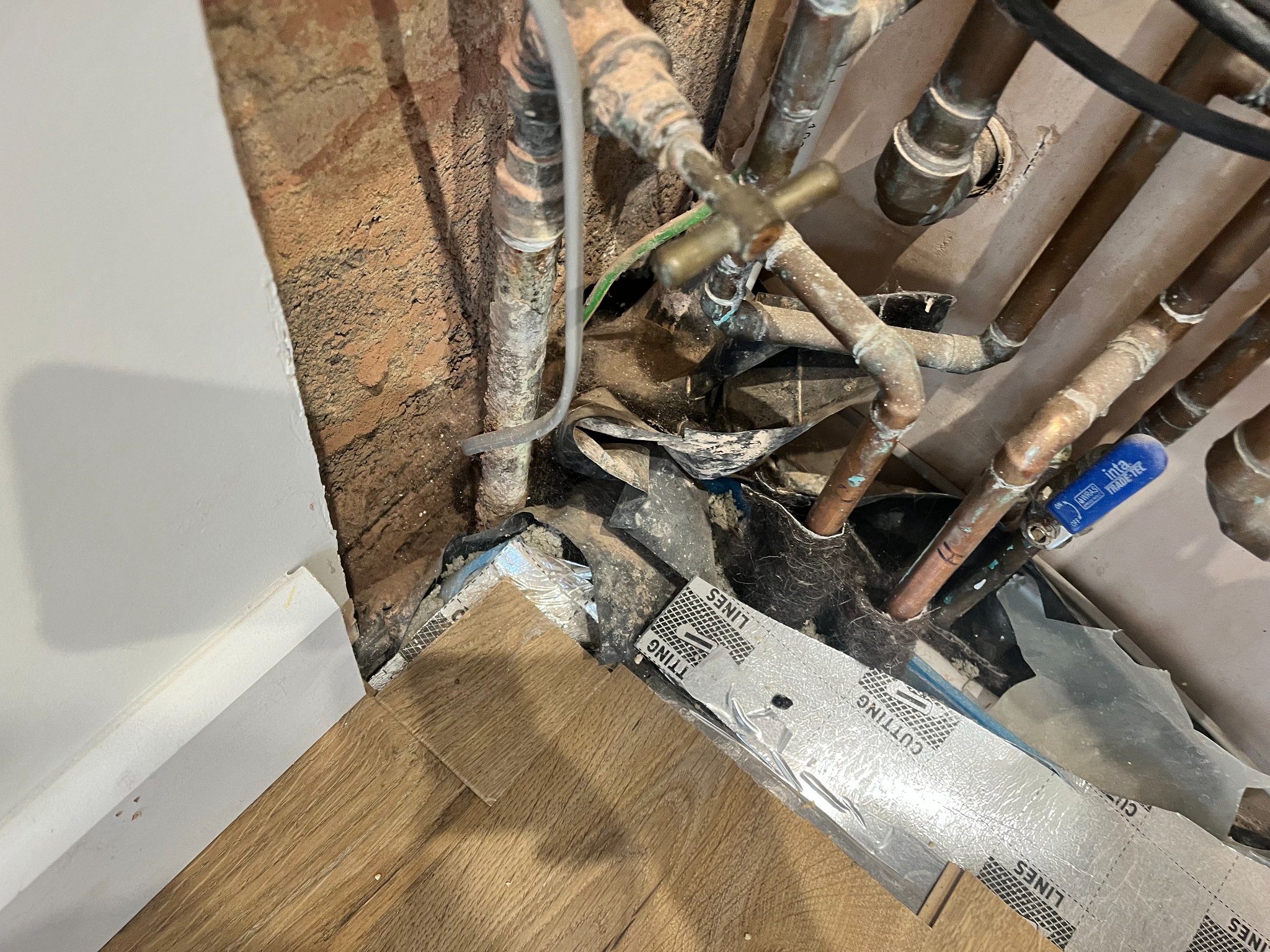

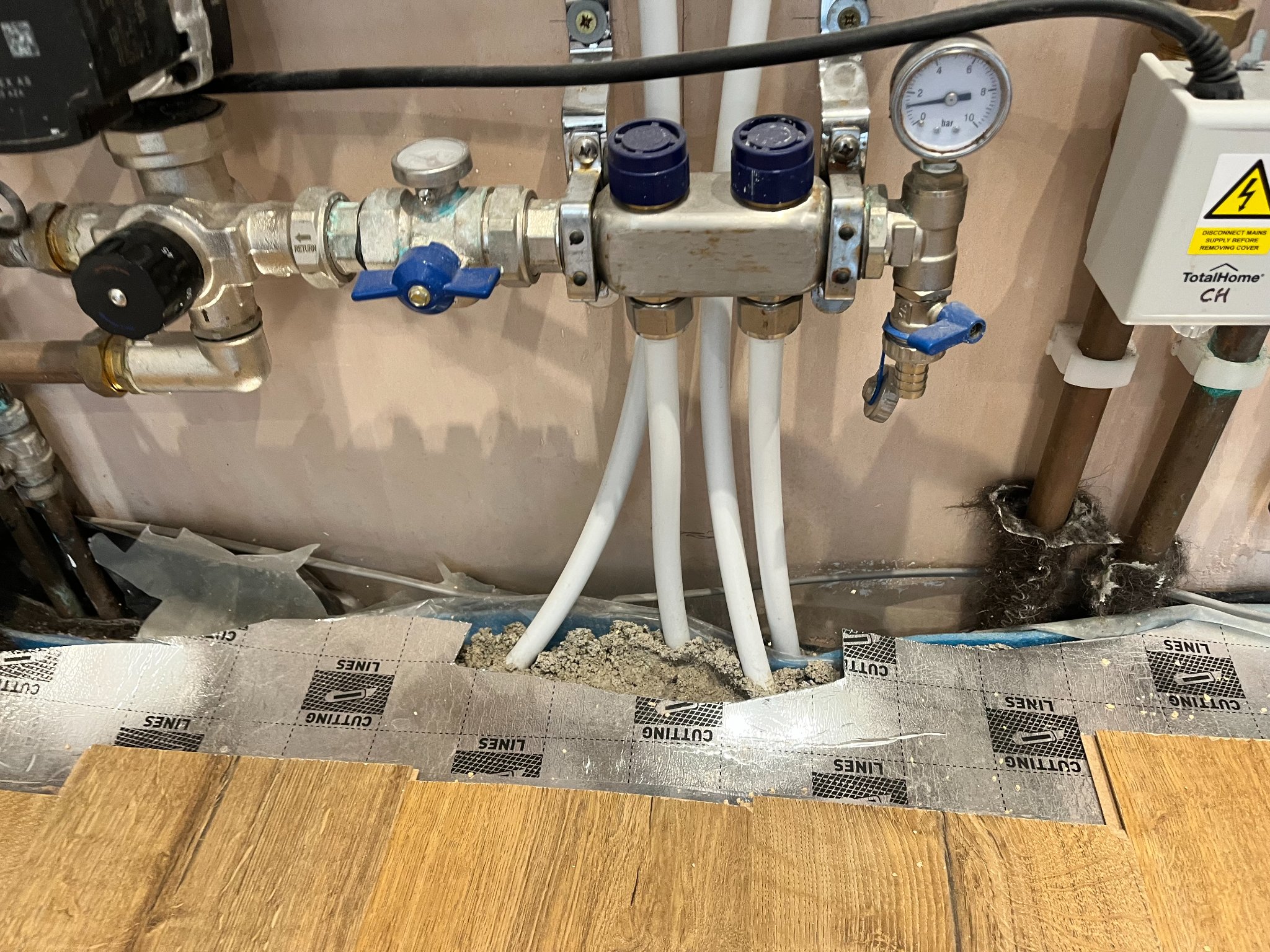

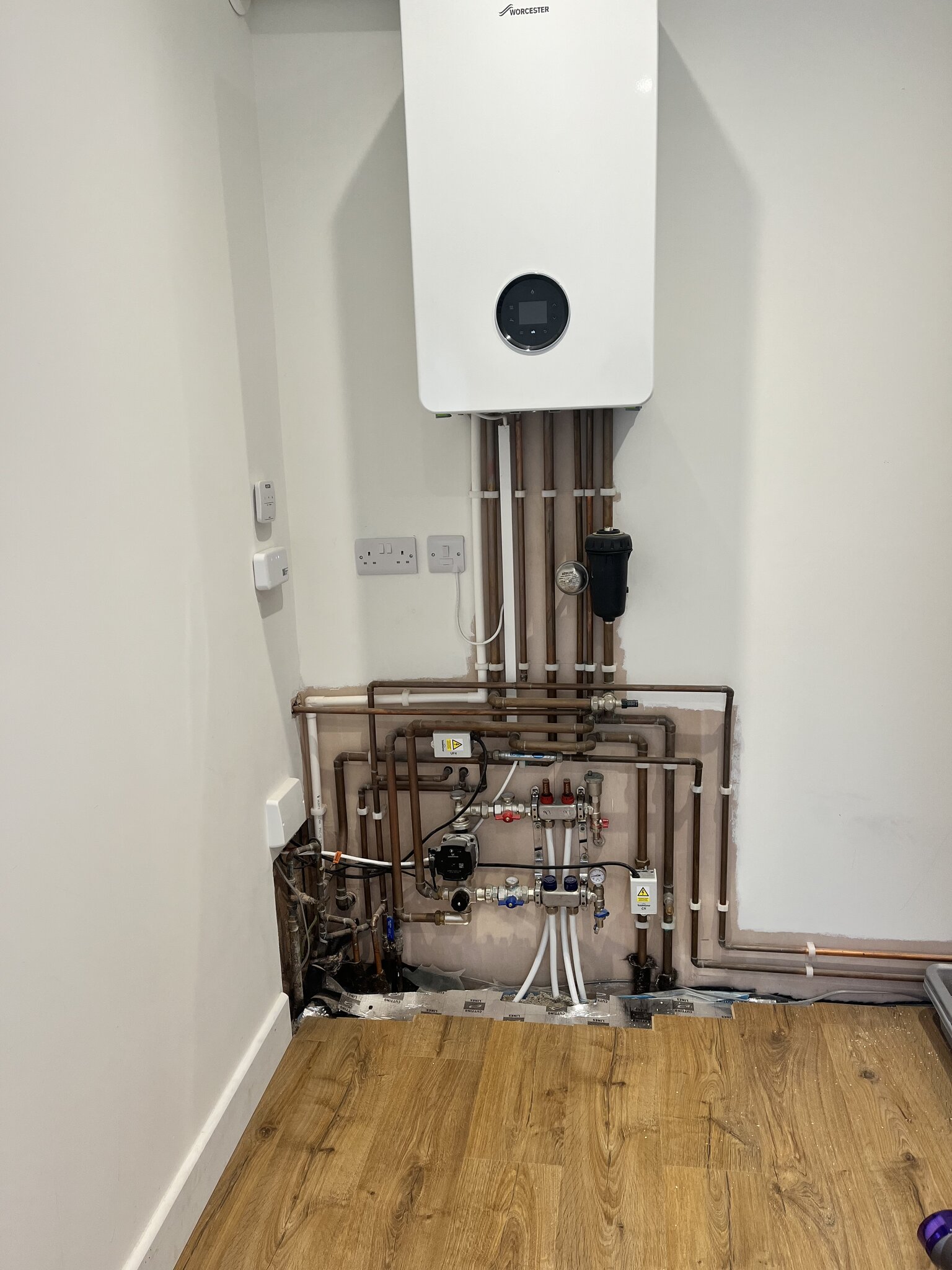

Hi all,
Looking for some advice on the best way to fill and seal gaps around mains and boiler/heating pipework to help prevent insects or rodents from getting into the house.
The builders poured the screed but left a gap around the pipes and the plasterer didn't plaster where the mains pipe was in the way, so there are now various gaps and voids around the copper pipes where they come through both the floor and wall near the boiler/heating manifold.
Because of the pipe layout, we also can’t fit normal skirting boards in this area.
Photos attached.
What would people recommend to fill/seal the gaps and achieve a reasonably neat finish around the pipes?
Also would like to be able to hide this (while keeping easy access to the different parts) mainly to prevent risk of toddlers going in there and turning the knobs and levers.
Would appreciate recommendations on the best combination of materials and any neat finishing ideas others have used in similar situations.
Thanks!

Not very tidy that.
Think I would buy some spiral cable tidy sleeve and use on cables. You don't want them sitting against pipes.
You also need some pipe lagging insulation especially around the floor area so if you fill in floor the pipes will have some give.
I think i would use the cable tidy and lagging held with a few zip ties.
Then some low expansion foam. I would use a cheap foam gun Vs all in one cans and go slowly to keep it tidy. Build it by adding a bit every 15mins.
You can cut back foam carefully with dry if you want..
Tip. Have some foam cleaner to hand.
Don't dig or scratch the foam gun end. Use the foam cleaner but only when foam is wet. Foam cleaner don't work on dry foam.
Have a practice outside with foam gun. It's a simple job..
Is that a cupboard? Put a lock on. You have options.
Swap handle for a bathroom locking handle. That's easy as a straight swap. Child locks up high is another option
If any of those pipes are gas pipes then cables need to be 25mm away or have separation of some kind, eg a partition.

Thanks so much for your reply, yes it was done by professionals but I agree I wished it would have been tidier as they had a lot of space available as the whole room is new with new partition wall where the boiler is.
I believe the gas pipe is the thicker pipe coming from the wall in the middle of the last picture, so it has cables close to it, it looks like they just didn't want to order longer cables and made it work this way... I can use cable tidy and zip ties but not sure if that's ll be enough to keep them 25mm away from it.
Regarding the gaps I'll try your suggested solution thanks for your explanations.
It's not a cupboard, it's a room like a larder type room where we also have a side door to the house. I might try to put some shallow kitchen unit to hide it all while making it still easily accessible, also less tempting for young children to access if not visible.
Foam normally sets in contact with water, so using a plant sprayer with the foam helps control the expansion.
I’d be tempted to get a kitchen wall cupboard and fit it over all those pipes. Make it without the back, and relieve the base for the pipe work. If you can get the same as your kitchen units, and cut down the same worktop as in the kitchen, it can look good.
Mount it so there are brackets/buttons in the wall probably best to make it reasonably removable for plumbers
and then fit the doors either by screwing both together as a panel,
or mount as normal, use a bolt to the top/floor and fit a cabinet lock to the other.
Box in the pipes to boiler using something like the kitchen cupboards, or a decorative infil panel?
Worst case use some contiboard.
Again, for the boiler pipes, make sure that it comes off easily.

For the gaps, pack them with stainless steel wire wool first so rodents can't chew through, then top it with a flexible, heat-resistant silicone or acoustic sealant so the pipes can still expand. For toddler proofing and hiding the mess, building a simple, removable plywood boxing or a small wooden utility cupboard with a magnetic latch is probably your best bet. Keeps the kids out but gives you instant access.
