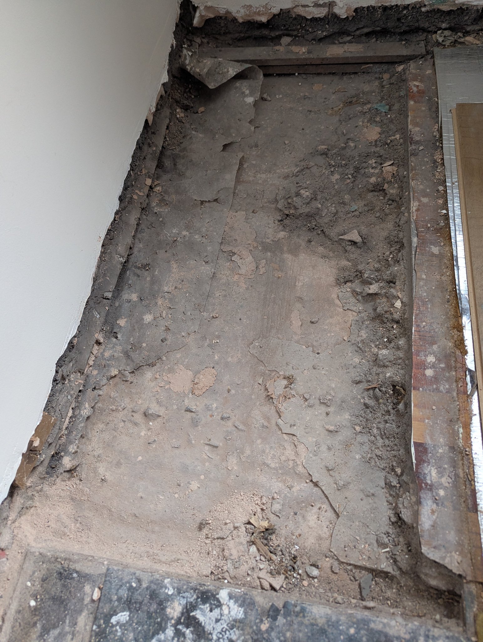

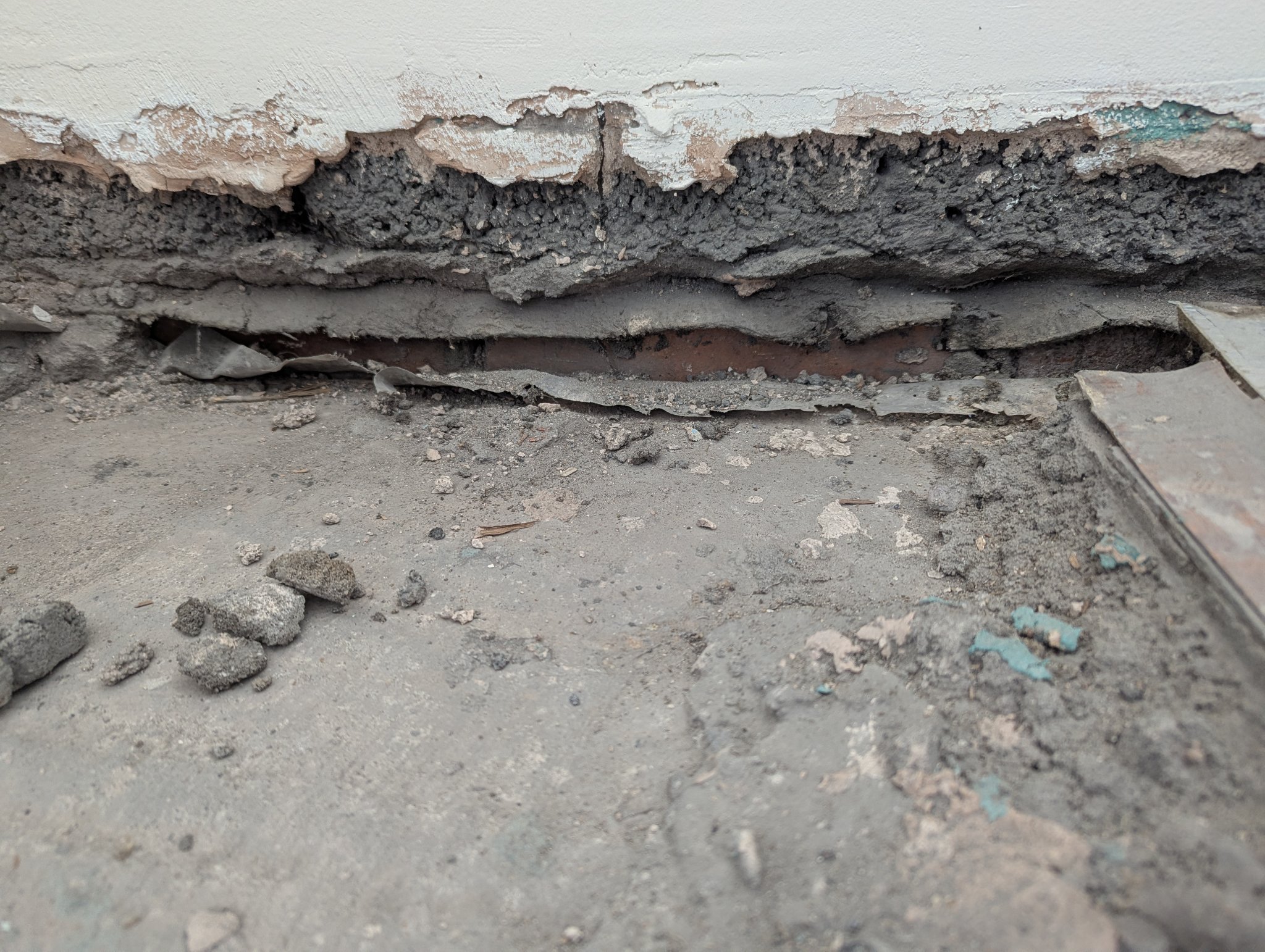

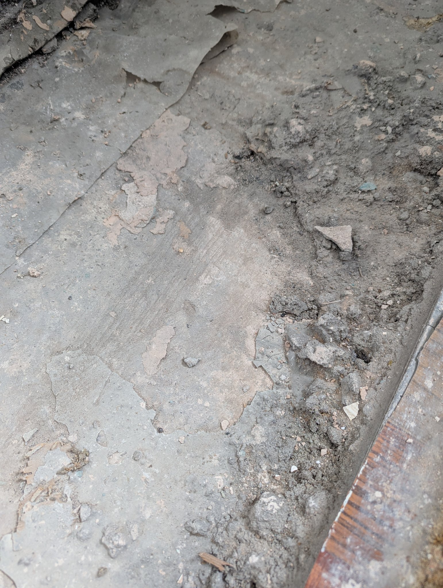

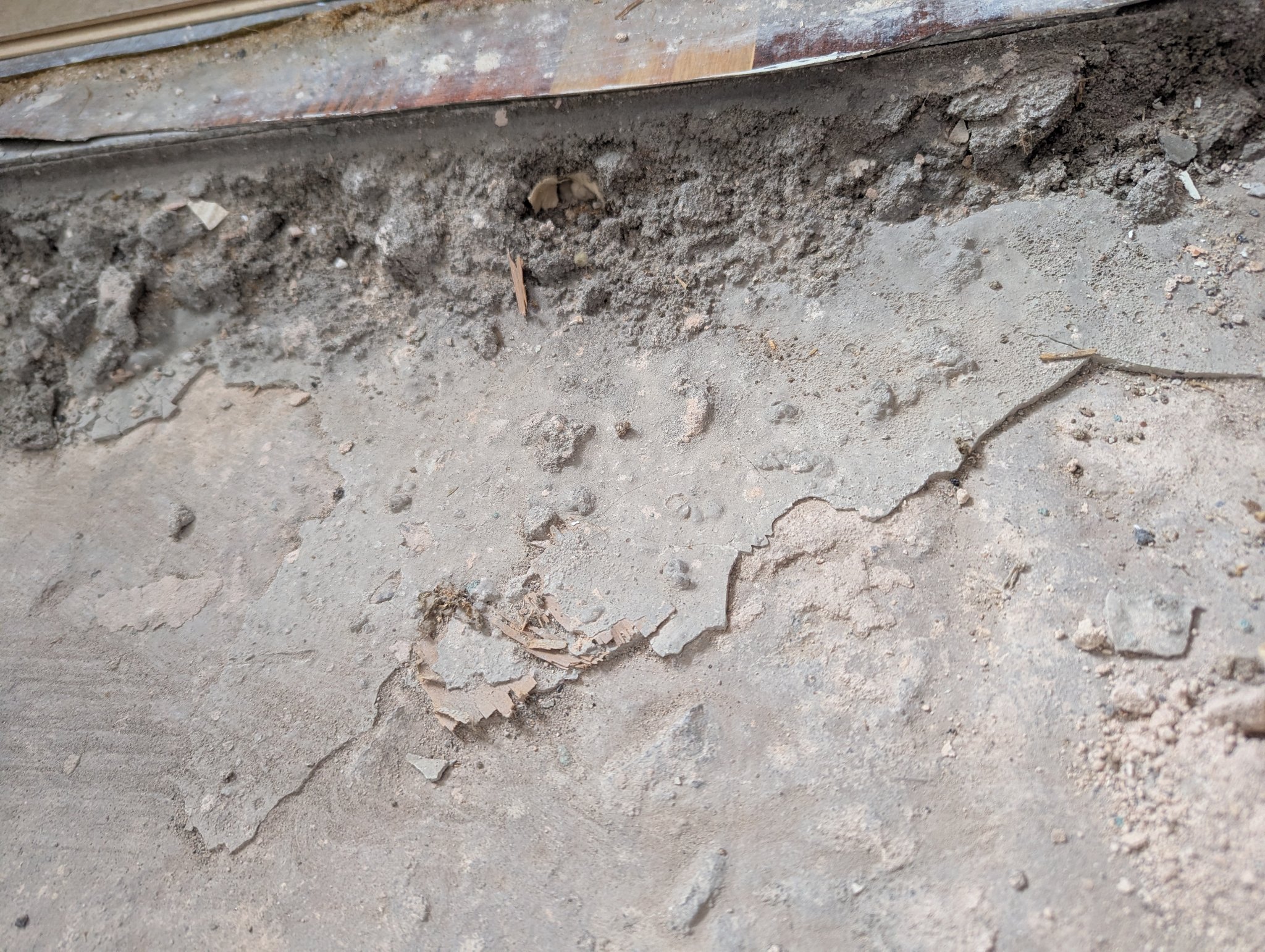

Hi, looking for and advice as to how to proceed. Read the guides but the hole might be too deep at max 60mm.
Removed a kitchen and the subfloor wasn't level under old sink. There's a rectangular hole roughly 1100mm x 500mm x up to 60mm. Original DPM has deteriorated, brick is visible on outside wall.
Im unsure of order of operations and where to place a new dpm. The hole is too deep for normal self leveling and maybe too shallow for standard concrete. Plan was liquid dpm with a sand mix, prime, deep fill self level, prime, smoothing compound. But unsure about outside wall and bitumen.
Advice appreciated.

Vacuum off.
SBR and cement mix and brush on to seal and bind surface.
Give that half hour to dry off a bit.
If its fairly smooth place DPM plastic over.
5-1 Sharp sand and cement.
As it sets after 3 hours or more wet surface and polish off.
After sealing with SBR and cement you may see sharp bits that could puncher DPM so you need to smooth over with a bit of sharp sand and cement prior to placing DPM over. This is why I think it's a good idea to seal.
You don't have to seal as you are placing plastic over...
I've just used PVA in the past to seal...
You can easily get a depth of 50mm with sharp sand and cement. If it's deeper do in two goes
Thanks for the reply.
I think some of the sharper bits may puncture a plastic dpm, so I'd be happy to seal with sbr and raise it up with cement. I'd just read that under 50mm depth of cement wasn't recommended.
Should I leave a gap around the edges or go right up to the bricks. Cheers
Mix a 2 handfuls of cement with 1lt of SBR to make a slurry mix. Same used on slabs to seal the back.
Good sealer and bonding mix.
Sharp sand and cement 5-1 although sometimes I mix 4-1 whatever.... Not really any noticeable difference when set..
You can build up 50mm.
If you want more depth give it a good hour to set a bit and hit it again with another mix on top..
