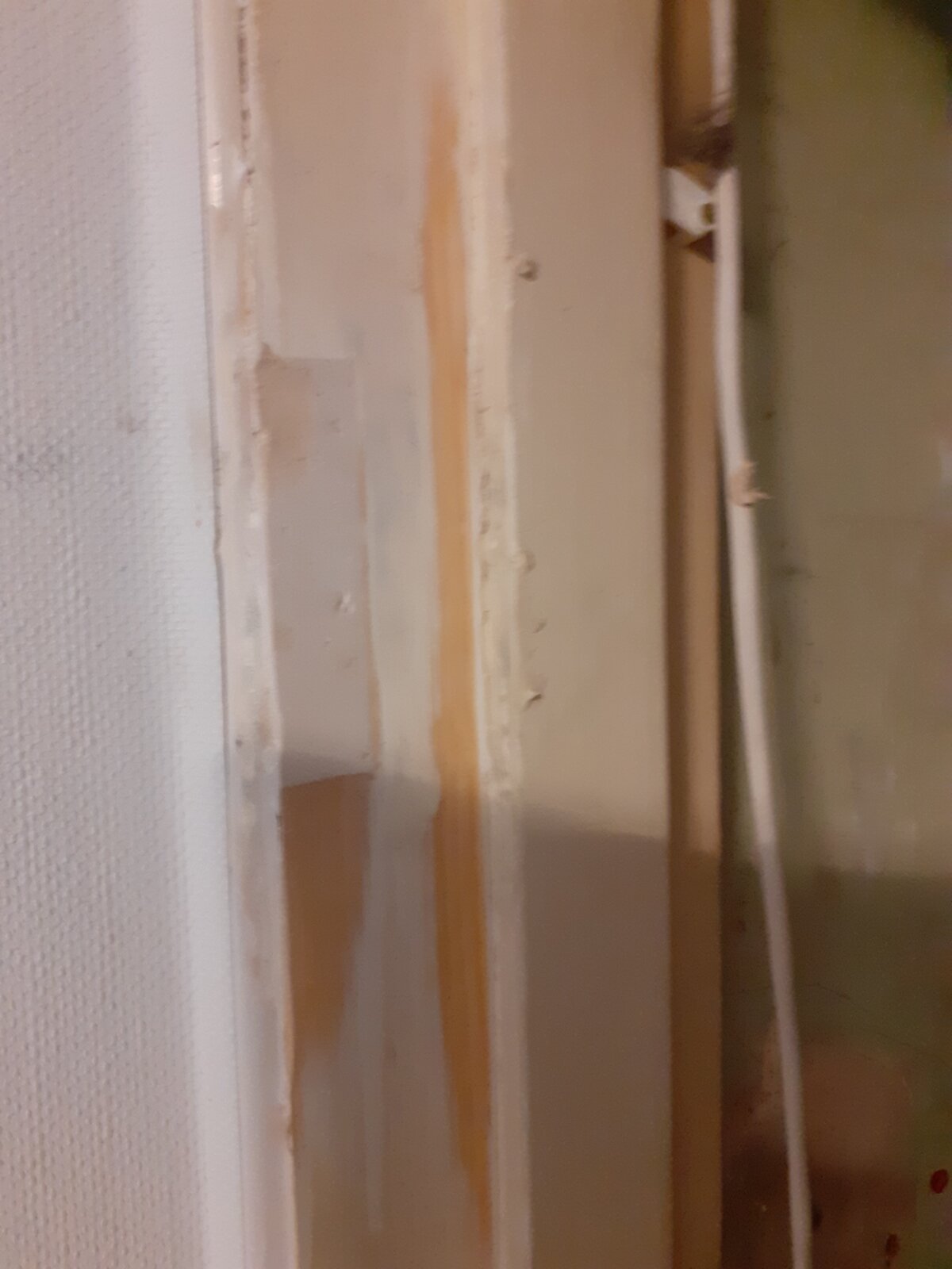

Should I fill the old hinge recess which had a butt hinge in with two part filler then screw in flush hinge over the top? Putting a flush hinge below looks tacky. As recess will be seen. Think flush hinge is appropriate for new door.

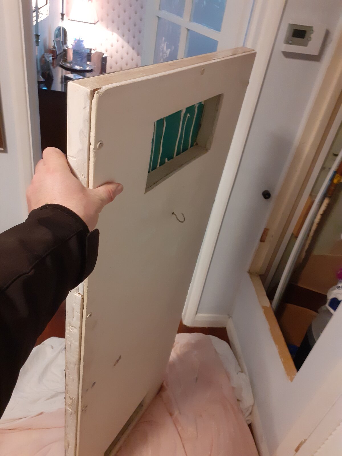

Already done it lol. Oh well. I thought be wrong to chop out on these slatted doors. Forget what they're called.
Also, It's a bit wide I'll plane both sides rather than just lock side. About 3mm to take off
It's called a louvre door

I know you're a decorator. How long before two pax filler is hard enough to sand and drill into? Might go over it again
The thicker the layer of two pack filler, the faster it cures (because of the heat generated). At 20 degrees C, I would wait 40 to 45 mins before sanding or drilling a thin layer. If 30 degrees, about 20 mins. More catalyst will increase curing and in most cases not cause any problems. The same cannot be said of epoxy resin fillers, if you get the mix wrong it can cause problems.
Thxs. Didnt need to go over it again. And it had dried all night. I sanded it with Festool and rts sander using extractor 2mins. Came up a treat put screws into it.

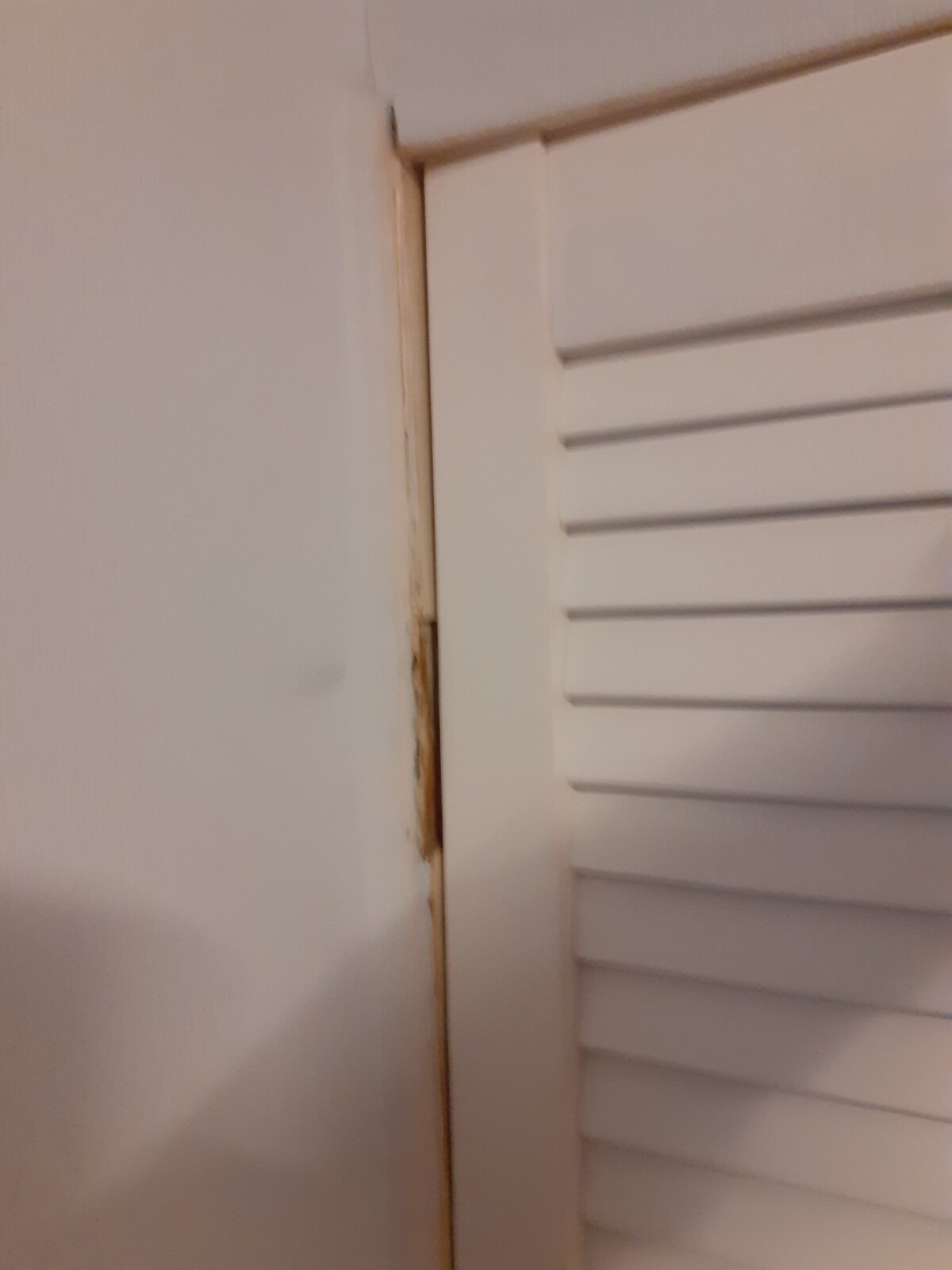

There was some binding on final inch of closing Louvre door with the flush hinges. I suspect should have plane a leaning edge on hinge side
