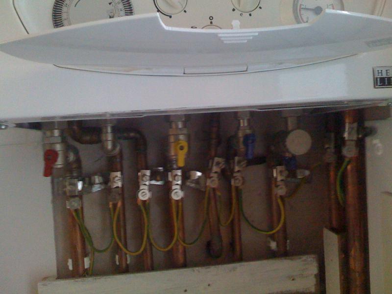

Hope you remebered the half-turn back to turn it OFF once the pressure was right!!!

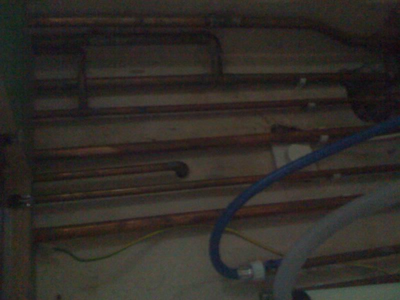

Also, there seems to be no check valve on the fill, to prevent back-flow from CH system into the cold main!. That's the main reason why there should be a 'proper' filling loop.

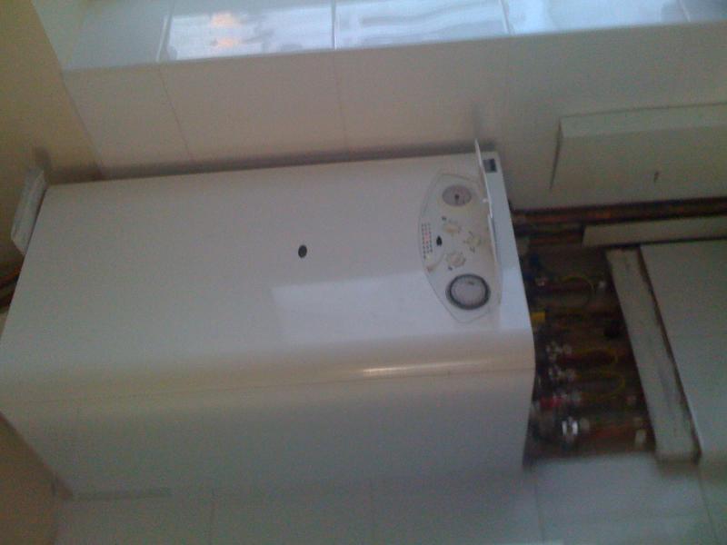

I bled the radiator in my bedroom this morning and now have no heating or hot water due to low pressure in the sytem. I understand that i have to locate the filling loop and re-fill the system, however i am unable to do this. Below are some pictures of what im looking at, please help me find the filling loop.
